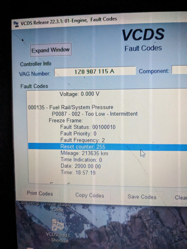

Was doing a bit of a cheeky overtake on the motorway on the way back, flooring it (in 5th I think?) and I got this this sort of judder/stutter. At the time I thought it was wheelspin as it was raining. But now I've checked VCDS and it seems at that very moment I got a low fuel pressure fault code  :scared:
What could it be?

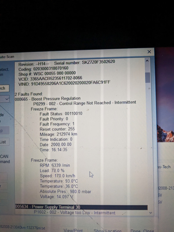

Not sure if relevant or not, but had this code come up while on the dyno getting mapped a couple days prior:
« Last Edit: November 21, 2023, 01:01:43 am by OllieVRS »

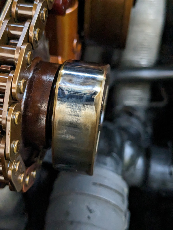

This is my old cam follower with 10,000 miles on it. Replaced it at the time (5000 miles ago).
And this is my cam. A bit scary looking but was running completely fine.

That cam has had it. The peaks are worn down and is why your follower looks like that after 10K. It's not critical at the moment but I would look into getting a new cam.
Is it an AXX engine? They're known for having chocolate intake cams.
« Last Edit: November 24, 2023, 10:09:10 pm by pudding »
