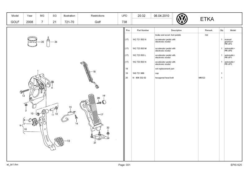

I have bought some aluminium pedals on ebay and i am collecting and paying for them tomorrow. I am sure i have read somewhere that the accelerator pedals have different part numbers depending whether they are manual or for a dsg car. Can someone tell me what the different part numbers are if they are different,as i don't what to buy a manual pedal for a dsg car.

I thought the only difference was the brake pedal?

From what i remember reading it was due to the dsg using kickdown on the accelerator. If only i could find where i read it.

They are different.  sorry the pic is a bit blurred.
My manual Ed30 pedal is shown below as top Number 17  part number 1K2 721 503 N.  DSG are different P\N's
