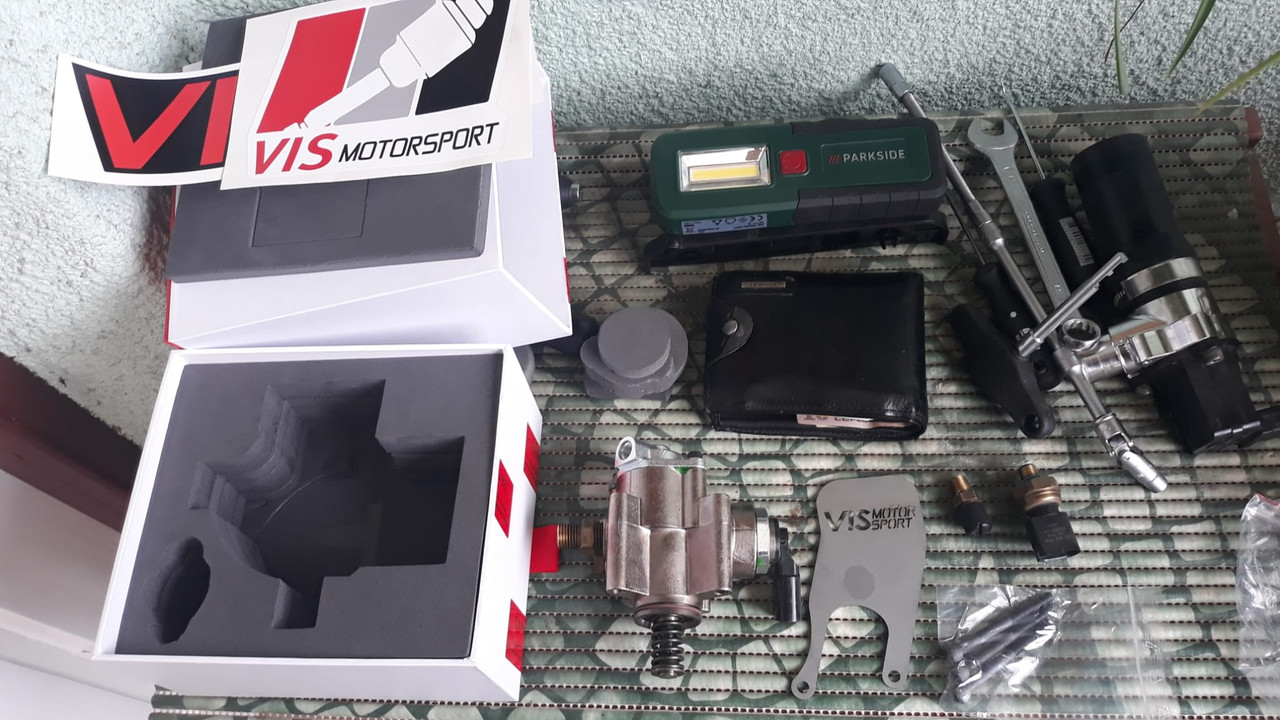

Also yesterday I sent my pump to a local shop, Vis Motorsport, to be completely cleaned and rebuilt with uprated parts for 175 bar fuel pressure. Today the shop messaged back that they rebuilt my pump but also wanted to let me know 2 very important things.

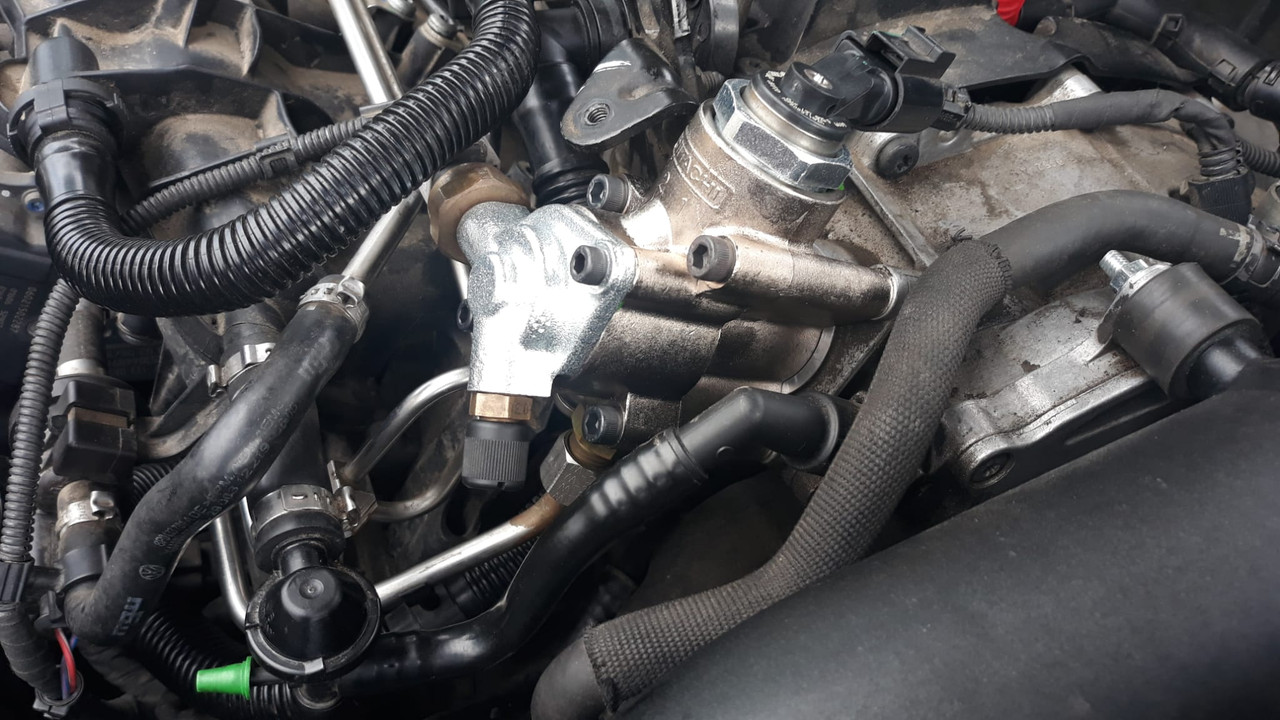

Two, the surprising bit, as I haven't seen this mentioned anywhere whatsoever. Apparently there are 2 generations of fuel feed lines that lead to the pump. The first generation which uses a banjo bolt and the second generation which uses a rubber hose to connect the metal fuel pipe to the HPFP. In both cases, there's a fuel limiter that limits the amount of fuel that can pass through, making your LPFP work way harder to feed your HPFP. He suggest drilling out this limiter hole to 5mm. This will help preserve your LPFP. He said either drill out the limiter hole or fit the newer generation fuel lines and drill out the limiter in the bit that comes screwed into the pump.
In the case of the older fuel lines with the banjo bolt, the restriction is in the form of a cast iron shield with a 1.71mm hole in it on the metal fuel line (pic 1). In the case of the later generation fuel lines with the rubber hose, it's mounted directly into the pump (pic 2).
I've asked him about the new generation cam follower retrofit kit, which ads a spacer to your pump and lets you use the newer roller based cam follower. He said this does more bad than good. It modifies the pump opening/closing times, which messes with the fuel pressure regulator ontop of the pump. He said simply keep the stock follower as that's what the engine was designed with and keep track of how much it's worn out.
Tomorrow I'll be fitting the rebuilt/uprated pump and also drilling my fuel limiter out. I'll go for a few pulls to see if anything changes and if stuff works now, I'll put back the aggressive fueling map to see if stuff finally works as it should. Afterwards, I'll be doing an engine flush and an oil change as I've been half a year on my current oil already.

Alright, over the last 3 days the HPFP arrived, I've drilled out the fuel line, fitted the pump and had my buddy install the aggressive tune. The car now requests and holds 130-135 bar pressure just fine, occasionally jumping to 140 bar. When it jumps to 140, I assume the release valve cracks open cause I lose power for a second or so, but this only happens at 5k rpm in 4th gear when doing a pull from standstill. Will most likely get this valve replaced with a higher pressure valve. Also I'll likely have to replace my LPFP as it's failing. It delivers a constant 4.5 bar pressure under load, but if I leave the car standing, in 2 hours it loses all rail pressure and the low pressure lines fill with air.
The pump was taken apart, cleaned, lubed, fitted with an uprated 175 bar piston and rod then assembled. All seals were replaced with new ones, everything tightened to spec and marked. The regulator, pressure sensor and bleeder valve are the old ones, gut cleaned electrostatically, along with the rest of the pump.
