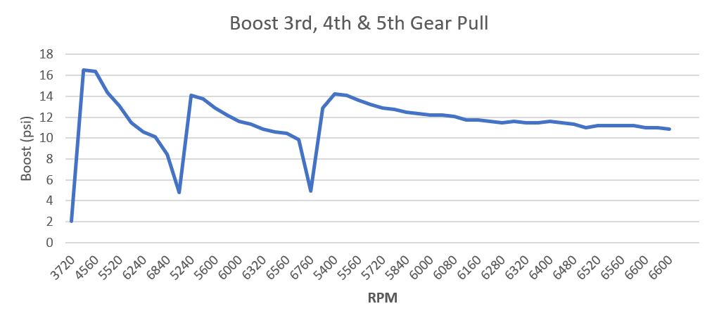

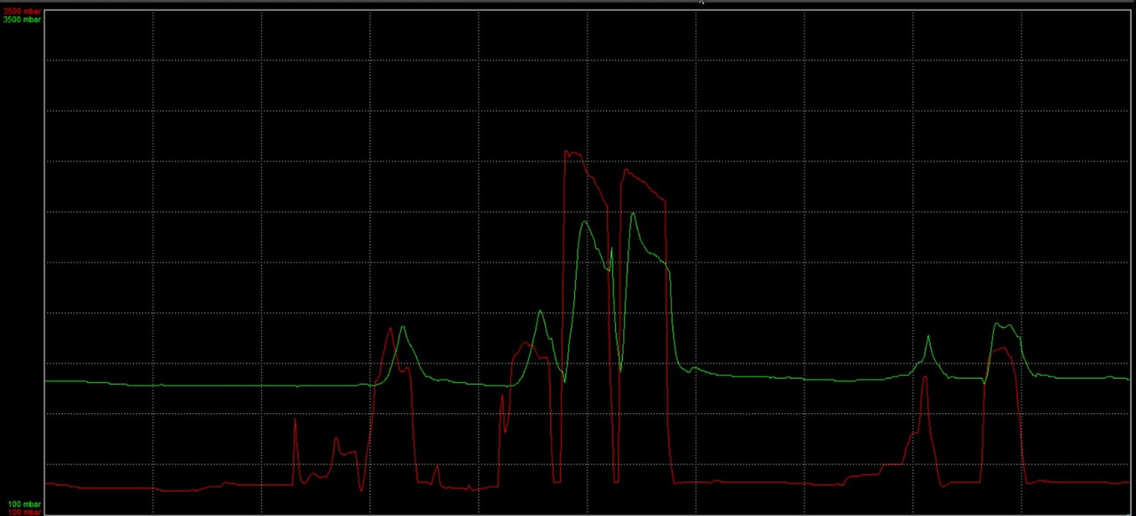

Below are some graphs of my boost issue with wastegate duty cycle at 95%. Red is requested, green is actual boost.

Not exactly sure how to read your graph, but if this helps, here's my boost (act.) VCDS log from stage 2, intake and 200cel:

And the graph I sent, that's basically me flooring it in 3rd and then switching to 4th on the highway. Here's an excel log if that helps with anything. 3rd to 4th pull down at the bottom.

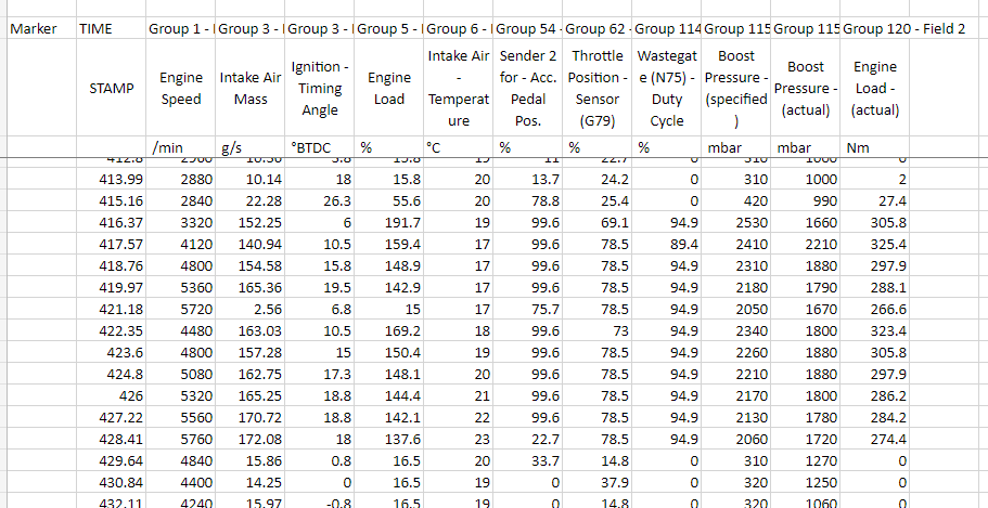

https://ubbcluj-my.sharepoint.com/:x:/g/personal/arpad_borbely_stud_ubbcluj_ro/EaMelNr8foZAu2jEjQj2aEUB0sWKGzvO_6McYF4RsmSlxQ?e=chQjX3
This log has less info but has timing
https://ubbcluj-my.sharepoint.com/:x:/g/personal/arpad_borbely_stud_ubbcluj_ro/ESgektv-s7hGrGPq-LW1OMQBbWmIgWbhIMS5MwsuXukIww?e=NpxG7f

Your boost does seem to be slightly too low from the requested boost, by a few hundred mbar. So there is definitely an issue with boost somewhere. Mine is at most -150mbar from requested when accelerating fully, usually +-50mbar.
Also remember that it's most useful to subtract ambient atmospheric pressure when talking about boost numbers, 1000mbar, e.g. my peak boost boost is 16 psi/1.1bar in my graph.
As for octane, I think mapping on that is equally at fault for the disappointing performance.

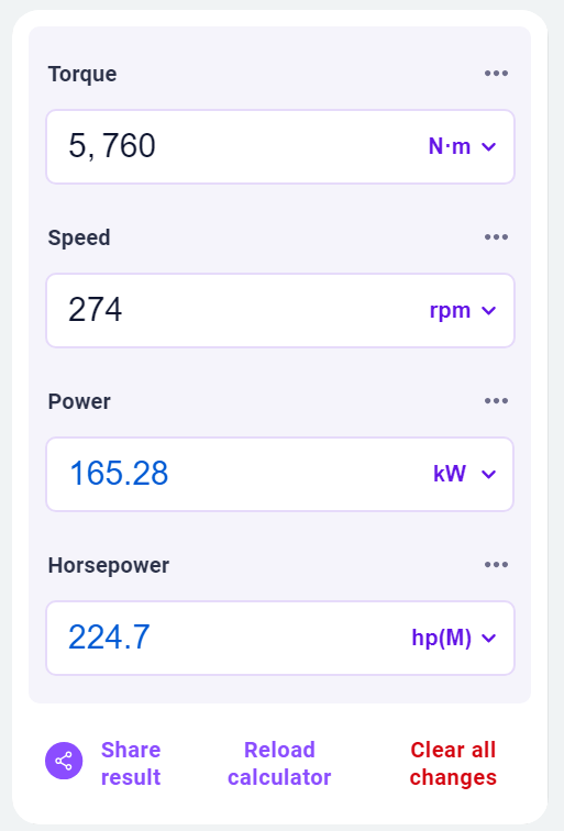

EDIT: Oops I put the values in the wrong way around, but it still calculates the same hp  :grin:
I'll use https://www.omnicalculator.com/conversion/torque-to-horsepower for a conversion to metric hp.
I took the values from the first log at 5760RPM and 274Nm, as I think they're the most reliable from your log:
Horsepower can also be estimated by multiplying the MAF g/s reading by 1.25, as the engine aims to burn 1.25g of fuel for every 1.0g of air taken in, creating 1 horsepower.
So at that same RPM point it's using 172g of air, 172*1.25 = 215hp. So your real hp number (I estimate) is somewhere around 215-225hp.
Your boost is definitely too low, that the first thing to investigate. Are there any engine error codes? But if you've smoke tested and replaced the DV there's only thing left it could be.
