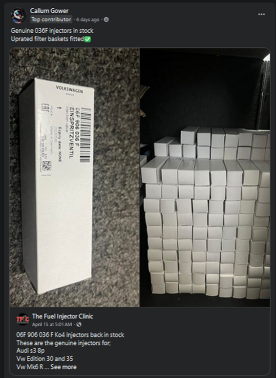

R-Tech just posted on their "TFSI Tuning" (facebook page) that they are stocked up.
