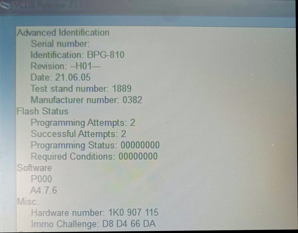

I changed my diverter valve today. I was getting a p0299 code coming up and researched that it could possible be that (my old one was horrendous!). Today i changed it and then when for a drive.  ---- The thing wheel spins all throughout the rev range in 2nd!! Even the sound is different! I mean wtf!! The difference is monsterous! I have vcds so i checked to see if the ECU has been flashed and this is what i got:
What could youse be able to tell me about this?

That it's been flashed twice.  With what is anyone's guess.  Could be a dealer update, could be a remap.  Not even VW can tell you what it is, only that the checksum is different to factory.
Log the boost pressures and see what the requested is. If it's much higher than stock, there's your answer.

Your car is stage 1/2 mapped. With a stock tune, there's close to no wheelspin. With a stage 1 tune AND a broken turbo, I was spinning all the way in 2nd gear. I could come off throttle then floor it again and it would spin again.

With VCDS, look at boost specified, boost actual, intake air mass g/s and actual torque. You can use intake air mass and torque to estimate BHP. Take the car for a pull in 3rd gear from 3k to 5.5-6k and you should get a good enough reading. Or if you can do the same in 4th gear, it's even better.
