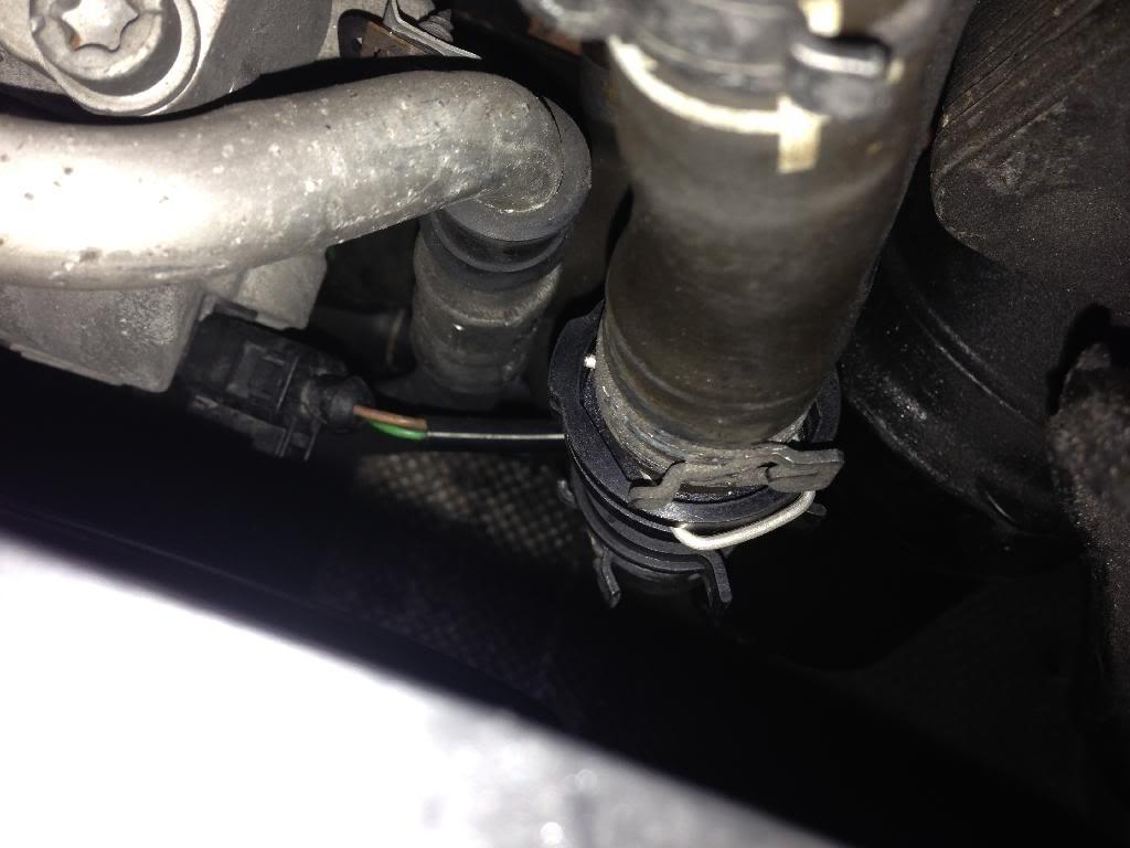

Offline mjmallia
  • -Receive: 60
  • Posts: 860
Re: new mk5 owner
« Reply #9 on: June 18, 2024, 08:08:46 am »
Change the inline thermostat to resolve the temp issue, as this is a common failure.  Just changed mine last week (3rd one in 7 years) as they seem to only last a couple if years for me and my short journeys.
It is located near the alternator and above the AC pump
Mike
South Coast

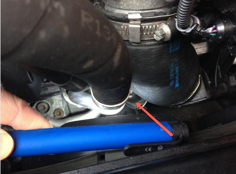

Offline mjmallia
  • -Receive: 60
  • Posts: 860
Re: new mk5 owner
« Reply #10 on: June 18, 2024, 08:10:39 am »
This thing:
Mike
South Coast

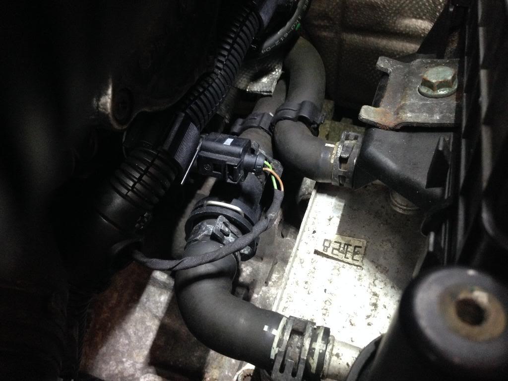

Offline mjmallia
  • -Receive: 60
  • Posts: 860
Re: new mk5 owner
« Reply #14 on: June 19, 2024, 08:47:14 am »
The GTI has 2 or 3 thermostats depending on year.
The main one on the block shown above they all have and then an inline one for the turbo near the TB and alternator.....DSG's can also have an additional inline one on top of the box under the temp sensor.
The one from the turbo is often overlooked and causes a lot of over cooling when it fails in an open state.
Turbo inline:
DSG inline location:
