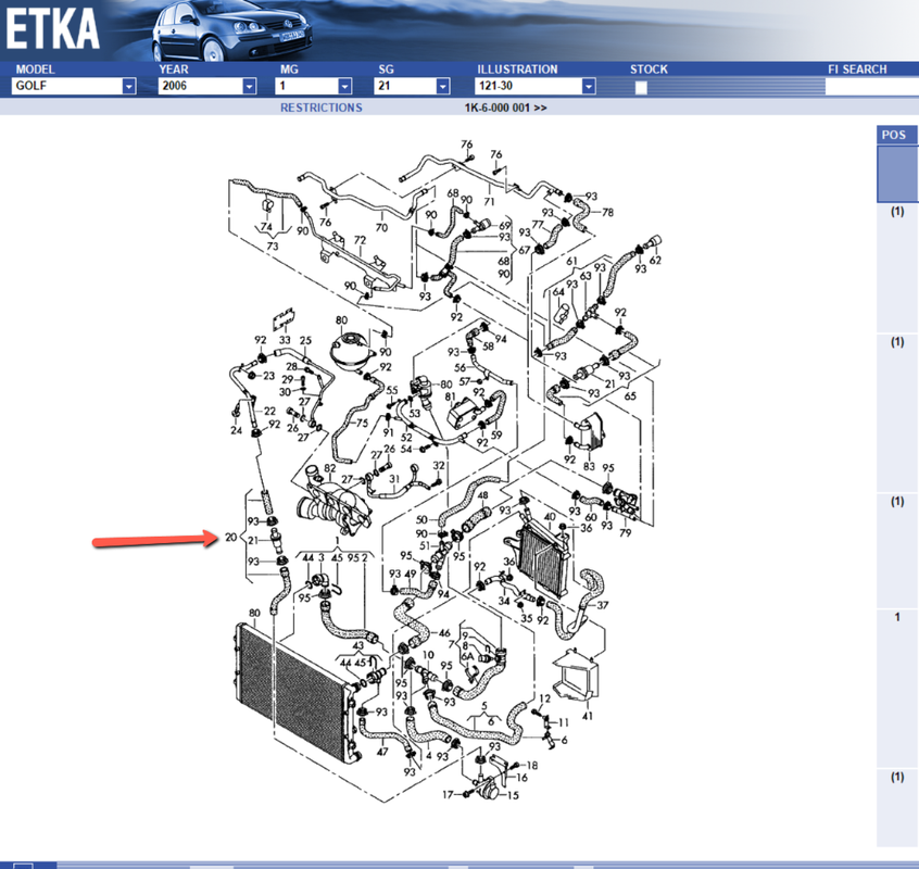

On my ETKA the GTI up to 2007 had the inline.  Below is a Golf BWA 2006.  The Octavia BWA 2006 has the later Golf 2008 layout weirdly
Near the end of the Mk5 GTI era 2008 it changed the plumbing

« Reply #20 on: June 20, 2024, 08:46:12 am »
Comparing the years  (ignore the additional cooler that was available hot hotter climates ) they simplified the system near the end, so you have given me a new project to replumb the car to the newer layout  :laugh:
It will get rid of the inline and stop me replacing it every couple of years  :smiley:
