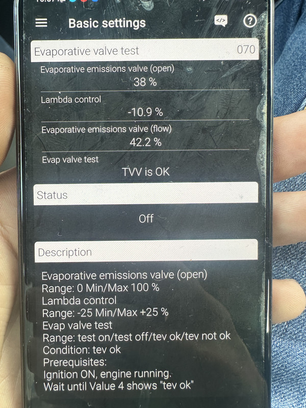

I did a smoke test hooking up the smoke machine on the intake. Haven’t had any leaks. Car goes well. The calipers are not sticking. What are the other possible causes? I have a new DV and PCV. I get an occasional p0441 code. Did a N80 test and got this

-11% fuel trim at idle is substantial.  Should be closer to zero.  What brand of MAF did you fit?  Aftermarket intake?

The -11 is at the n80 test on basic settings 70.
Not sure what does this mean on the picture.
The real values are up above from the channel 32.
