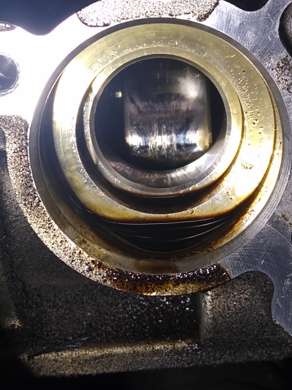

What a saga this cam follower has been for me. I found an INA one on eBay £20. It came in a padded envelope with a crumpled up and torn Schaeffler leaflet and no box. The CF had no markings on to indicate it was INA but I didn't know if they did anyway. I got in touch with the supplier they confirmed it was INA but I wasn't fully happy. So I then thought I won't bother with online unless I'm sure they're reputable, I then spoke to our parts supplier who couldn't get any even Febi was out of stock. Eventually he managed to get me one direct from Febi for £40. I then found another online supplier with INA and they sold stud conversion kits for the bolts on the hpfp. Which you could make yourself for a fraction of the price if you've got a vice, hacksaw, a tiny bit of skill and knowledge, but I'm lazy so I ordered both. The follower came in a little tub soaking in oil, so I didn't open it until I was doing the job. Upon opening I saw some markings inside the CF which looked like a QR code took a picture and carried on. The next day I looked at the picture which turned out to be a Febi logo. I got onto the supplier and he apologised said there was a mix up and would send me a replacement INA one but he has fitted loads of Febi and they're fine.
Also to add to my problems the cam had some light scoring and the oil when I removed the pump smelled a bit petroly and the oil that was inside the breather did also. I then went on a smelling mission, the inside of the pump didn't smell and the oil on the dipstick smelled a bit petroly but I wouldn't say it was more than it should smell but I might just be trying to convince myself all is well and I don't need a hpfp. Definitely need to monitor this. So all in all it's been a right pita.
