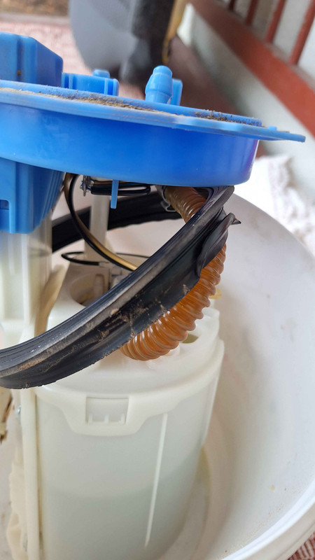

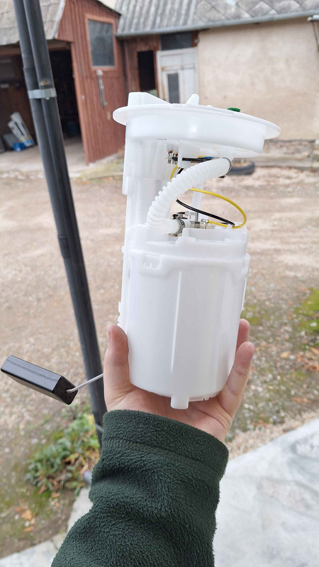

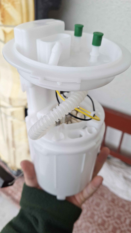

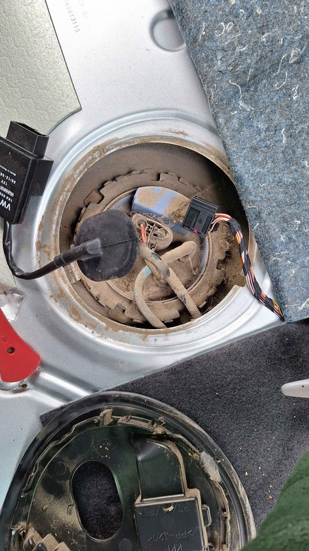

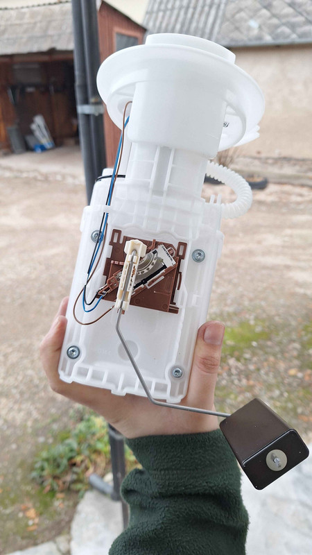

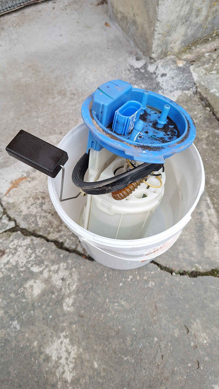

Replacing my low pressure fuel pump has been on my to-do list for a while now and 2 days ago I got the job done. I ordered a VDO pump based on Autodoc's compatibility result. VDO part number for this is 228235070001Z and it came with a black seal ring, 1J0919133B. Initially I also ordered a pump controller module but it was an aftermarket unit, not oem so I decided not to keep it. I may get a new controller sometime next year if I'll have nothing else to spend on. The difference between the new pump and old pump is that the old one has a blue top, the new one has a white top.
The inscription on the pump reads A2C53107628 and has the production date stamped in that says 2022.
The OEM rubber seal ring was pinched. I made sure to not pinch mine when replacing it. The pump was never changed as it still had the original seal tape on it that was so brittle it broke into pieces when I tried to cut it.
As for the result...
Changing the pump made no difference whatsoever. Everything is the same as it was before. Still rough-ish cold starts and air noises every time I open my door after letting the car sit for a few hours. Since it wasn't the pump, i'm moving on to the next step: injectors or my hpfp are leaking.
Around march next year, I'll be replacing my injectors with brand new OEM Mk6 R injectors so I can finish the K04 swap and remap for 340-350hp since I'm remapped for stock injectors now. If that still doesnt change anything, I'll be buying and upgrading a brand new Hitachi HPFP. If still nothing changes, then I wont try anything else since it's just the cold start, no other issues.

Worth a try and at least you now know that, that part is all working correctly.

Yeah, the pump was $100 so no regrets. I'll sell the old one for $40 and I at least know that I can rely on the new one when I push for more power.

Back with an update after driving the car for some time. Cold starts are better than they used to be but I'm still losing rail pressure when left overnight.
On the plus side, the water trickling sound that the rear of the car used to make after stopping, is no more. The old pump likely had a failed/failing one way valve so for $100, this was a great refresh/replacement.

Good work. It was quite noticeable for me when I changed the pump. The remaining leak will most probably be the injectors then.

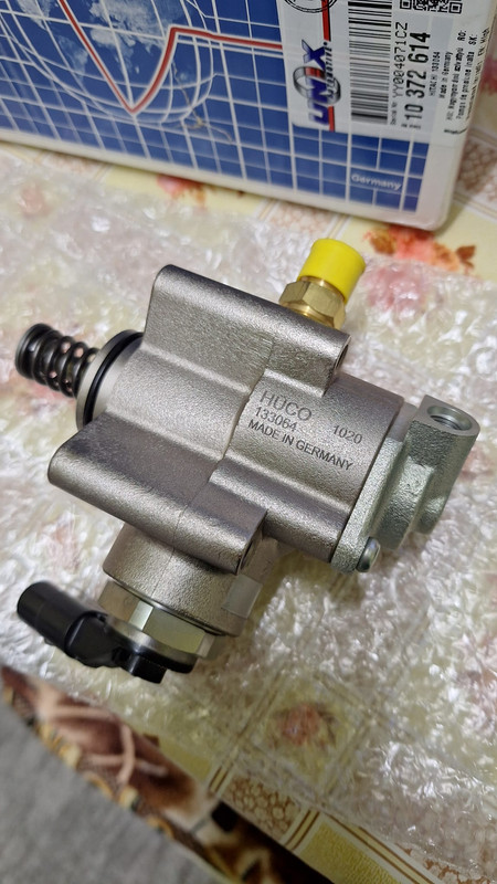

Update again. Replaced HPFP with a Hüco unit. It's basically a Hitachi pump but with the Hitachi name grinded off and assembled in germany. After moving over the uprated internals, the pump seems to be more noisy than the old one under load. Cam follower was replaced with an INA part. Old one wasn't really worn out but figured might as well do it.
Now the thing is, I cant tell if it's my pump that sounds different or if my turbo has developed enough play to make noise while under load.
Changing the pump changed absolutely nothing. Fuel is still draining out of the fuel rail after letting the car sit. I'm changing the injectors with brand new oem S3 ones and installing a new oem rs4 fprv before getting remapped. Hopefully this will sort my fuel leak issues.
« Last Edit: February 10, 2025, 09:11:57 pm by ZoliWorks »
