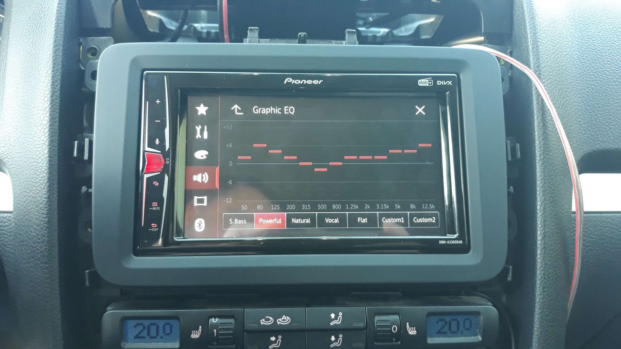

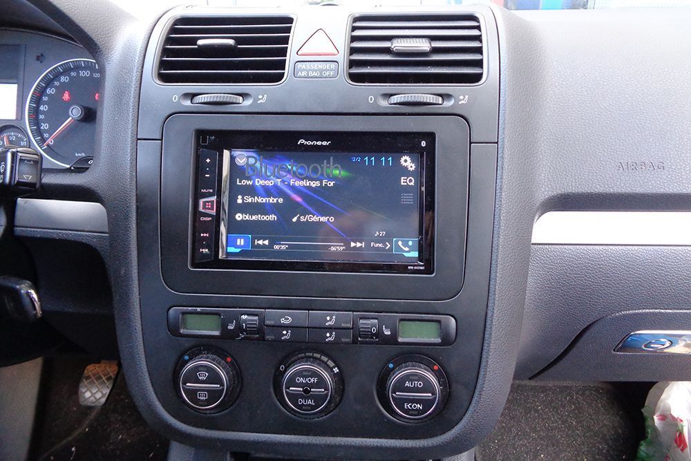

I went with a Pioneer unit in my old car. It had bluetooth, carplay, spotify and probably a lot more that I didn't care about. The sound quality was exceptional. It had a 13 band double equalizer and could make my stock 4 speakers sound as if I had an amp and 10 speakers. It was even better after I fitted hertz dieci fronts and 2 way rears. I still have the speakers but they are being ran on a standard rcd 500 cause I sold the player when I switched cars. It sounds awful. no bass, no depth whatsoever. That Pioneer unit was something magical, ngl. You could plug the car directly into it but at the same time it had exits for 2 subs and a bunch of speakers, along with video in and out.
I had to buy a frame for it separately but it fit right into the stock mk5 slot. Looked something like this but the navi itself wasn't as in as it is in the pic. It was slightly sticking out, by like 1-2mm
https://pioneer-car.eu/dmh-a3300dab/dmh-a3300dab
Safe to say if I'm going to buy another player, i'll buy a pioneer.

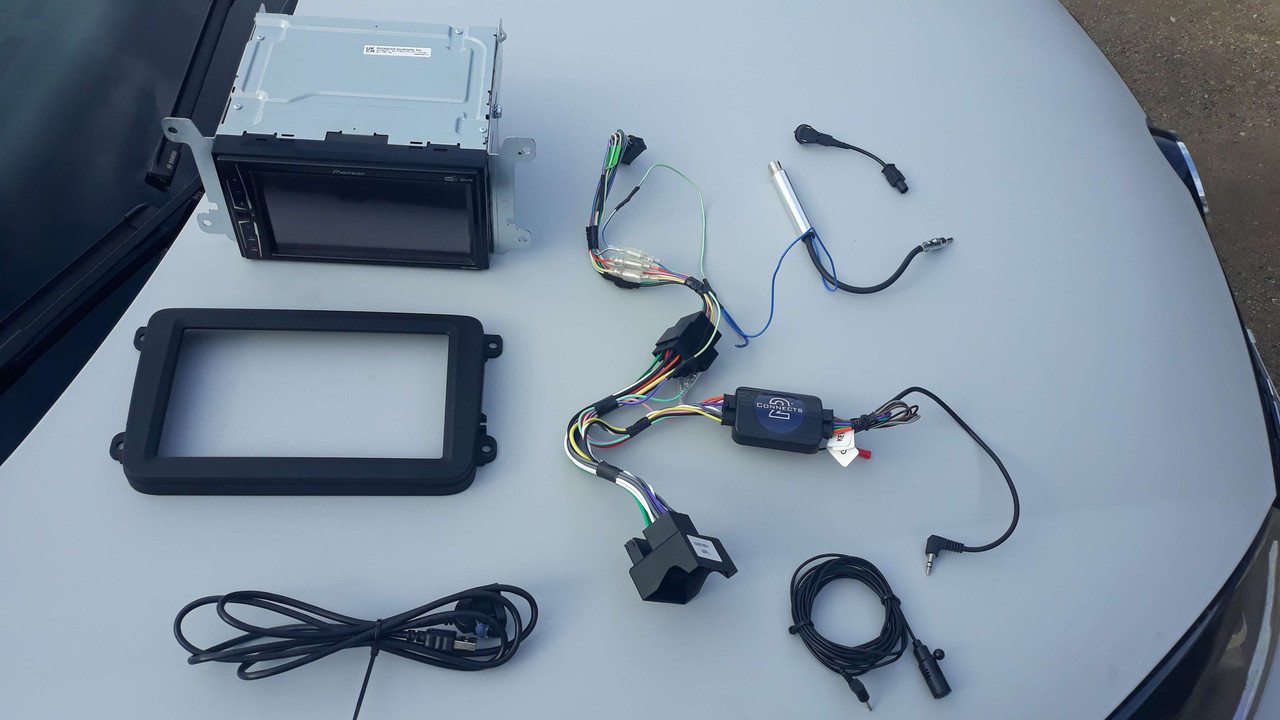

It was some cheap universal trim as far as i remember. I think you can get the complete kit online. with the trim plate, the box that holds the navi etc.
As for removing it, it's easy. The mesh vent thingy clips on without any screws so you can just pop it out. The one underneath has a screw in the far front center, right where the sunlight sensor cable is. Take the screw out and it pops out. Next you have 2 screws holding the center console vents. remove the screws and you can work it outwards. Start prying it from the back upwards and it should come out. the front plate that covers the navi and the AC controls has 2 screws that you can access after removing the vents in the previous step. Then it just pops out.
If you go with a pioneer, it'll likely need a module to read your steering wheel commands. I got a "connect2" or "connects2" module for $10. Just plugged it inbetween the navi and the car's harness and it worked.
I'll try booting up my old phone and post some pictures of when i sold it
