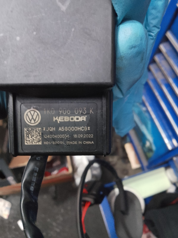

I priced up a fuel pump and controller from TPS, £270 for fuel pump and £160 for controller. I wasn't too happy with those prices so spoke to our usual parts supplier who's been in the trade for a very long time and is really good. I asked him to get prices on the best available aftermarket parts. He said VDO didn't supply aftermarket pumps. Bosch was £105 Hella was £100, and for controllers Pierburg £95 or Intermotor £90. I was going to go with Bosch and Pierburg but I asked him what he would go for and he said Hella and Intermotor so I went with those.
The Intermotor controller is actually a VW part so that's good but the Hella fuel pump didn't feel as good as the original.
I now hear the fuel pump buzz when I open the driver's door which I'd never heard before, and normal driving at below 3000 rpm seems slightly smoother and more responsive, I'm wondering if that's just in my mind though, no difference at high rpm. I just need to go on a few long runs to see if the drop in power is fixed.
Old parts are the bottom pictures
The new controller had little black stickers over the VW mark and the Keboda mark.
