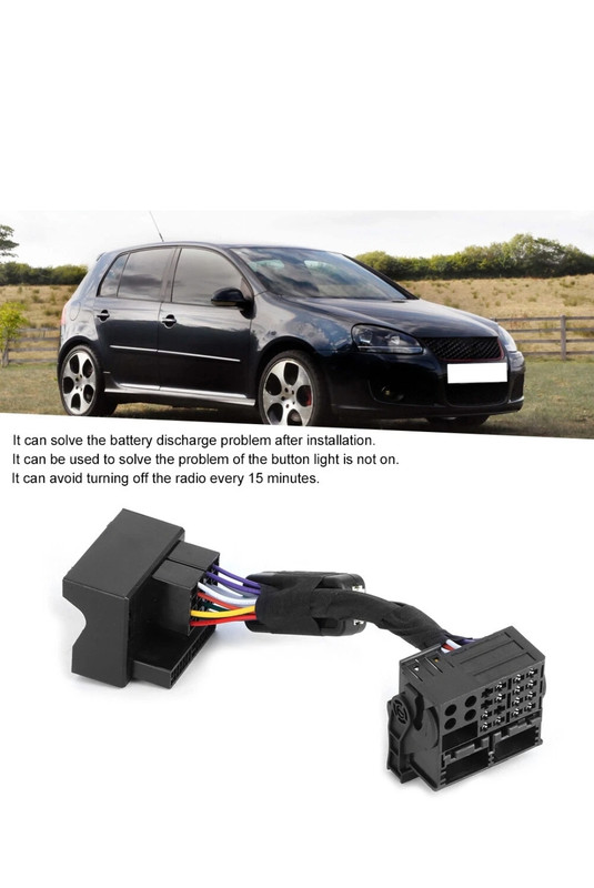

2007 Car with the wrong canbus = battery drain, which i simply took a chance on an ebay adapter. Which worked a treat no more battery drain and even gives me radio controls via stalk(Well changing stations) here is the ebay link = https://ebay.us/m/EEBr6u

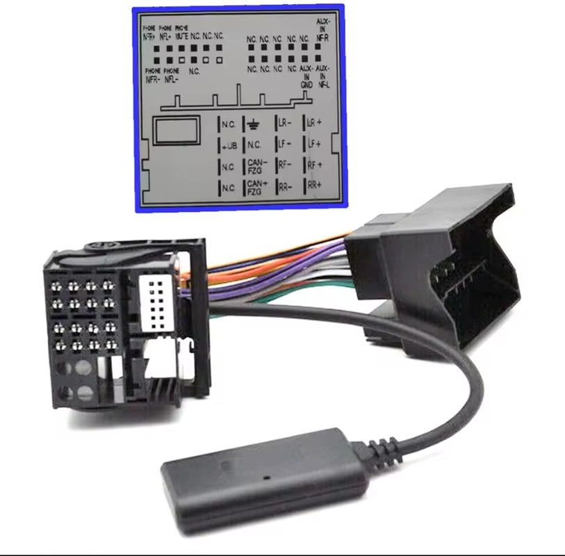

I also added Bluetooth with a harness good old aliexpress(would put the link, though like most guides etc.. Links and pictures have dissappeared).
I also added GPS again from Aliexpress(sorry links disappeared). Mounted under vent sat on top of flap. Which works ok most times, but has a problem with lots of trees and highly built up areas.
I now use both the above harnesses plugged into each other giving me Bluetooth and GPS.
