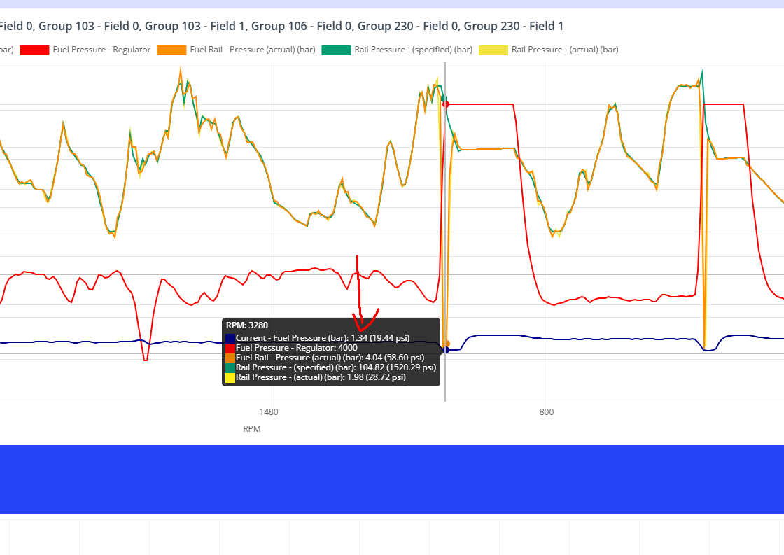

Ive got a 2008 Gti mk5 stage 1 with fuel pressure problems.
On hard pulls it jerks and in the VCDS logs the pressure drops from 110 bar to 7(with the new HPFP, the old one went up to 129 bar and dropped)
A local company loaned me a HPFP which is swapped but didnt solve the problem.
Fuel filter swapped last year.
The cam follower is also new, doublechecked and its in pristine condition.
There are no leaks from what i can see, atleast around the visible fuel rails and HPFP.
So whats left is the in tank pump and im pulling it out today but i dont know what to look for  :scared:
Could there be anything else causing this problem or can i just swap out the in tank pump and the problem should be solved ?
Can the in tank be repaired ?
Is a 4 bar pump enough?

Here are the logs:
https://log.tunezilla.com/s/bbQzxooI
I'm doing tests on the n80 today and checking if the charcoal canister is clogged because there is a hiss when opening the fuel cap.
How do I test the controller on the fuel tank lid?

Holy, yeah look at your low-pressure side, that's basically dead. I'd say in-tank pump, controller or maybe the filter but unlikely. Your low pressure side is basically starving your engine completely. It should never really drop under 4.5 bar on full WOT.
Try logging the in-tank pump duty cycle as well. I forgot the exact VCDS param for it. Auxiliary fuel pump or electric fuel pump? something like that.
If you're going to replace it, there are a few threads here with people and the pumps they used.

For some reason your low pressure side is still dropping. Are you using a 6.6 bar filter? I'd swap back to your own hpfp and check if the issue is still there. I dont think stage 1 would have any demand for more than 130 bar and even that is unneeded.
I've had issues with fuel pressure demand on my side cause of 2 things: Non-upgraded hpfp and stock fuel pressure release valve. The hpfp would cut out between 3k and 5k and pressure would dip because it could not move enough fuel volume for what the tune was demanding. Stock valve also opens at around 128 bars since these engines run on 120 bar stock. You need an RS4 valve which opens at a higher pressure, but I forgot exactly how much.
However, I dont think your issues are related to the valve but we'll see. Try your old pump, the one that was working fine and see what it does. If it works up to 130 bars, try the FPRV. You can get them new from the dealer for about 100 euros or buy it off of some marketplace group for half. You dont need to remove your intake when changing this.
