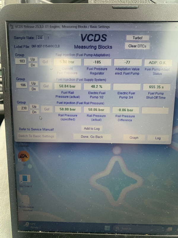

VCDS Arrived. Getting misfires across all cylinders, mainly 3/4. Still P2293. Checking measuring blocks it seems my fuel rail pressure drops massively from 50 to 5 bar when I give the car any throttle. Could my replacement injector be the cause of this? Changing it again might be the best option I think.
Offline xcb789
  • Posts: 9
Seems once the car has adjusted after being started then the difference in rail pressure only is 1-2bar from requested but when first started after a reset any throttle and it’s 45bar difference. Im reading this could be the pressure sensor, HPFP or maybe my replacement injector. Which is more likely?
