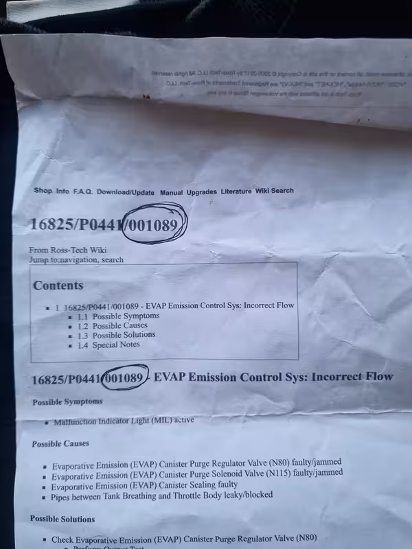

Still got an EML on.
I have changed the charcoal canister and the n80 evap purge valve.
No obvious leaks, car runs perfectly normal.
Any advice would be much appreciated.

Tried a fuel cap seal?

I haven't mate no, is that a potential fix? I'll give it ago, thank you for the reply

I have seen R Tech mention it on their Facebook posts in the past.
