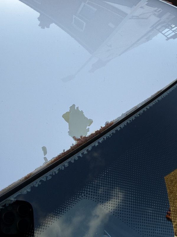

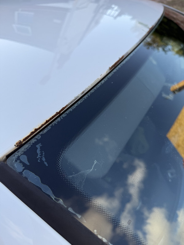

Cheers Zoli some good advice there, especially about the injectors. Also I’ve already done pads all round so one less thing to worry about. This is the state of the paint above the windscreen, be interested to know your thoughts after seeing it lol.
Do you know which layer the patch on the second pic is? I have got some touch up paint but unsure if I can go straight on top of it?
As you can see it’s bad, which is a shame because the rest of the car has no rust at all, being a Japan import it’s very clean underneath too.

Yeah thats a lot more rust than i thought, but it looks like surface rust so it's easy to repair. Tho there's going to be a lot more underneath, which isnt visible right now. My advice to you is, given that it's an old car (mk5's are old lol), strip the windshield, take it to a shop to have them repair the rust entirely and have them paint the top then get a new windshield. Sunburns, scratched windshields are mad annoying to drive with in rain or at night. Replacing my old windshield was one of the best mods I have done to my car, no joke.
The layer underneath your paint is likely the base coat/primer. Given that you basically have a chunk of both paint and clearcoat missing, spotless repair will be quite hard. You'd have to sand down the entire roof all the way from the front to the rear, patch the rusted area, sand down all imperfections to get a flat surface and then re paint and clearcoat the whole thing. Or repair the rust, patch the missing paint spot, sand it all down and wrap the roof. That's going to be cheaper but for that complete oem look you'll wanna take it to a profi paint/body shop and have them do it.
Speaking from experience from being around many different mechanics and painters, seeing them how they work on other cars and what kinda stunts they pull, dont cheap out on bodywork and paint. There's a night and day difference between a back alley jack of all trades guy and someone who specializes in bodywork and paint.
EDIT: just went through and re read the original post and my reply. Yeah I was expecting you to have some rust in the groove where the windscreen sits, not outside of it. And that windscreen looks battered and worn out af, so best bet? get rid of it, get the bodywork and paint done then install a new one.

Cheers, I knew it was bad but just wanted to see if it was possible to somehow sand it myself and touch up etc instead of what will be a lot of money to repaint the whole roof, I don’t care as long as it looks ok from 10 feet away. To be honest there’s 0 chance I will spend out on a full re paint so just trying to minimise it best I can.

I mean hey, nobody is stopping you from giving it a try :p
When doing the windscreen, get it removed, do the bodywork yourself with some spray can and clearcoat and then it'll be whatever it'll be. It's best to do it with the glass removed so you get access to any spots covered by it.

Thanks for the advice. I got a price and to respray the roof it’s £250, plus £100 to remove/refit the windscreen. Another approx £200 if the windscreen can’t be refitted. Going to have a think about it. I reckon to get the car how I want it I will end up spending the cars worth (£2500). But then to get into a decent mk7 it will be more like 10k plus my car  :thinking:
