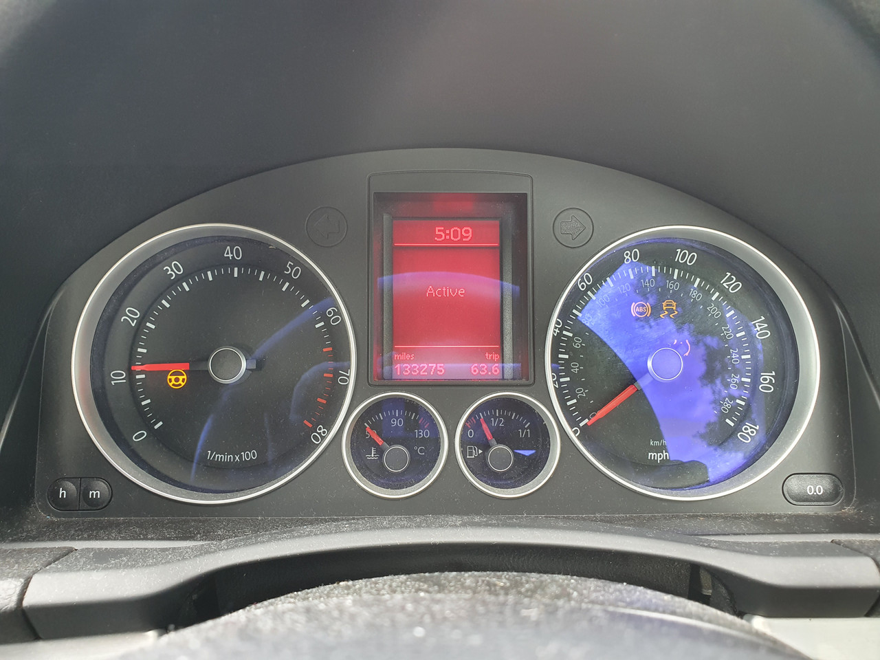

Hi,
I did all the mot work and took it back.
There were no dashboard lamps on previously,  but to do the work the battery was disconnected.
So when it went back there were new dashboard warning lights Mr.motman was furious.
Anyway I spent a fortune so far, the car won't be sold on ever,just need the lamps out.
Are the dashboard fault lamps LED or other?
Does the dual section need to be removed?
Is there a fuse that can be pulled?
(Before denigrating this the car drives fine and will be scrapped in the near future)!!!
Pps is there a definitive way of deciding whether the steering angle sensors are in rack
Or column pls?

I'm pretty sure I read somewhere that if you disconnect the battery and have some warning lights afterwards you simply just need to drive it and use it normally and it will calibrate the sensors and the lights will go out.  Try that before anything else

Yes, if battery has been disconnected steering full lock in both directions and hold for a couple of seconds in each lock stop. Also a short drive in a straight line. Although if there's any faults on the ABS such as rear sensors then the lights will not clear.

Mmm tried the lock to lock a few times.
Braking and turning the same time.
Driving in circles.
Last time battery disconnected it did learn. After 60 miles. On a straight bit of road.
This time on over 100 miles.no joy.
Grrrr....
Need an alternative way to put light out , permanently and   ideally not removing the dial binnacle or gaffer tape. Any way possible legit  or not.

Code G85
No communication from steering sensor.
Will not clear.
The Old VW Favourite.
Amber steering light not red.
Abs speed sensors ok even the back ones sadly  , I could do that but not miracles.

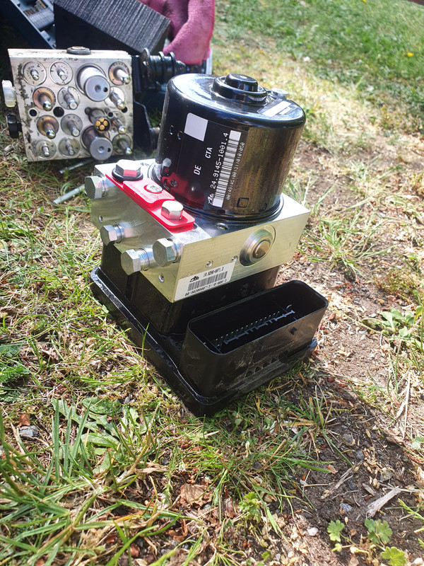

Online rxpx69
  • Posts: 34
Re: Mot nightmare of the decade...
« Reply #8 on: December 07, 2025, 11:28:07 pm »
Amber steering light should go out after 20-30 seconds, all the way left all the way right, steering wheel straight and drive a couple of meters in a straight line no more than 20MPH.
I had an issue when my ABS pump needed to be replaced the ESP light was stuck on amber yellow and after disconnecting the battery no matter what I tried the amber steering light would not clear! Maybe the same is happening to you if the ESP light is stuck on?
On MK5 all racks are gen1 or 2 unless upgraded to MK6 and the steering angle sensor is behind the steering wheel and have 4 bolts attaching the steering rack to the subframe, in gen 3 the steering racks steering angle sensor is in the rack and has only 3 bolts holding it to the subframe.

Online rxpx69
  • Posts: 34
« Reply #11 on: Today at 08:40:07 pm »
Yeah if your ESP light and ABS lights are on change the ABS pump (swap over the electrical module) and it'll cure you're issue with the sterring light after a 20 second drive. Happened to me and was very annoying as it happened a week after i bought the car used and was playing with the ESP button lol. But that fixed it the steering light after the battery was disconnect issue and has been fine since 2022.
Forgot to mention - No coding required
