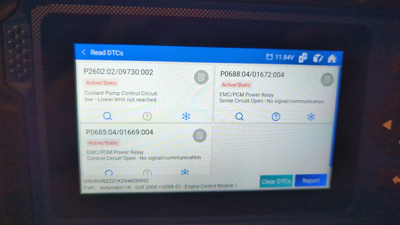

I am chasing down a crank no start on my MK5 GTi AXX engine
I have pulled the relay from another car and confirmed that this did not fix the issue
I am now at the point of possibly chasing a broken wire, But I dont really know what wire I am chasing
I have the ECU out and all the wires for the ECU unclipped so im ready to do some testing but I dont know where to start
I see the loom has been opened at some point (under the batter tray, Next to the ABS pump where the loom splits and goes into car and into engine bay coming from the ECU)
Any advice?
