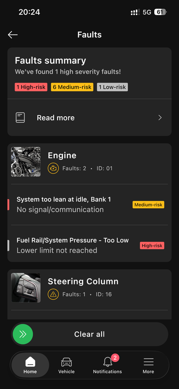

I am still getting the following codes, low power and low fuel pressure at wide open throttle after 3k rpm. Drops to about 60psi
System too lean at idle bank 1 - No signal/communication P2187
Fuel rail/system pressure too low - lower limit not reached P0087
