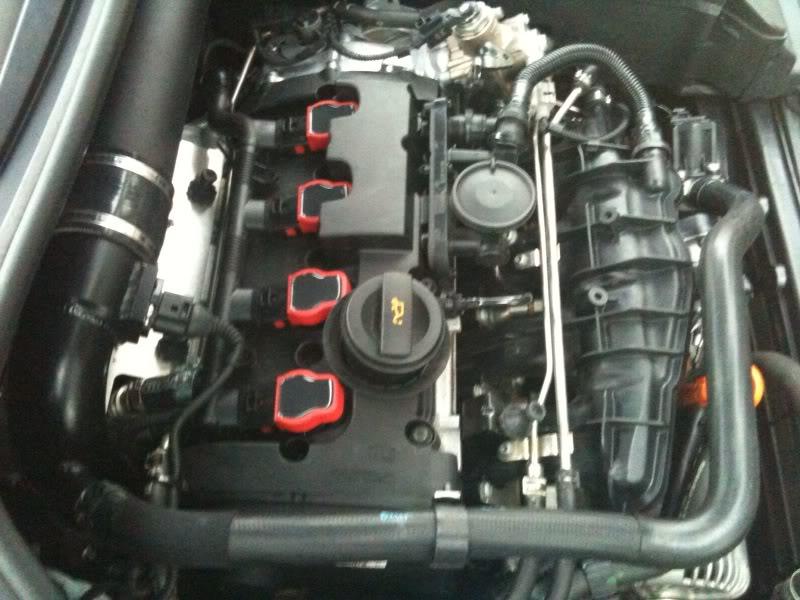

I managed to get 50k before one let go. I then got a nice set of RS4 ones from the USA ( same but has a nice red touch to them) even delivered they cost half price than from a dealer. :scared:
Thats good to know, cheers.  Direct fit?  No more reliable i guess, just easthetics?

« Reply #7 on: April 13, 2010, 05:13:32 pm »
They look identicle to the normal ones just for colour. Not sure about reliabilty, has anyone heard of RS4 owners with coil pack probs? They might be better.
