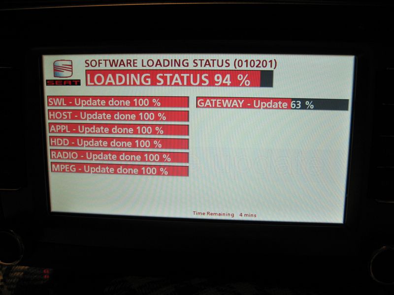

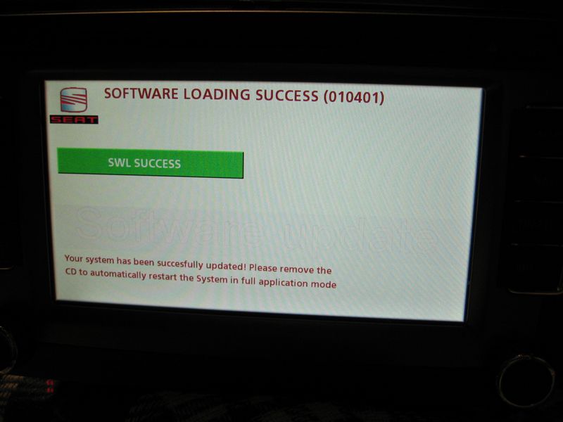

I'd already installed the new wiring harness last weekend, but need to run a software update on the MFD3 to get things working properly :)
Took around 50 mins

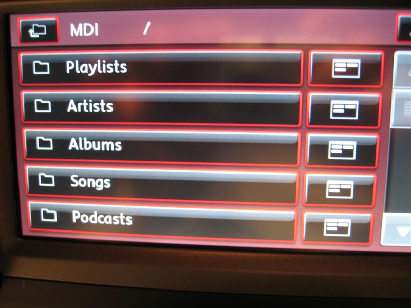

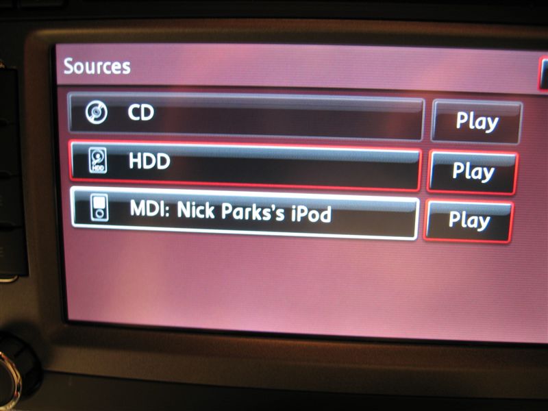

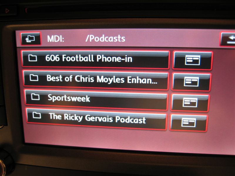

Now my ipod appears on the MFD3
Fully browsable
Software upgrade gives the unit some nice new touches too - easily able to check hard disk space on the unit etc :)

nice upgrade, how new is that update ?
Offline NickP
  • Posts: 10
Re: Media In MDI Install
« Reply #2 on: January 10, 2009, 07:31:39 pm »
It's 1022 (which is 1020 for VW) so I guess thats what your already running?
