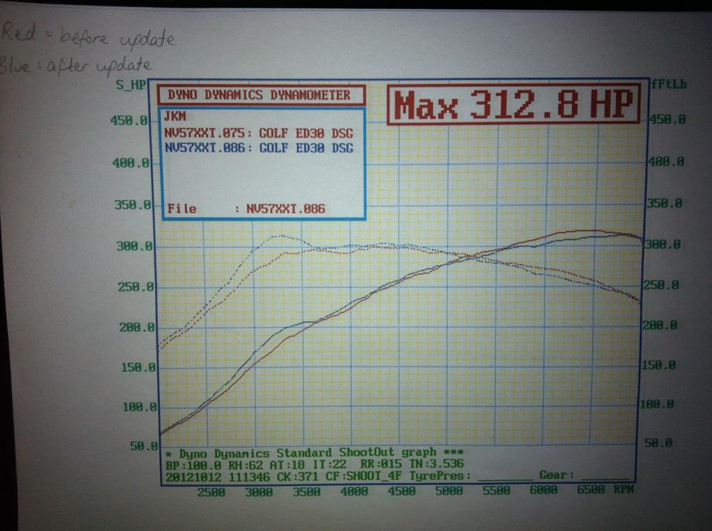

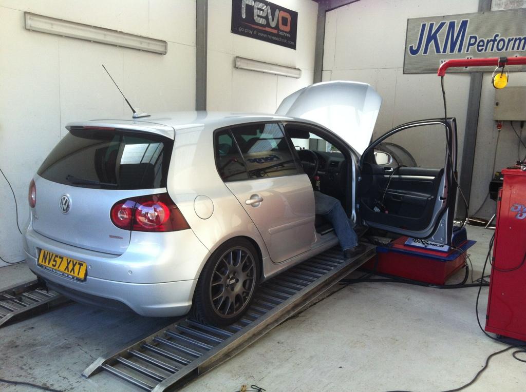

I went to JKM today to have the Revo software update (Stage 2). There wasn't anything wrong with the old map but I thought I might aswell go for the update as I wanted to try the linear throttle map too...
I had a power run before the update and another one after the update. It made 6.2hp less after but I'm not too worried about that, I doubt I'd notice that on the road anyway. I'm really glad I chose the linear throttle map, feels like I am in control of the power delivery a lot more compared to before, definitely feels more progressive.
Settings went from B6 T3 F8 to B8 T3 F8. Jim said he could've probably upped the boost to 9 but suggested B8 is fine.
