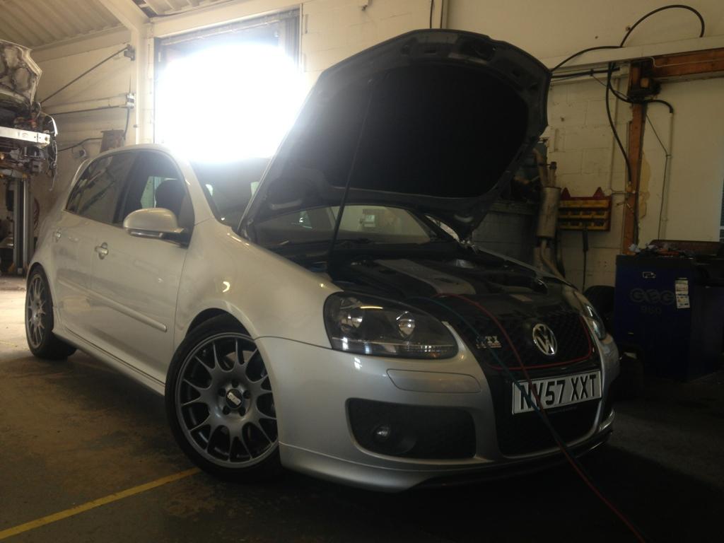

I have had to spend a few £££'s on the car recently...
Aircon re-gas, never had this done before so thought I'd better do it:
I have been driving a Polo courtesy car for over a week whilst my car has been in the garage. Nice little car, great sunroof but I don't like the DSG, needs a DSG remap lol.
So finally my DSG issues have been resolved, firstly a new mechatronics unit was fitted, didn't cure the noisy downshift, then new clutch packs fitted and DSG is now running very well.  :smiley:
