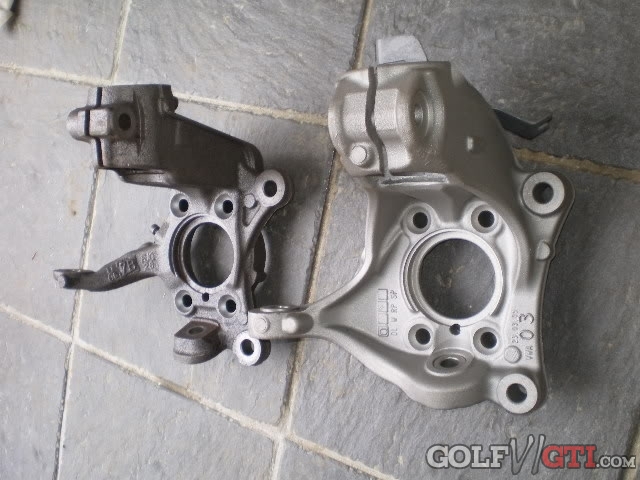

Well the calipers are ordered and should be here tomorrow, lets see how they cope with with a bit heavier front end?? Althought i have the S3 hubs and wishbones so lighter already?
Bring on the fitting kit, then maybe some track action baby see what this soot chucker can do.
Darren
Glad you told me you've got the S3 hubs....different bracket altogether!!!
Darren
Will that be a problem Dave or is it just a matter of fabing? hope Ive not caused any inconvenience?
Darren

I think the adapter is made of a different material to avoid the steel fusing to the alloy S3 hubs or something along those lines so its same size and shape just a different material.

The adapter for the S3 hub is different to the one for the GTI hub. The difference is 16mm, where the brakes are fitted.

And yes, the S3 alloy hubs are much 'bulkier' than the steel hubs. So longer
bolts and a different shaped mounting bracket are required.

Wow I didn't realise the difference was that big :surprised: the steel ones are massively heavier but so much smaller :scared:
Will wait for the brake god to sort them out then cheers for the input from every one, hopefully we'll see what the difference is cant wait :jumpmove:.

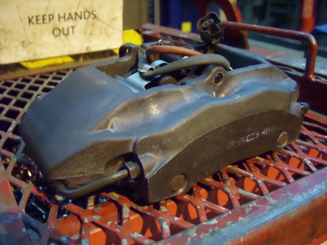

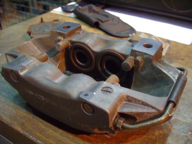

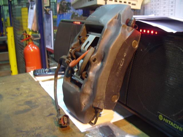

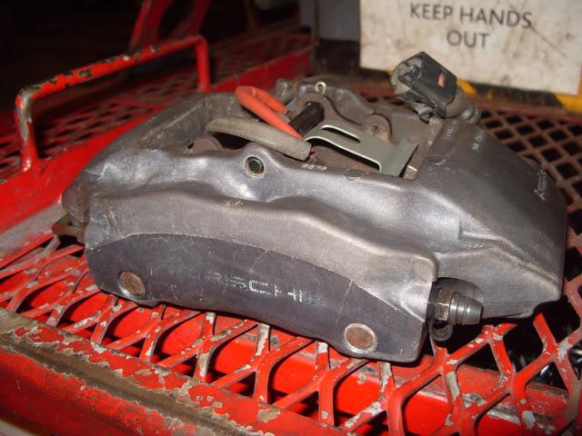

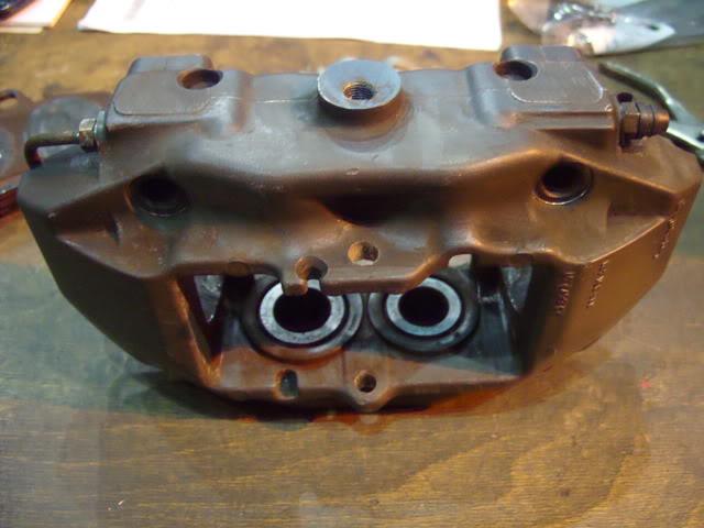

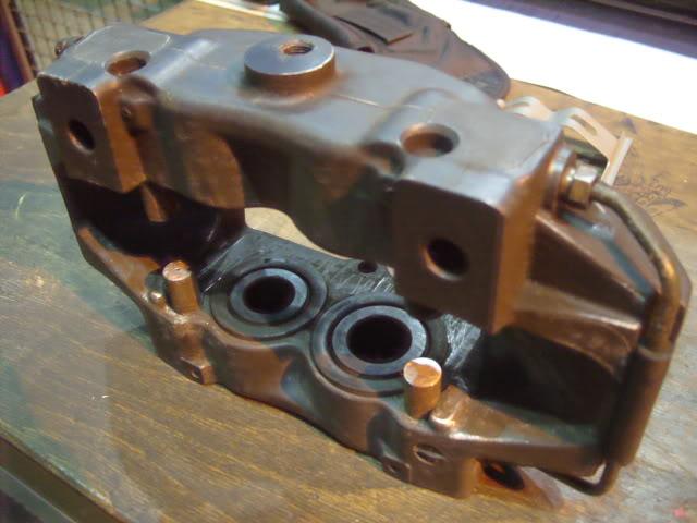

Right Dave asked me to put these pics up has he wanted to show how the bridge pipe was transfered across between calipers.
First one is of a nice caliper built up with a newly spliced brake warning loom notice the proper VW plug
This is a passenger side caliper with the bridge pipe at the bottom and the bleed nipples at the top and also the leading smaller piston, the bridge pipe WILL NOT just swap from top to bottom it needs to be swapped from the left caliper to the right caliper and top to bottom its the way the pipe bends.
I hope that helps any one fitting this excellent kit :happy2:
Dave I need a new small piston seal I managed to catch it while grinding the pegs down :confused:
