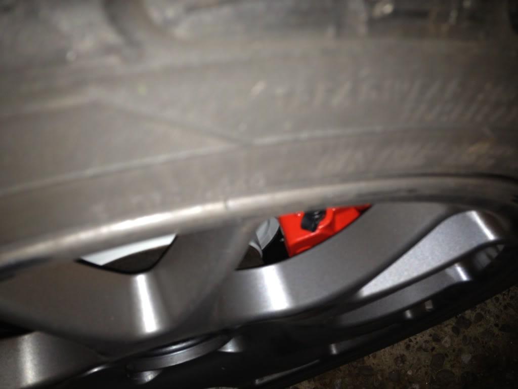

« Reply #524 on: January 07, 2012, 05:04:10 pm »
:ashamed:
the clearance isn't AMAZING considering that i've got 8J ET44 wheels  :confused:
