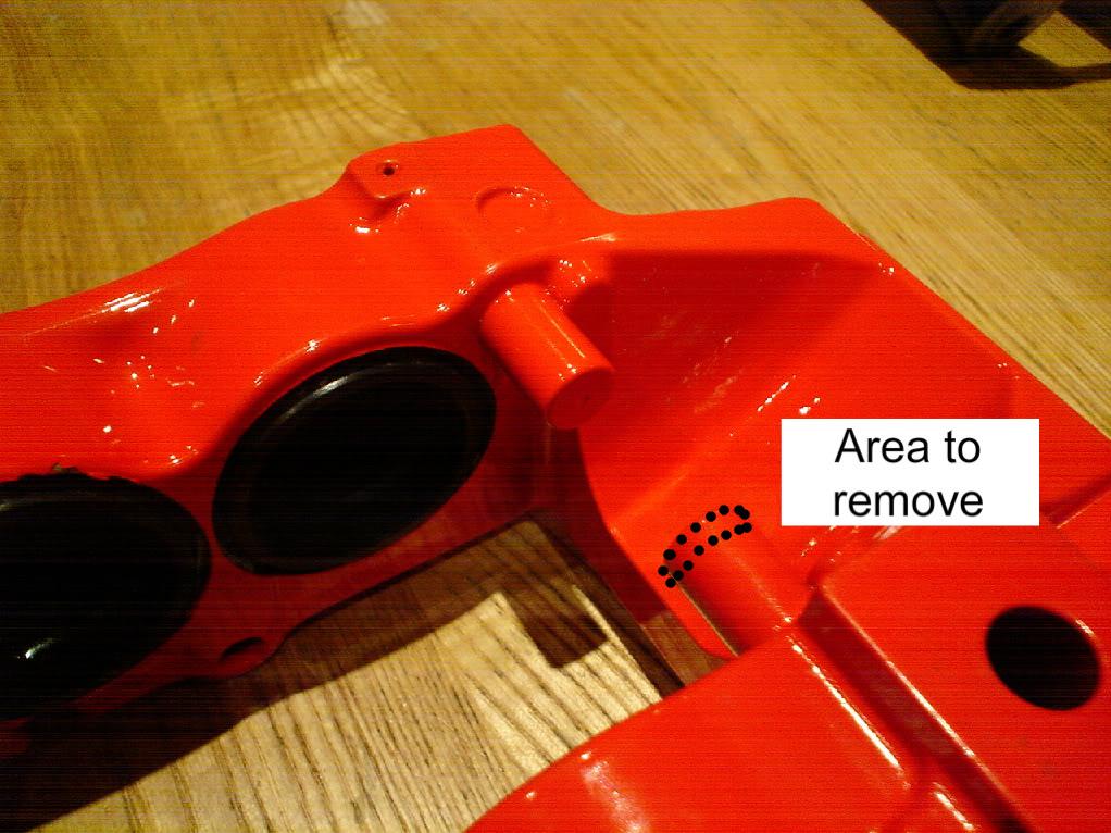

Its looking promising for these  calipers, couple of installation issues which are far from insurmountable, which are not "engineeroutable" more to do with the differences in production of the caliper.

Well simply put the discs on a boxster are 24mm wide and we're using a 25mm disc so the gap between the pad pegs and the disc is fairly tight, its not a problem and we can engineer a bracket to position the disc centrally but its not interchangeable between calipers because not all calipers are the same.
Add to that a bit of track heat and its too close for comfort.
The simple answer which we achieved with Joes brakes was simply using a dremel tool remove approximately 1mm of material from the ends of the pad pegs, this gave us loads of clearance and the clearance issue didn't rear its head even after Joes best efforts in shermany.

does that mean that every time you change pads, you would need to dremel some material of the backing plate of the pads

No the pad pegs are on the caliper give me 2 mins I'll put a pic up, do it once on install and forget about it.

Its a case of removing some of the pad peg - not as much as I've shown here ....straightforward really

« Reply #79 on: May 18, 2010, 09:21:21 pm »
thats not to bad then
alot of the actual peg end is just excess powdercoat.
