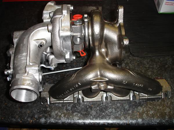

« Reply #46 on: May 08, 2010, 04:30:24 pm »
Porsche KKK i believe.
The Owen Developments turbo is a hybrid K04, so not a direct bolt on for K03 i believe.
We're hoping to put a K04 wheel on a K03 and cut back the turbine etc.
Doing this means no relocation or anything needed etc but all still in the ideas stage at the moment.

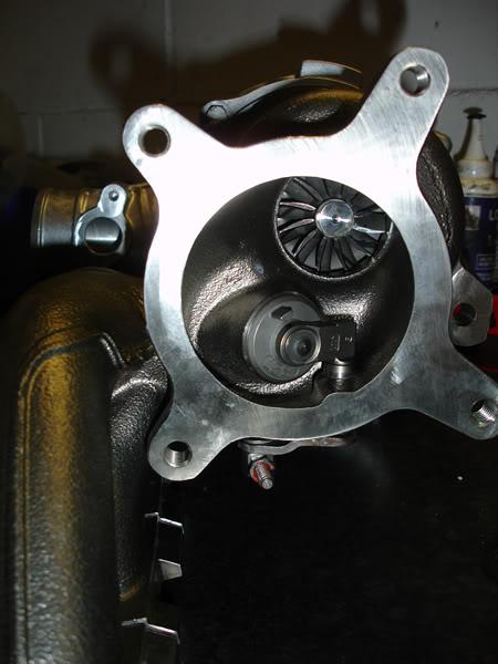

Anyway, got the turbo back on friday  :smiley:
In this pic you can see the cutback on the turbine blades

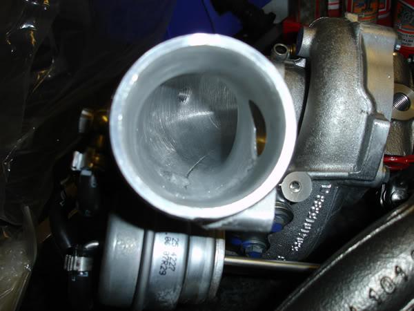

Wile it was off we smoothed the intake and opened it out to the new compressor wheel size, this is something we will be offering out if anyone would like it done.

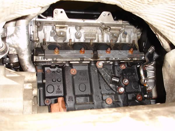

The back of the engine with no turbo attached  :laugh:
I fitted the RS4 Pressure regulator while i was doing the turbo... what a pain in the arse!!! I think it took longer to do this than it did to re fit the turbo!
So annoying as you can see it fine, but getting to it to undo it is another matter!
Got it all on anyway after mucho swearing!  :innocent:

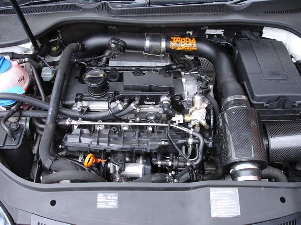

How the engine bay is looking again  :smiley:
Just driving it round only using part throttle at the moment until its mapped, but first impressions are good, im pretty sure it feels like it picks up quicker, there is no more lag than what there was before anyway, We will see what its like when its mapped tho  :smiley:
