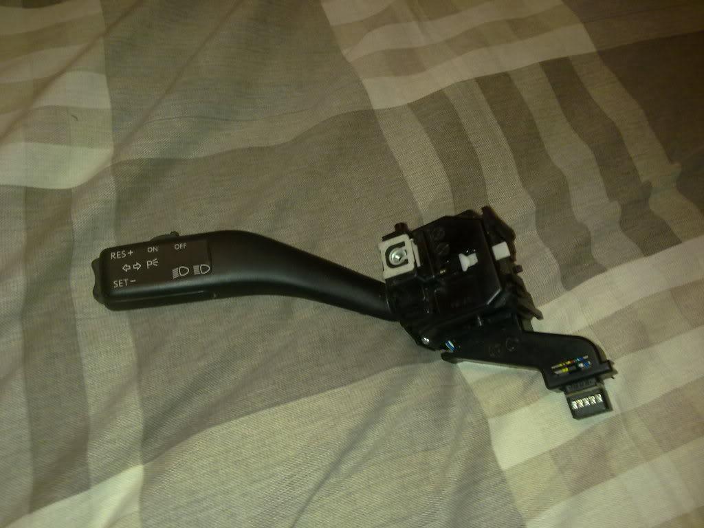

Offline liver
  • Posts: 980
Re: Cruise again
« Reply #13 on: May 12, 2010, 04:17:07 pm »
this is what i have atm

Re: Cruise again
« Reply #14 on: May 12, 2010, 04:34:11 pm »
The guide you linked to will get you most of the way.  I can't see your picture as the fun police at work have blocked it.
