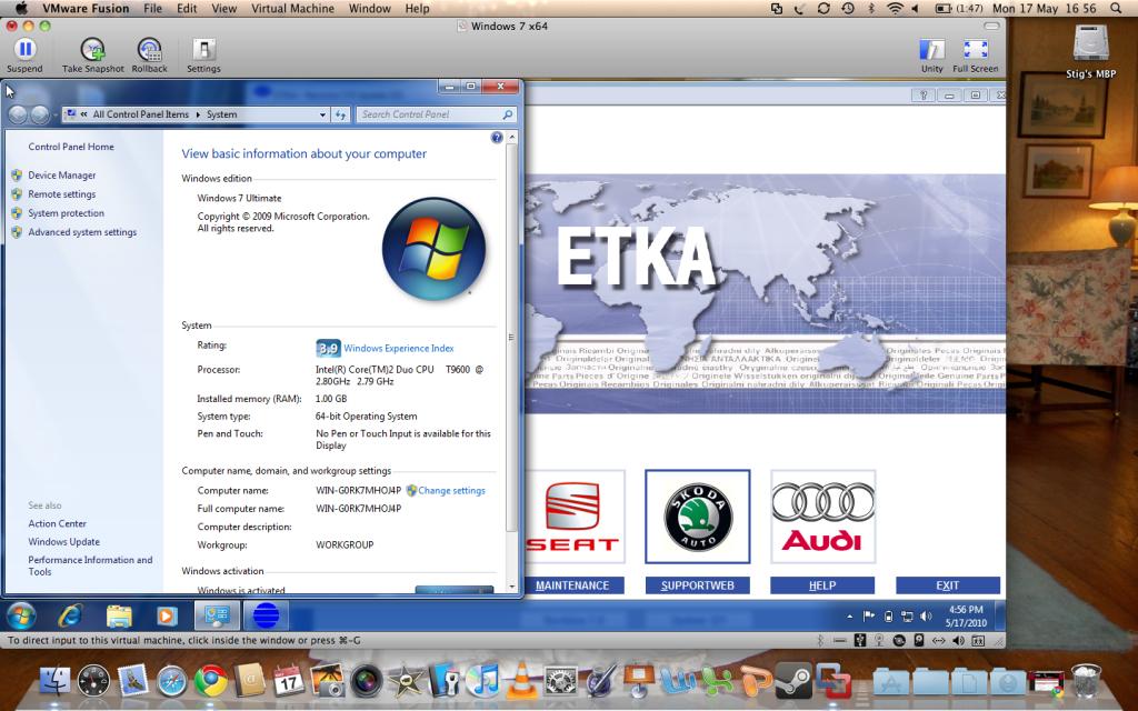

« Reply #11 on: May 17, 2010, 03:54:39 pm »
I have it running on Windows 7 64 Bit on my MacBook Pro through VMWare and it all works fine
Edit - to add picture
« Last Edit: May 17, 2010, 04:59:53 pm by Mater »
