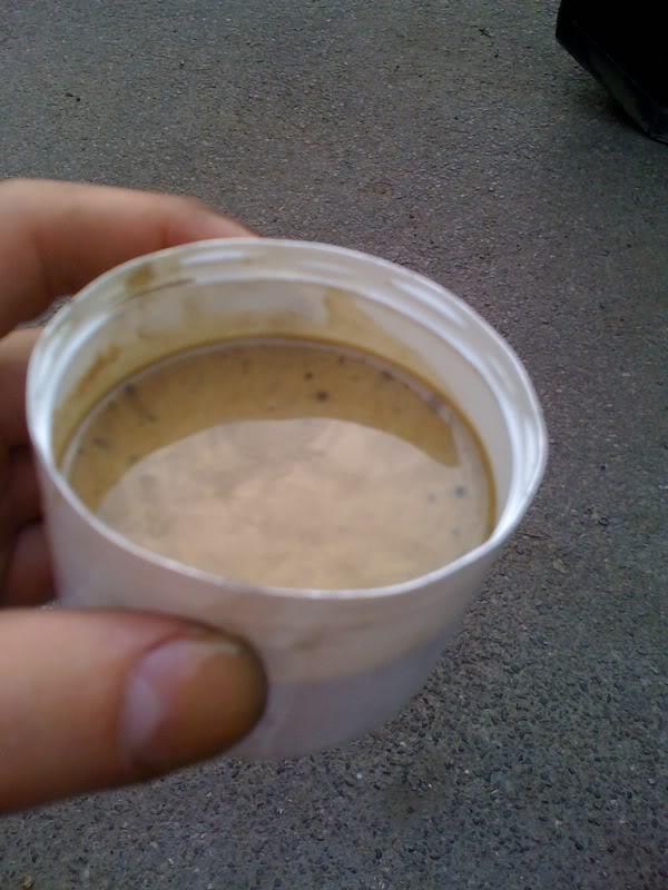

Emptied the BSH Catch can.  On my car (Leon) was an arse to access & I'll be looking at the Forge for fitment and
ease of emptying soon.
Here's what I got out...  Started very watery and got gradually thicker and more beige.

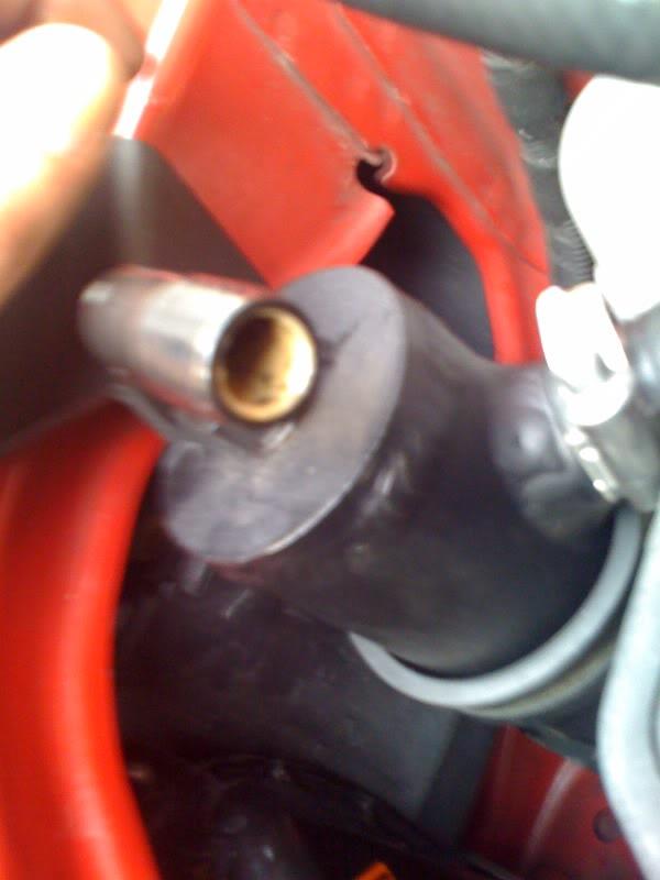

Here's what its doing in the connector, not nice  :sick:
I was quite alarmed at the colour and consistency of what I got out, is this normal???

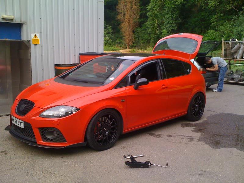

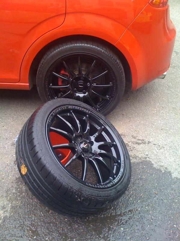

As for the wheels it was a wash and wax to keep the brake dust at bay...

what sort of oil you using in it mate ?
Re: Cleaned wheels, emptied catch can & bay candy :)
« Reply #2 on: May 18, 2010, 08:35:19 pm »
Usually Castrol Edge 5/30 but this time I forgot to supply my own / request it at the last service with AwesomeGti (about 5k miles ago)
Does it look wrong?  :confused:

changed my pcv recently, and had very little signs or major oil flow or signs of it inside the old blown pcv. Just Carbon diposits.

i ve got a mate who works for castrol , he told me only to use edge 5/30 for vw /audi fsi engines and the sh*t build up should be reduced to almost none , ive used it in my last 3 cars but never fitted a catch can to see if the oil works  :happy2:
« Reply #5 on: May 18, 2010, 08:44:41 pm »
Im one for getting paranoid about these things.  :confused: does it make a difference which way round I have the Hoses on the PCV fix???
Will use Castrol Edge again soon, I try to change it at 5k miles but can end up being every 10k if im honest  :ashamed:
This oil though has only been in about 5k

that gunk is exactly like mine was.  i rinsed the catch can and pipe work throigh every couple months

Yep, that kind and mix of gunk is what most of us are collecting in our catch tanks, so it's normal. I'm personally undecided about whether a specific oil results in no gunk etc - If that was the case, how come VW haven't made a big point about it?

....But without a catch tank I don't think you'd see any gunk because it will have continued on through. I don't know for certain though.
Having a catch tank system is certainly a good insurance.

Robin,the  pcv valve had no sings of oil flow via it,thats why I don't understand why such a large volume of oil has been presurised that much to such a volume in that catch can.in mine was just carbon diposits and no sign of any conjealed oil clogging up the engine breather or flowing via it.perhaps with a higher stage tune, causes more internal combustion pressure and results in engine oil being forced more around into the engines breather/into induction curcuit??

My PCV didnt have this beige coloured residue in it either  :confused:

My Catch Can often produces the same spunk out of it
I think its due to condensation build up in the gunk that is collected (a bit like you get in winter if your only doing short journeys). Don't forget your old PCV was connected direct to the Cylinder Head Cover so the oil etc going through there is hot all the time and it maintains the heat from the engine block. The catch can is located further away from the engine normally so it doesn't get as hot so the condensation forms.
Thats the way i explain it to myself anyway  :signLOL:
I don't think its anything for you to worry about
