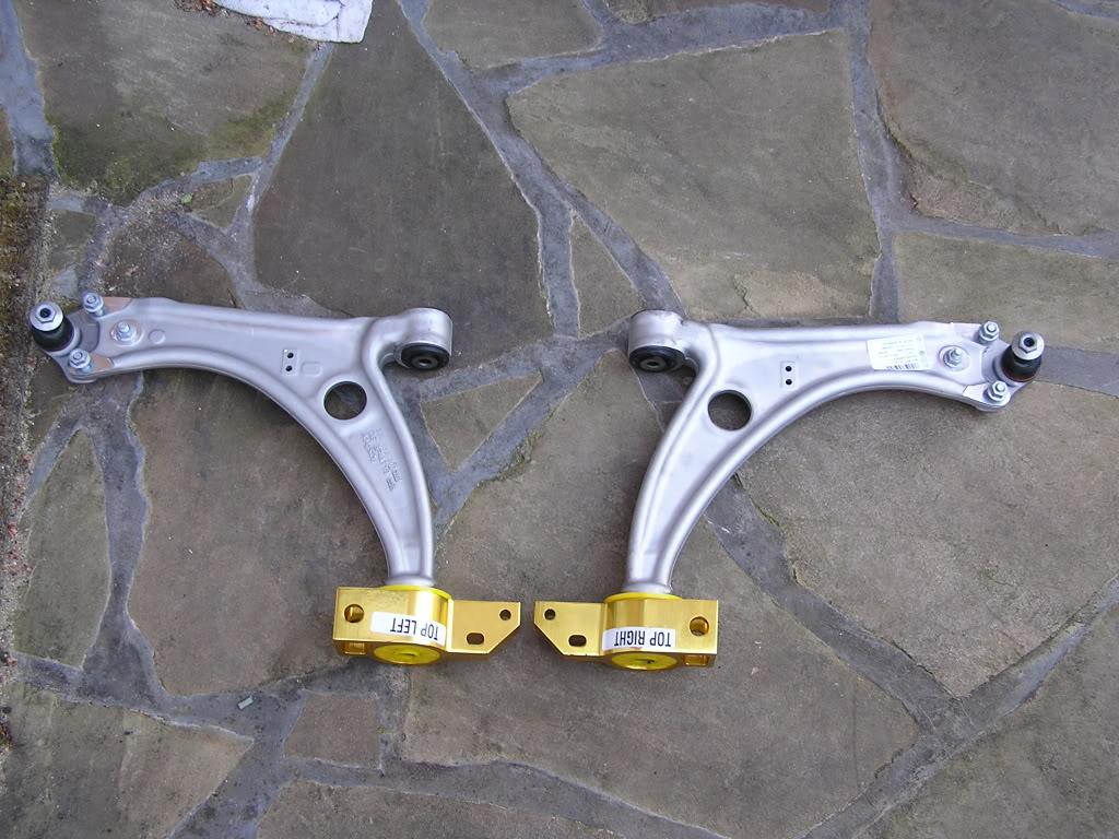

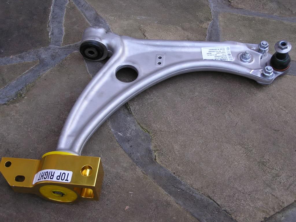

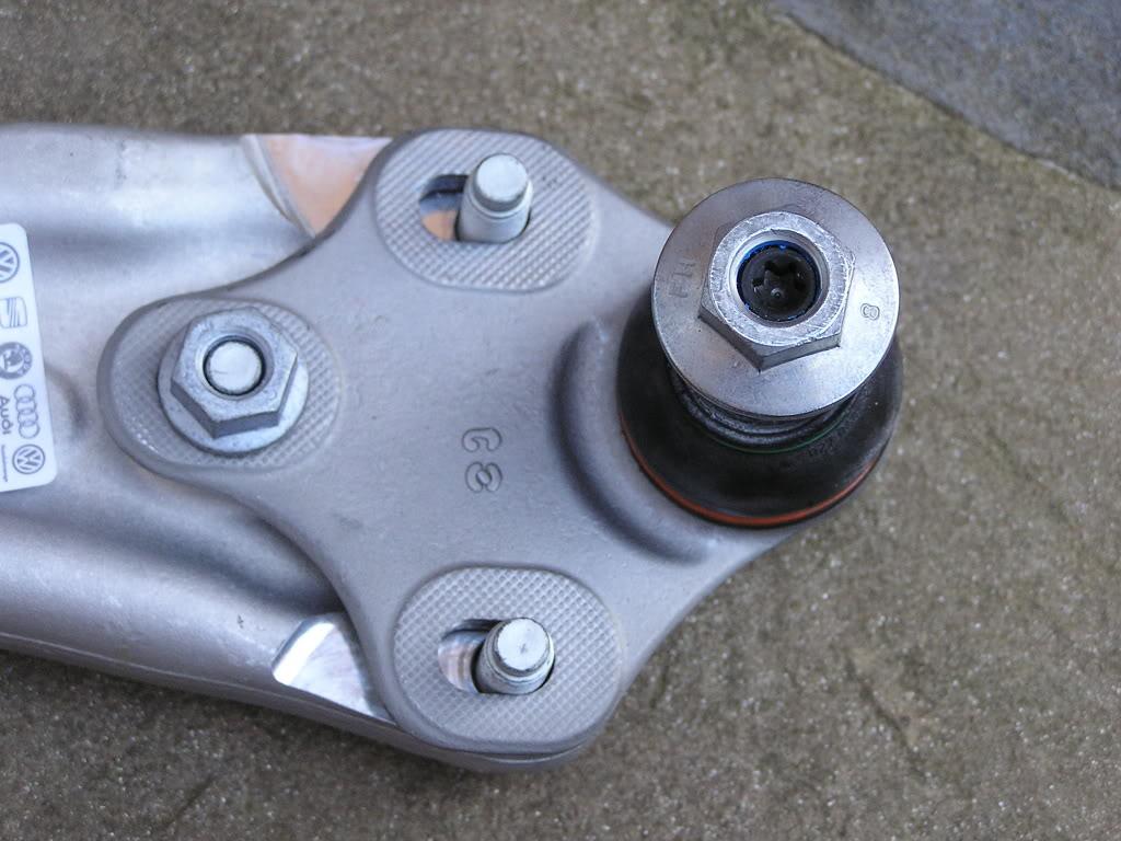

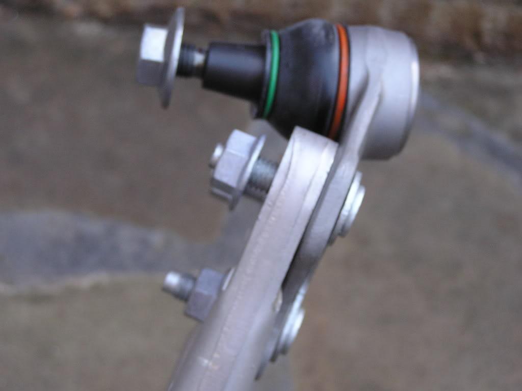

Hi, as above could someone tell me from the pics below if the ball joints go on the underside of the wisbone and bolt in place or the top side? I am assuming the top side due to the serrated edge on the ball joints to clamp in position on the wishbones better. Cheers in advance.

No, the lock plate is there and fitted. It is part or the 3 studs that connect it all. All i am asking is do the ball joints go on the top face or the bottom face of the wishbone? Im assuming bottom, so the serrated adge on the ball joint locks against the wishbone when tightened.

the ball joints are below the control arms, with the bolts to be fitted from the top down  :happy2:

looks correct in the photo. On the standard wishbones the nuts go beneath the wishbone.
early Vw's with camber adjustment on the arms had the bolts on the top as per the photo. Presuming this is to protect the nuts from accidental adjustment or possibly to make more difficult to adjust thus helping labour rates!

By having the bolts on the top doesn't it lessen the risk of losing them if they come loose? Though you'd have problems if loose anyway!

robin has a fair point.  if the bolt is from above and the nut falls off, you still have a bolt securing the ball joint.  if it cameup from below,  it could potentially drop clean out :surprised:
