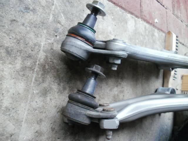

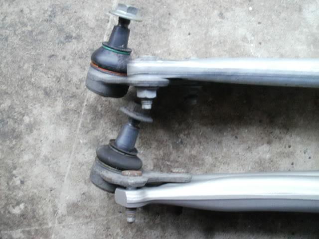

The ball joints on the TT arms sit on the underside of the arm, but on the S3 arms the ball joint sits on the top. (think GTI is the same)
Here is a couple of pics - TT arms at the top
If you uprade to TT arms without changing anything else, the arms will look like they are at a slightly different angle, but in reality the angle from bush to ball joint (pivot points) will remain the same. If the TT arms look horizontal or marginally pointing up it might look bad, but the chances are the balljoint is stlill lower than pivot point on the bush . . . . if you catch my drift

You wouldn't happen to have pictures of the TT hubs compared to the S3 ones would you??   :smiley:

If you want more négative camber, TT arms are definitely the way to go.
According to my measurement they should (I have to check it on the car when fitted) add from -1° to -1°45' (-1,75°) to your actual négative camber value, dépanding on how you set the ball joint up (thanks to the oblong fixing holes)
So, if you had 1° of negative camber you will end up from 2° to 2°45' of negative camber.
Then, or you can stick with OEM GTI swivel or go for S3 one (a bit lighter and may be stronger) (TT one don't seems to fit)
If you keep GTI swivel, you will be able to fit the ball joint under the TT arm as it has been designed and fitted on TT.
If you use S3 swivel, as it is more bulky than GTI one, you will have to fit the ball joint over the TT arm giving enough clearance to the swivel to turn around his vertical axle.
Note:
Ball joint fitted under or over the arm doesn't alter the geometry. What matter is not the postion of the arm itself but rather the position of the axle determinate by the fixing point of the arm to the subframe and the swivel ball joint.
TT swivel have a different fixing point which allow this clearance.
