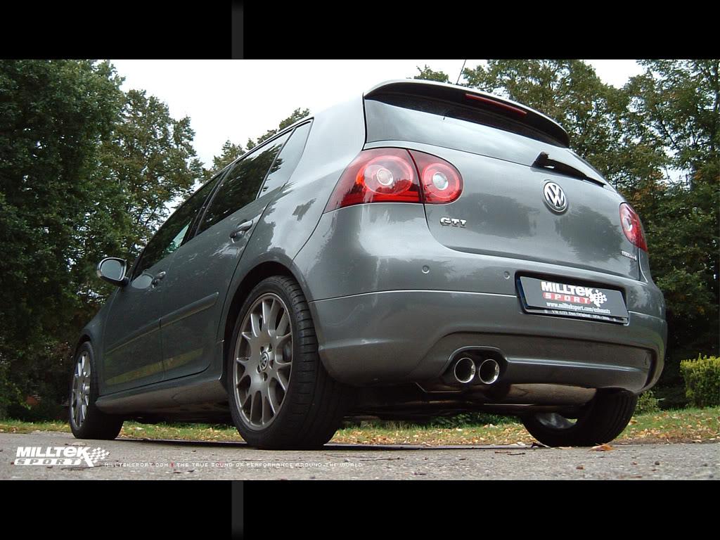

Some of you may know that I’m running a feeler thread for people interested in some custom black tips for the Milltek system.  One concern i have moving forward is that the CAT is quite deep and thus can be seen from the rear of the car.
Just for absolute clarity, it is the CAT that can be seen on the picture below:

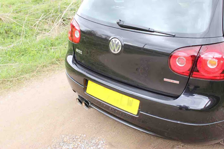

I've not really considered Blueflame as they do not seem to offer an equivalent to the Resonated Milltek cat back.  However, i noticed from looking at pictures of Golf’s with the Blueflame exhaust system on that the rear was quite different.  Can someone confirm that the reason the car does not have any back boxes on the picture below because this is a decat exhaust system:
If it is then does anyone have any images of the Blueflame system on an Edition 30 with the cat at the back?  I'm wondering if it protrudes like the Milltek system.

correct, you cant see the back box on the blueflame  :happy2:

I've got a Milltek on my GTI & ''YES'' you can see the box a  bit but it's not bad & you don't see it when driving anyway, just enjoy the noise. :happy2:
Ahhh...so the CAT is nicely tucked behind the rear valance like for the standard CAT.
Can i assume then that the boxes for Blueflame are shallow as standard compared to the Milltek?  Would explain some of the extra noise from the Blueflame perhaps?  :confused:

Just to clarify, the CAT is the catalyst unit and it is located on the downpipe app. 50cm after the turbo. The reason for the part you want is called a catback is that it is located after the Downpipe which has the cat fitted to it, so the part you want is "Behind the cat", get it??  :smiley:
The box just in front of the rear bumper is an resonance box, some exhaust has none, some has one and others have two of them, basically the more boxes the quiter the exhaust system is. So to answer your originally question, no it is not the cat  :smiley:
My own APR RSC 3" system:
You can see 2 boxes, the one closest to the front of the car is the RSC box and the rear a normal silencer box.
This box you are asking about is NOT the CAT  :wink:
