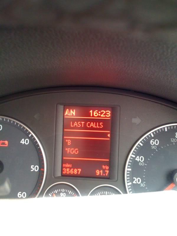

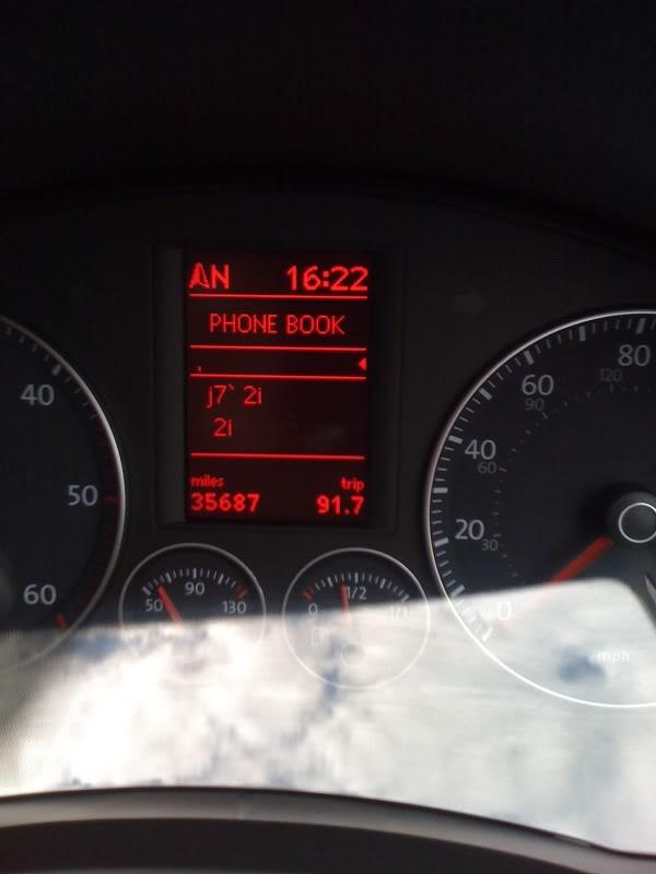

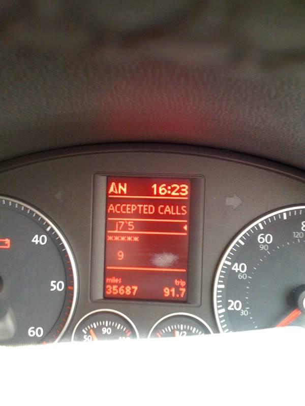

I updated mine and the missus iphone softwares-iOS 4 Software Update
i have the skoda bluetooth kit
and this is what i now get in my highline clocks :sad1:
any ideas guys :confused:
cheers
scott

3GS ios4 B Skoda bluetooth - same problem, the numbers show correct, but the contact names are rubbish
