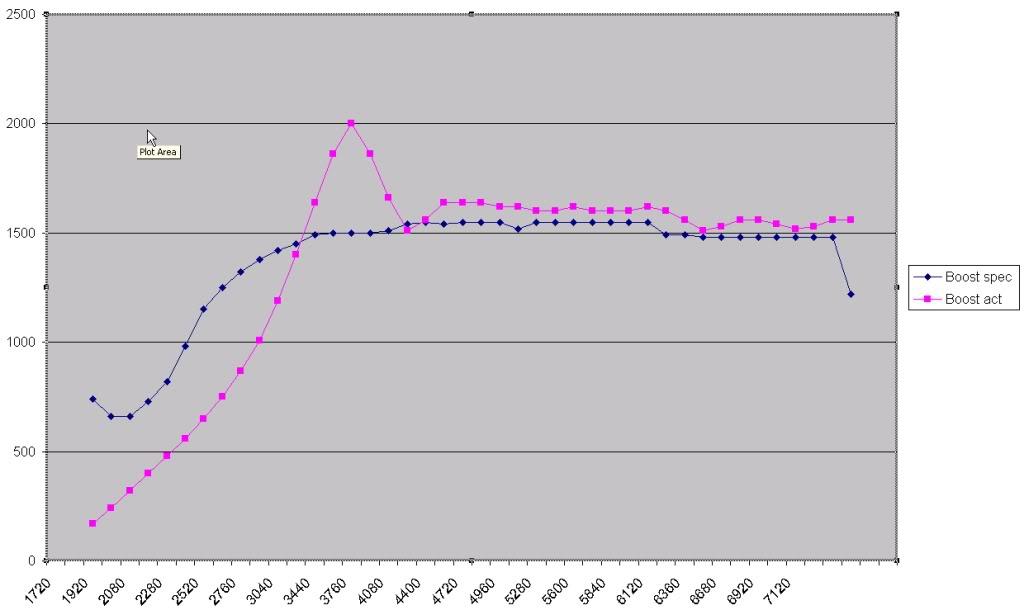

Ok very strange....
Even though VCDS says you were not WOT your boost graph looks like you were and is not showing spikes.  Also your boost is constantly exceeding specified after the turbo spools:
Are you running the Forge Actuator?
Something is not quite right here as you should not be boosting like that unless you are WOT...

so what figure\'s would you be expecting at 100%?
who knows how to do a throttle alignment?? am willing to travel!
also will this cause the boost spike?
do you think this would need to be re\'aligned after a engine conversion?

Ok very strange....
That boost is extremely low, so ties up with not being at WOT.

Ok very strange....
No its not mate - I deducted atmospheric pressure = 1 bar.

Comparing these graphs to Mike_TFSI http://www.mk5golfgti.co.uk/forum/index.php/topic,15408.0.html which is the only other K04 logs that I can get my ands on (he is running stage 2+ APR the boost is comparable, but mikes show a WOT, but the engine loading on joes is ~140% where as mike, with the supposedly less agressive APR map is showing upto ~190%.
Anyone know what the engine loading value shows?  Could this point to a lack of fuelling for the boost level? as air is nothing without fuel to oxidise?  :smiley:

just had this responce from REVO....
\'Hi Joe,
it looks as though that log is at partial throttle. From the data you can see it’s massively overboosting at lower rpm then is trying to stabilize throughout the rev range. It could be due to any number of things; faulty boost control solenoid, DV, or possibly the actuator not set correctly. To name but a few.
Unfortunately we can only take educated guesses at issues by just looking at data-logs, I’d get it booked into someone that’s used to dealing with engine conversions and the TFSI engine to have it looked at and setup correctly!
Best Regards,
Kev Hall\'
Re: Logs from my car, ed30 conversion
« Reply #25 on: June 29, 2010, 04:42:46 pm »
\'Hi Joe,
Joe thats the best piece of advice youv'e been given mate!  :happy2:

« Reply #28 on: December 06, 2011, 09:30:59 pm »
Sorry to drag up an old thread, but did you find out what was causing the problem, as my car is doing the same thing
Thanks in advance :wink:
Offline gazbutS3
  • Posts: 3213
« Reply #29 on: December 06, 2011, 09:53:04 pm »
IIRC it was the connection into the ECU wasn't correct, the blocks in the plug were pushed back or something, Stattlers sorted for him :happy2:
