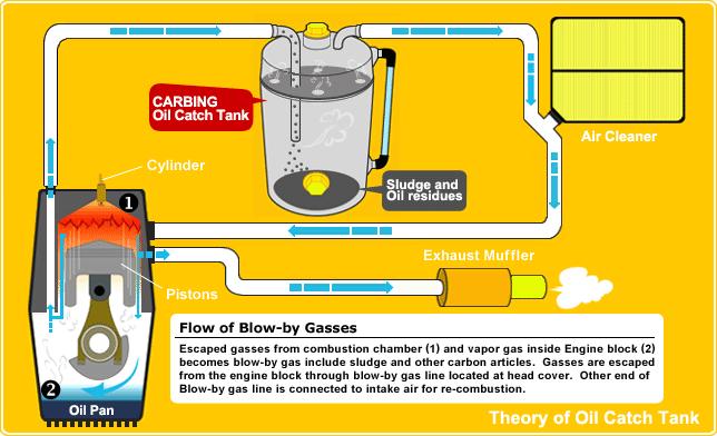

WHAT IS IT?
Positive Crankcase Ventilation (PCV) is a system developed to remove potentially harmful vapours from the engine and to prevent those vapours from being expelled into the atmosphere. The PCV system does this by using manifold vacuum to draw vapours from the crankcase into the intake manifold. Vapour is then carried with the fuel/air mixture into the combustion chambers where it is burned. The flow or circulation within the system is controlled by the PCV Valve. The PCV Valve is effective as both a crankcase ventilation system and as a pollution control device.
WHY HAVE ONE?
Excess crankcase pressure is vented from the crankcase through the PCV system, where it is drawn into the intake manifold and returned by the engine. This recirculated air contains aerated oil from the crankcase which is burned by the engine. Some (not all, I'm told) turbocharged engines, especially when performance modified, can draw significant amounts of oil into the engine through VAG's oem PCV system. An aftermarket oil catch tank system removes and collects the aerated oil so that it can be drained and externally recycled. The resulting sludge looks like a rich banana-coffee milkshake but it sure as hell doesn't smell like one!
Here is a well debated discussion in this linked thread about why you should have one or not:
http://www.mk5golfgti.co.uk/forum/index.php/topic,7040.0.html
John (john_o) says: "The key thing to remember is that the TFSI engine doesn't have a catch can (but everything else is relevant), and oil fumes / water vapour and related gumph are ported back into the engine to try and achieve good emissions. On most cars this is not a problem as fuel washes constantly keeping everything clean. The bad news is that TFSI is direct fuel injection (injectors spray directly into the combustion chamber), so the only thing passing the intake valves is air (and the oil and water vapour gunk), this is really bad news."

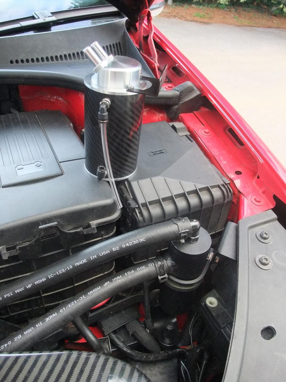

THE FORGE CATCH TANK SYSTEM:
Forge Motorsport, in my experience, is a typical small British company which strives for high quality in all its products. It's ethos is to design and manufacture the best without compromising quality. Okay, it's not aircraft industry standard but cars don't usually need to fly, and aircraft industry quality would be phenominally expensive. You can judge Forge's quality for yourself, even from the photographs. Additionally, simply supplying the more durable stainless steel jubilee clips instead of cheaper metal ones is a good example of Forge's way of thinking.
Designed as a closed PCV system Forge's offering of course includes the same functional components as most other manufacturers' kits. However, Forge's kit importantly uses hoses which are fluoro lined for chemical resistance and also features an invaluable sight-glass window to visually check when the tank needs emptying. The first kits used an externally mounted clear plastic tube for checking tank levels and this method is used by most other catch tank manufacturers, but Forge thought this through a bit further and decided that using glass would be much more resistant to any possibly abrasive cleaning agents, including petrol, used to clean out the tank between fillings.
^ Fluoro lined hose connections.
^ A replacement screenwash filler assembly (with stainless jubilee clips) is included in the kit.

INSTALLATION:
Straightforward and with instructions online from Forge with a downloadable pdf. I would point out that the current instructions are only for the American market without a charcoal cannister and so include no reference whatsoever to the screenwash assembly. The professional experienced mechanic who installed my Forge kit was not impressed by this and neither was I, but Forge are addressing my criticism across their products as appropriate.

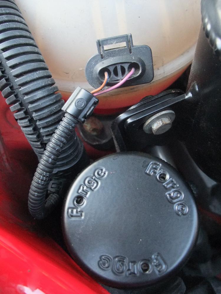

I recommend fitting Forge's screenwash filler before the catch tank on the shared bolt. This will facilitate the tank's removal later for emptying and cleaning.
CHARCOAL CANNISTER - Fitting Tips:
On the Mk5 GTI the two hose connections on the top of the oem charcoal cannister interfere with the Forge Catch Tank. This can be resolved by undoing the oem spring clip on the rubber hose and twisting the hose out of the way. A special tool is needed for the VAG oem spring clips. While doing so it's also sensible to make sure it routes as low as possible so that the Forge pair of hoses can be positioned over the top - This will ensure much easier access when emptying the Forge tank later. However, as I have an Evoms engine cover, routing the Forge hoses below the charcoal cannister hose makes sure they don't risk getting cut by the metal edge of the Evoms cover. It's easy to access and loosen Forge's stainless jubilee clips anyway.
The second charcoal cannister hose is rigid plastic with a heat welded connection but the round cap can be carefully removed and repositioned at an angle so the rigid pipe avoids physical contact with the Forge catch tank.

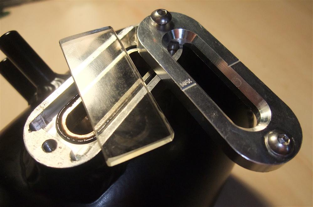

MAINTENANCE:
Simple and easy to periodically check the catch tank's contents level and helped by the MAX line on the window frame. Emptying and cleaning the tank is straight forward and if you have followed my installation tips by fitting the Forge fluoro lines above the charcoal cannister hoses, there's enough flexibility to clear the engine bay. And you can easily loosen the jubilee clips as well if you want to completely remove the tank. Best to wash out with petrol.
For further cleaning the sight window can be opened with a small allen key and the 3mm thick polished edge glass taken out for wiping - This shows a lot of consideration.

....The stainless steel allen key bolt is nice and long and also allows a more direct dump with less dribbling than BSH's version.

The sight-glass looks to be almost fully obstructed by the Screen-wash filler neck.  During our previous conversations, I thought Forge were going to re locate it?
Also a sight-glass will have a tendency to cloud up, and become discoloured, hence a dipstick is the preferred measuring device in oil wetted systems.
Much prefer the black can over the straight aluminium variant.

Forge aren't offering a polished alu version anymore - It becomes even more expensive to produce. But if you were a serious show 'n shiner I expect they'd happily produce one for you.
The sight-glass has been repositioned - It was on the opposite side where their original external plastic sight pipe was. It isn't obscured by the screenwash filler but it does sit quite low but not so low to be a problem.
I know that a plastic 'sight-window' will cloud up and discolour but this is real glass. No such problem with my previous sight-glass but it was only on for a few months. Will glass cloud up and/or discolour? Also, two small allen screws allow access to remove the glass separately for cleaning - A nice touch methinks.
Does adding a dipstick method potentially provide a weaker vacuum seal?
