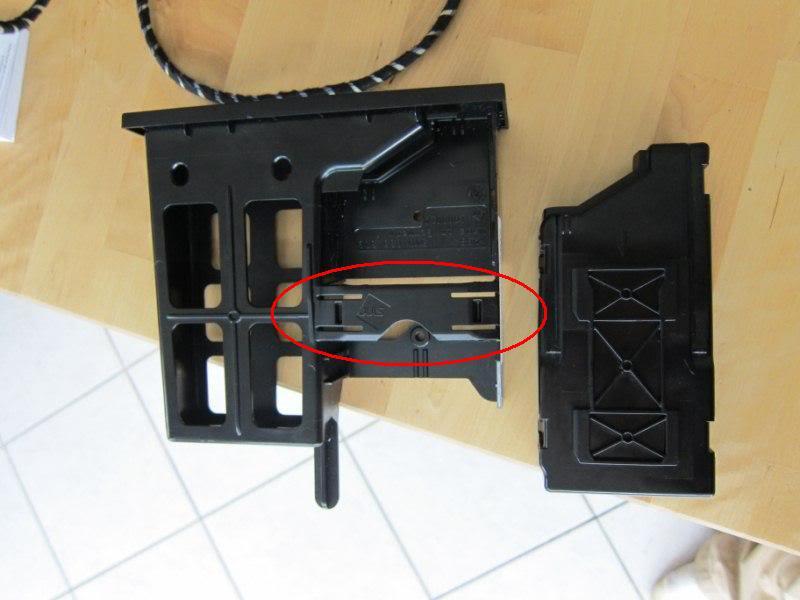

Can't find that actual page I was looking at Rob, but have found a few pictures that hopefully explain it. The MDI comes in the non shelf version apparently for a number of models in cluding the passat.
The shelf can be carefully removed from the MDI control box (it's a bit of a b*tch apparently) to leave this :
From this:
The actual unit can be mounted just ahead of the ashtray out of site thus..
Then using a VW IPOD/MDI extension cable the cable can be plugged in and routed though the small hole at the back of the glovebox
Hope this helps ?
« Last Edit: June 30, 2010, 04:43:49 pm by Norbreck21a »

Rob thats how I've now got mine but mine is in the little cubby hole on the right of the steering wheel,
There is 2 screws in the mdi shelf take them out then the plastic bar that goes across the mdi shelf needs prising up a bit to then pull the module out of the shelf.

I've been trying to release my MDI from the armrest mount for about an hour now and its driving me up the wall.
So far I taken the 2 T20 screws out and it won't budge you say pry the plastic bar up do you mean this one:
PS Obviously this is not mine  :laugh:
EDIT: Just done it found two indents either side of the bridge and slid a small screw driver under each releasing the MDI from the mount.  :happy2:
