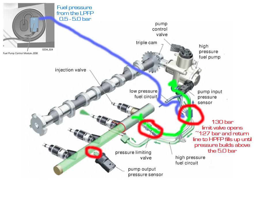

February 10, 2010, 12:39:00 am »
Quote from: vRSy on February 09, 2010, 06:58:39 pm
yeah as did i, that is the MAP sensor(thrust sensor)
x2 what have you replaced it with hurdy
OEM part is in front of me now.
06D 130 767C by KLN stamped on the side.
Still working through logs and set up to see if changing it helps.
It is the pressure limiting valve in the pic below.
http://daz.co/media/hh199/tbuccini/130bar_failure_Hypo.jpg[/img]"]
