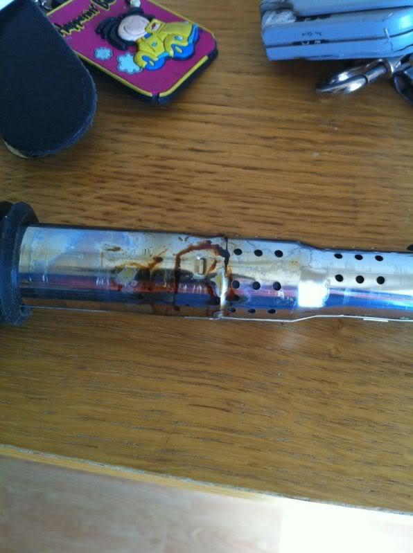

Right, got the coil packs out in the end and swapped number 2 with 3.  Now I'm still getting the hesitation on full boost as it drops on and off.  However I cannot now get it to pop up a fault light :sick:

And also, should the coil packs look silver and shiny when used because neither were...

A light on the dash doesnt mean that the fault isnt there, read the codes and see if the missfire has swapped to the cylinder that you changed the coilpack to. A bit of discolouration is 100% normal, dont worry.
Thats good to hear ref the discolouration.   I didn't realise it logged a fault without a light on the dash.  When it was only occassional last thursday it didn't log any faults although it is much worse now.
