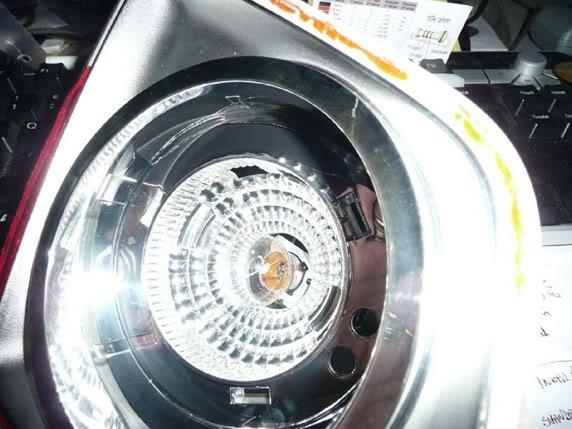

So if you have purchased the OEM Valeo rear lights then you will have noticed that the inner lights (the two on the hatch) are not LED's. There is a hole for them but nothing else meaning you have to put up with the standard bulbs. This how to allows you to modify these inner lights to create something special!
Like this:

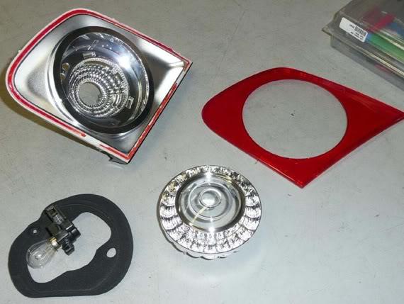

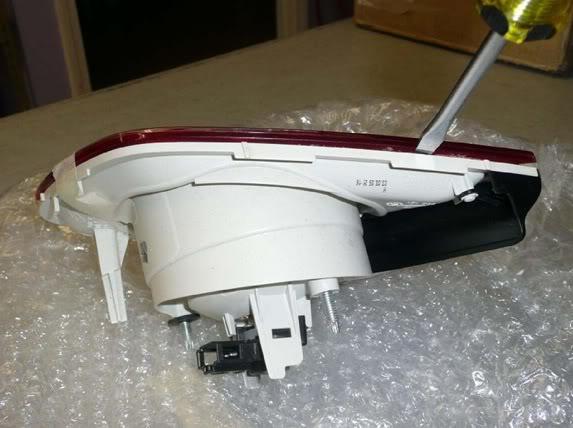

First pry open the housing. I used a medium sized flat tip screwdriver. Slide the tip between the lens and the back housing. “DO NOT” turn the screw driver like you are removing a screw. Pry it like you are opening a can of paint. Be gentle pry very slowly until you hear soft cracking. This will be the lens cracking loose from the housing. I went around several times.

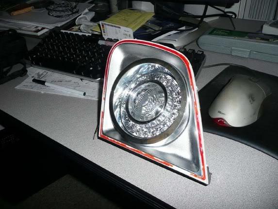

When the lens comes loose, separate the inner chrome housing from the main housing. On the rear you will see 3 pinch tabs sticking thru the main housing. Squeeze and push hard. Pain in the ass time. When it separates, mark the inner so you know the direction when it goes back in.
Not much to it is there?

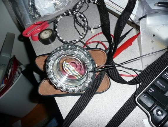

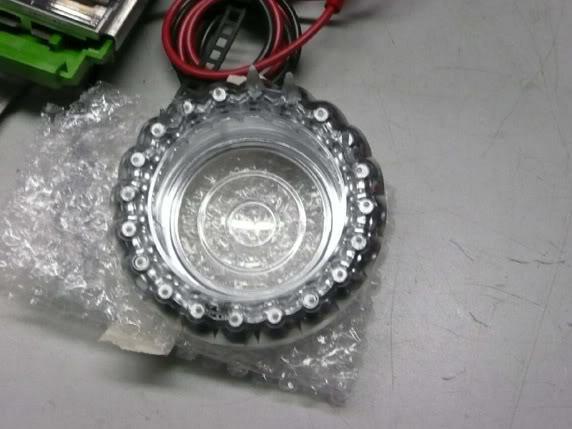

Looking at the back of the inner chrome housing. You can see there are two long pointed legs. These legs stick thru two holes in the main housing to align things for assembly. Next, flip the chrome housing over so you are looking at the back. There are 20 small flat pads that you are going to drill out for the leds. Drill a small hole first then a larger hole for the 5mm leds. At this point you are going to realize that you just drilled thru those two pointed long legs. Just trim them off. You are going to use the holes they were in to run your led wires out of. Several of the holes are going to need to be leveled off to be the same height as all the rest.

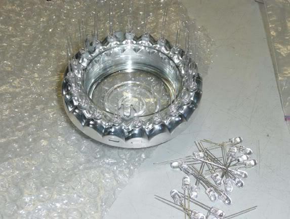

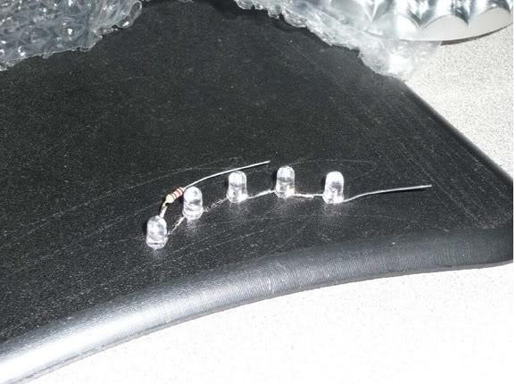

Now set the leds in the holes you just drilled. You will need to bend one leg back and one forward. You are going to solder 5 leds together negative leg to positive leg alternating.

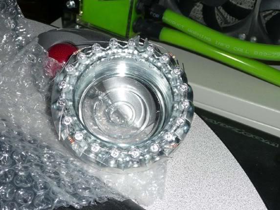

You are going to make 4 sets of 5 led lights to a string with one resistor on each string.
This is what each string will look like out of the housing.
This is in the housing. Be careful not to scratch the front of the housing. When this is done, you will start grouping the strings together by soldering on wire extensions. You will connect all the negative terminals together and the ends of all the resistors. The wire MUST be wrapped very close to the sides. There is very little room to work with here. I ran the positive on the outsides and the negative as a bare wire on the inside edge of the edge. I secured everything with touches of hot glue to keep things in line.

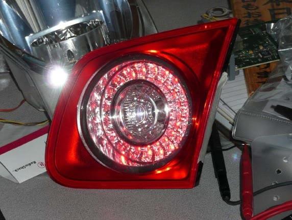

Here it is all assembled and lit up at 12 volts. To wire into your car, it’s just two wires. One negative and one positive.
