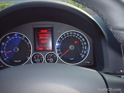

I think it looks like this (although this is not my actual car), so I guess it is the highline? It displays the gear you are in to the right of the screen when using paddles.
Thanks for all your help and advice chaps  :happy2:
UPDATE: Actually after a bit more research and LouCyffer's comments, I think this may be the midline, can someone confirm?

if the gear indicator is on the right of the screen then its midline,  :sad1:  Highline has it at the bottom of the screen.  One further thing you might have noticed is that when the doors open you only get a light on in the top half, in hihgline you get a little picture of the car with an open door.

« Reply #8 on: July 30, 2010, 10:29:05 pm »
This is what Rich is talking about. This is highline:
