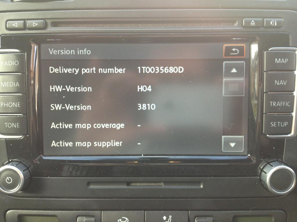

I'm currently running 2760 already, tried just moving to 3810a and still all the same issues.
Tried changing clock from 12 to 24 and back and still nothing.
I'm stumped

I have been all over the internet and downloaded a good few F/W versions (4120, 4020, 3810a, 3810, 4020H) and used 3 different computers. And not one works.............. they can't all be bad.
Now I've lost maps too, and no radio  :sad:
Under software version it's now blank...............  :sad1:

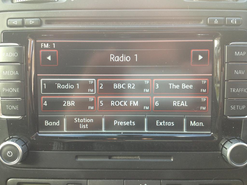

Well after 9 hours and countless downloading
Even managed to get F/W 5218_Mod on it, but ended up with no sound, so have rolled it back to 3810_Noru, Just having to create a map disc now, as the installs wiped out the maps :sad1:
So out of 15 Discs, and 4 different web sites for downloading and 3 different pc's/laptops, I have so far managed to create 2 working discs ( F/W 3810A_Noru & F/W 5218_Mod )
I'm going to try and get to F/W 4120, as I really fancy Radio Text ( Sad I know )
I can only imagine this is why so many RNS510's are not updated, because it is a complete arse ache.
