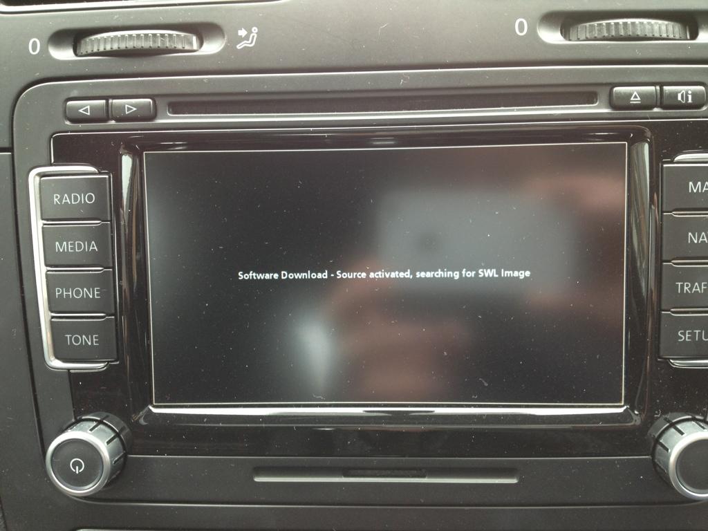

So I have the following
RNS 510 C - currently running 2760 F/W and Maps Version 7551
I have downloaded the firmware files from RNSfirmware.com  and from the my-GTI, I have versions 3810a and have Euro 4120 firmware.
I have bought Verbatim Discs DVD-R, TDK CDRw and Traxdata CD-R, but none of then get pass the full install stage, the RNS510 see's the image, see pictures below.
So apart from hanging myself, or driving the car into a brick wall, what on earth can I do...................
Someone help me out........... Does anyone have a disc that they know will 100% work??

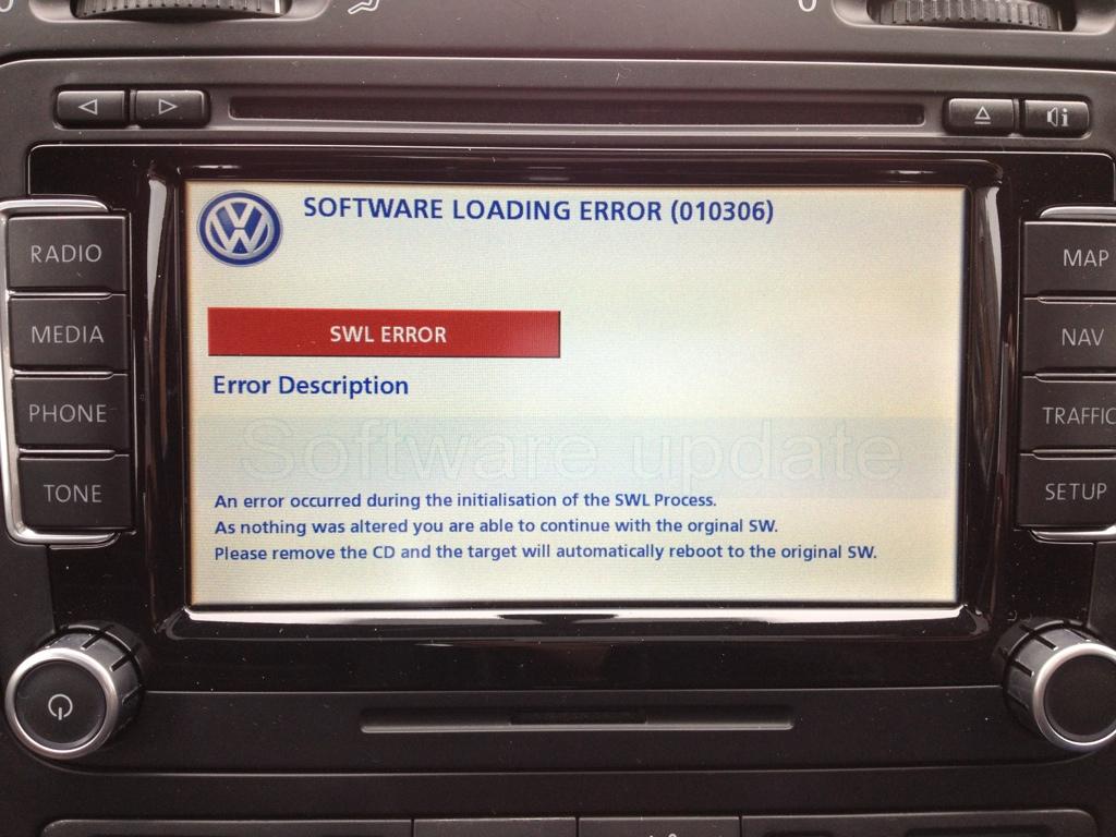

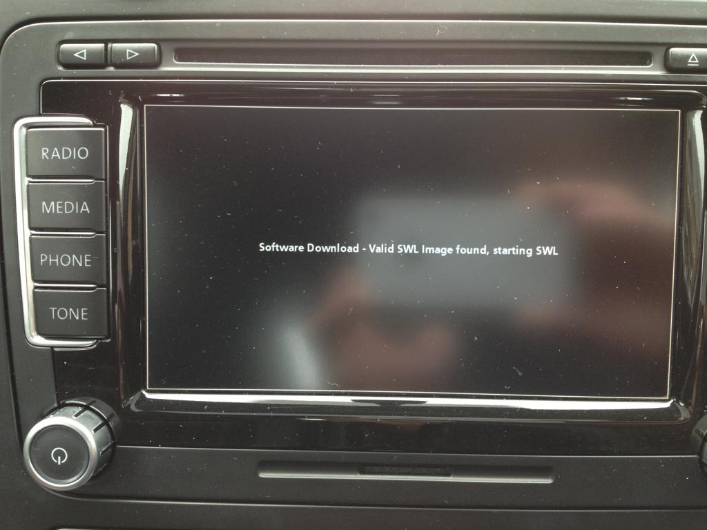

Well I've tried everything,  to no avail......
So 2xLaptops and 1X Home PC later and I'm still stuck, oohh did I mention 10 discs too and 2 lots of Firmware 3810a and 4120
and all I get is error
Then this
But it says this
Dis-heartened doesn't come close...........
Any ideas on what to do, or links to something

« Reply #11 on: March 09, 2013, 10:35:18 pm »
If I recall you have to load 3810 to get the new partition layout, then 4120 thereafter.
I have 4020 on mine.

« Reply #12 on: March 09, 2013, 10:46:20 pm »
What format is your clock time? If 24 hr try changing it to 12 hr and then try the update again.

« Reply #13 on: March 09, 2013, 10:52:09 pm »
I've also had and been trying 3810a firmware update, and still same errors

« Reply #14 on: March 10, 2013, 08:42:09 am »
What fw are you on at the moment?
If you're on something really low then it may be worth trying a lower fw first like a 2760. And then upgrade to 3810
