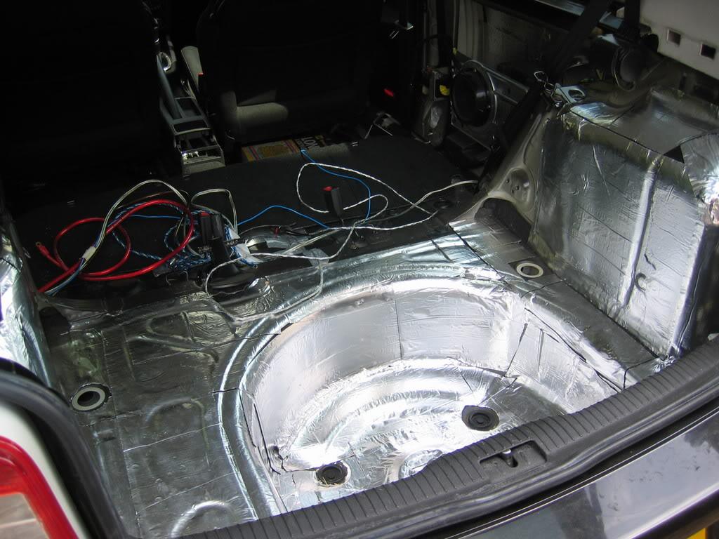

Yep, perfectly possible to amp a standard HU, with good results.
On the Golf all I've done is swap out the standard nav for a pioneer SPH-DA120. Just that on its own gives much better sound. I may add an amp and sub in future.
On my RS4 I swapped the HU for a pioneer AVH-X8700BT, swapped front components for focals, disconnected the rears, JL 10" sub in a "kustom box" enclosure, dynamat in front doors, and a JL XD500 amp. It's 3 channels; 2x 75W RMS for components + 300W RMS for the sub. The amp is nice and small too, tucked away in the wheel well area, just required a small amount of foam to be cut.
http://www.jlaudio.co.uk/xd500-3v2-car-audio-xdv2-amplifiers-98603

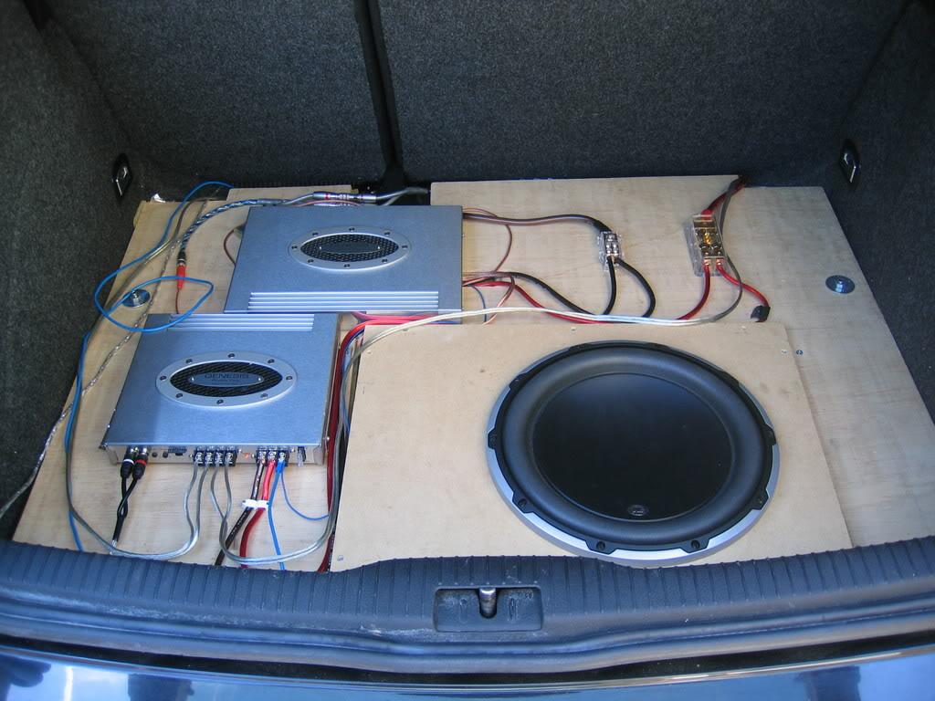

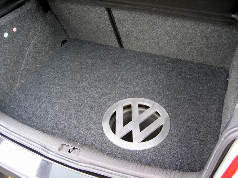

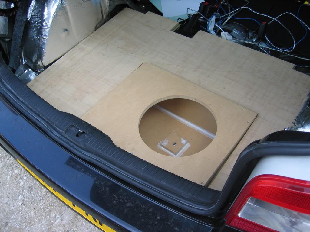

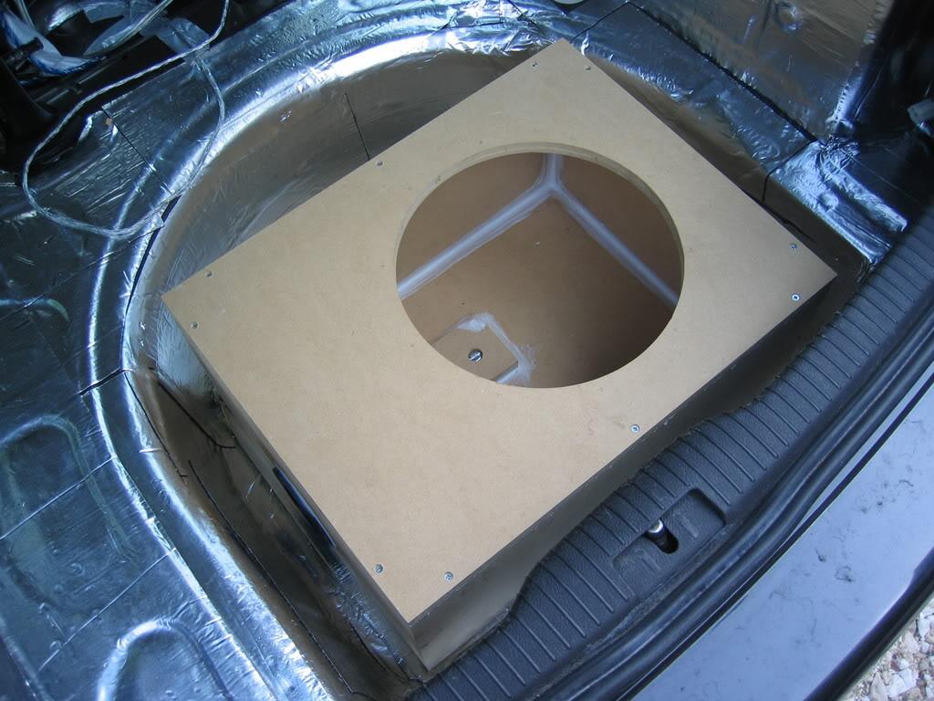

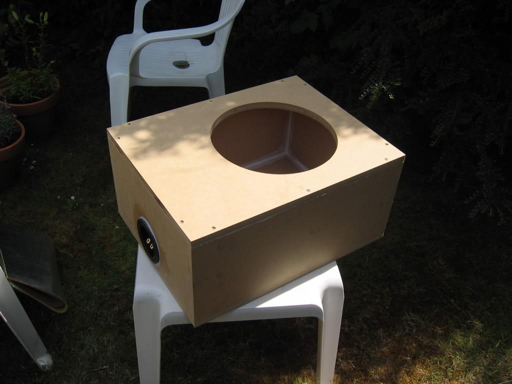

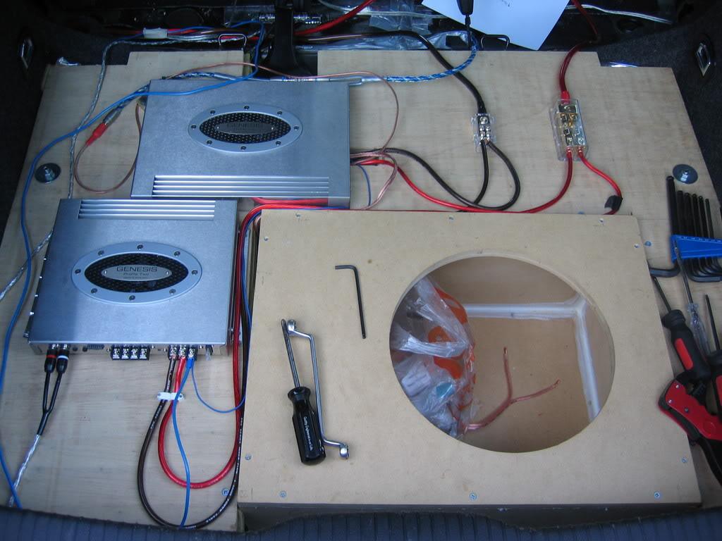

It sounds a million times better than the OEM bose, which belongs in the bin. Still not as good as my Mk4 GTi which had a 12" JL W6 and genesis amps (amped the OEM fronts - they're actually pretty damn good.) I turfed out the spare wheel so I could make a box and bolt it in the wheel well to take the 12" sub. This was years ago when I was at uni and had time for this! The bass dropped looooow.  :happy2:
