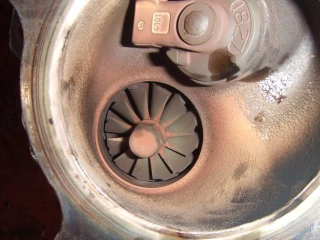

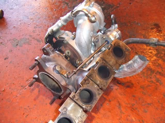

Well my car is been put back to standard with jkm at the moment and they discovered this when looking at the turbo..
not too good and not sure on how much longer it could last like that, so its been replaced as I dont want the engine eating it and it costing more  :sick:
couldnt tell anything was up myself but i use to get a jingling sound on spool up when the car was cold, once warmed up it stopped, boost was still cracking 28psi and holding at 25psi despite the damaged turbines
anyhow not 100% sure on the cause but it will be looked at further but just a few photo's of caution to those maxing out their k04s

Ouch that looks expensive!!
It's difficult from the pictures to ascertain if the tips have been hitting the casing or if it has been caused by stressing of the blades.

I've logged mine with the Forge actuator and had over 27psi on VCDS logs. This was due to overboosting with the actuator rod set incorrectly on the wastegate and the car was only requesting 25.5psi. Once it was set correctly it still slightly overboosted at 26psi, but it was within 0.5psi and so was regarded as being within operating parameters. Maybe your actuator was set a little too tight to the flap opening and wasn't getting the flow right. Not the reason for the blade damage though, just the overboost. :happy2:

but would the overboosting make the blades get even hotter and the weak point are the tips as they are so thin hence why they have just come off
