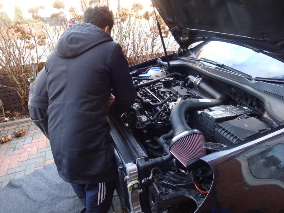

Step 1 - Get someone to help as this is not a one-man job if you've never done anything like this before.  Plus it gives you a bit of confidence to crack on with the job.  I enlisted my brother-in-law and his cousin who were bribed with tickets to Santa Pod on Sunday.
Unsuspecting Mugs - I told them it was only a 4 hour job :grin: :grin: :grin: :grin:

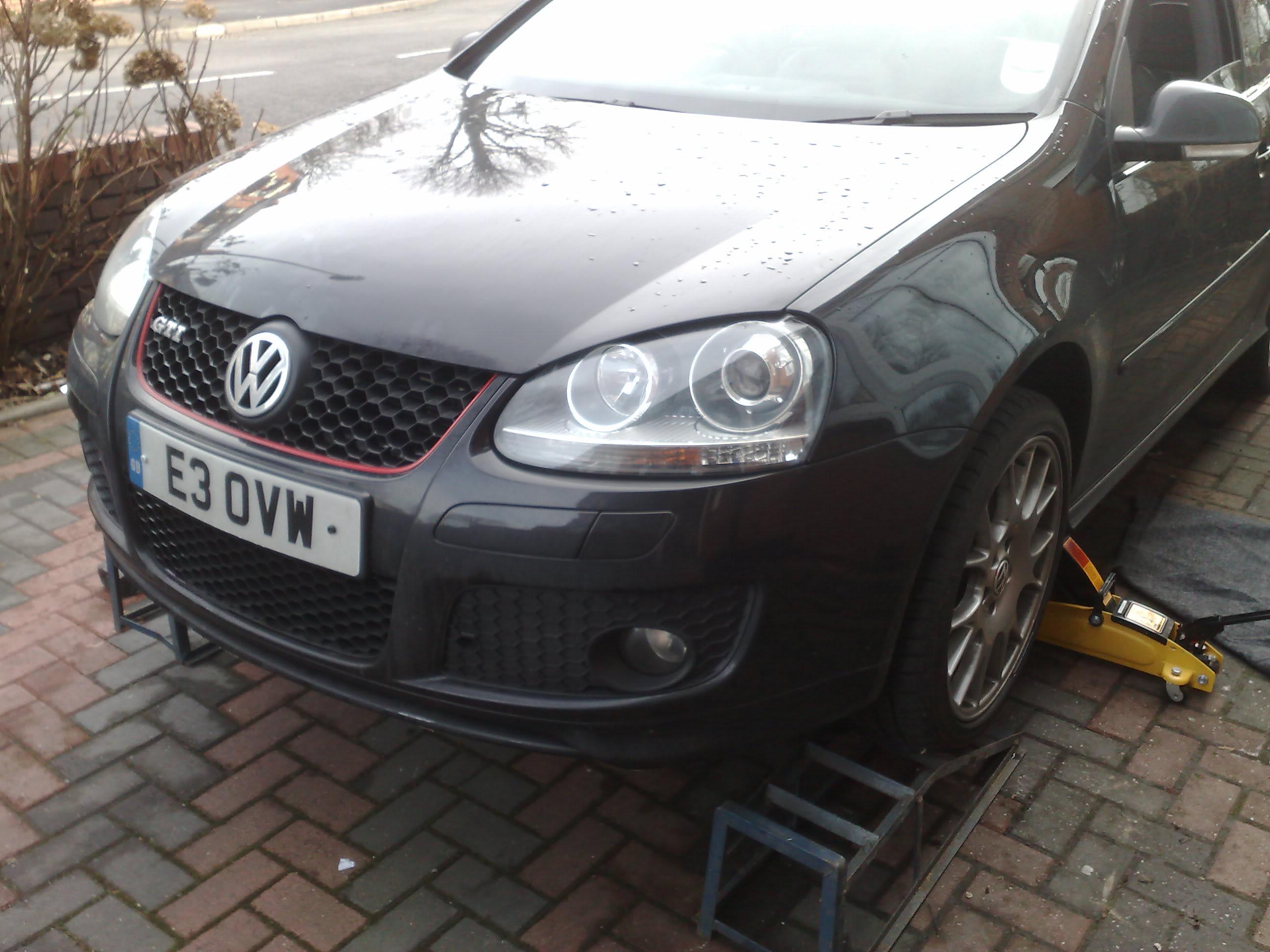

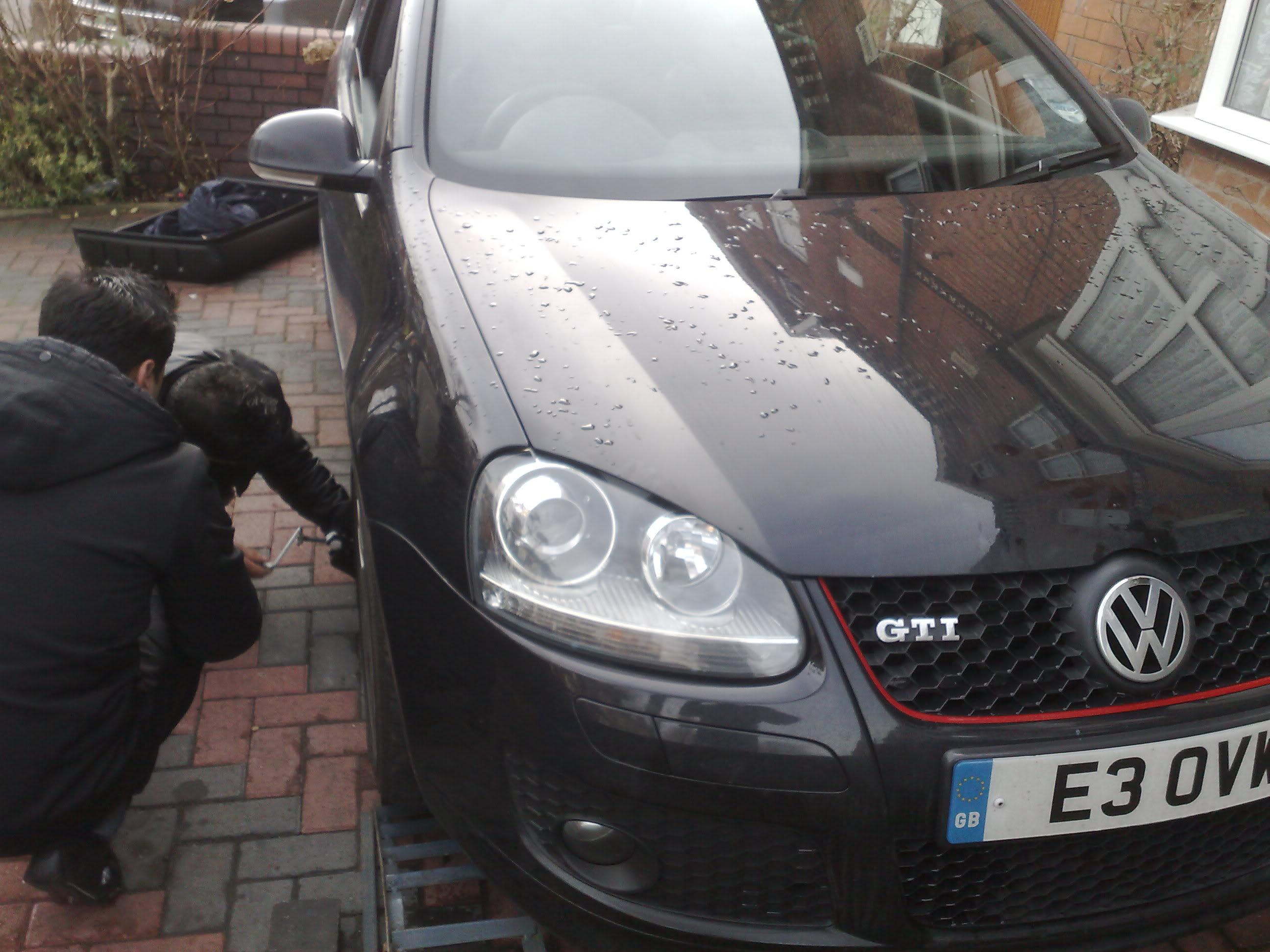

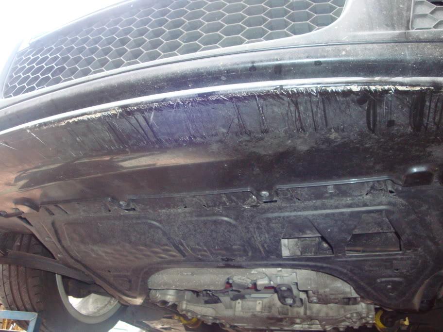

Step 2 - This part was very tricky as the front lower spoiler wouldn't allow the lowered Ed30 to mount the ramps.  We had jack the car very high, slide the ramps underneath and then drive it the rest of the way.
Looking for the jacking point - oh sh1t, whats that cracking noise   :shocked:

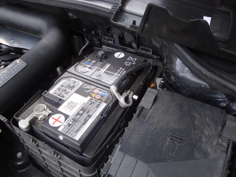

Step 3 - Remove the negative terminal lead on the car battery

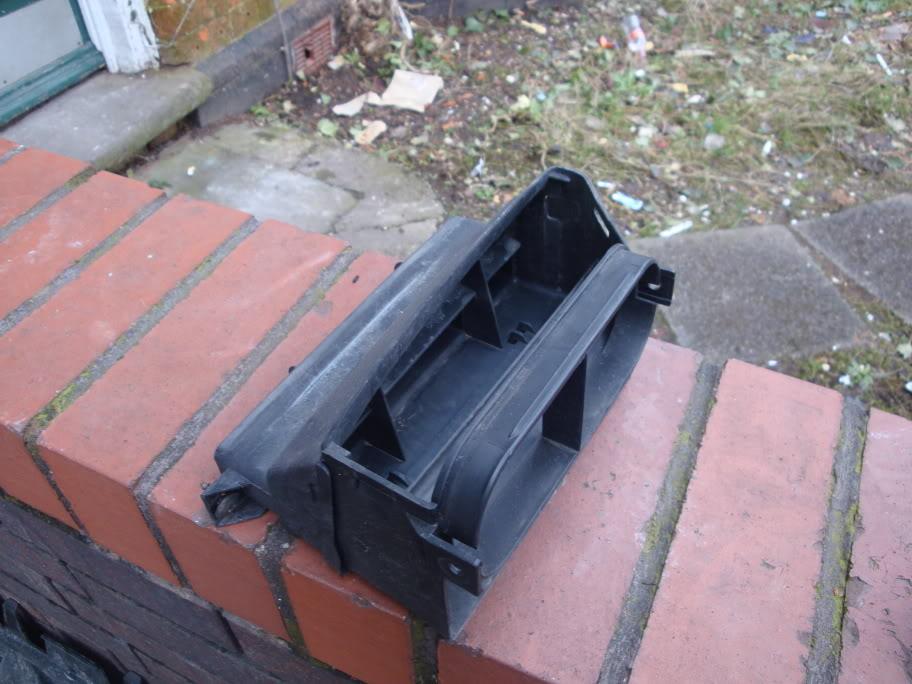

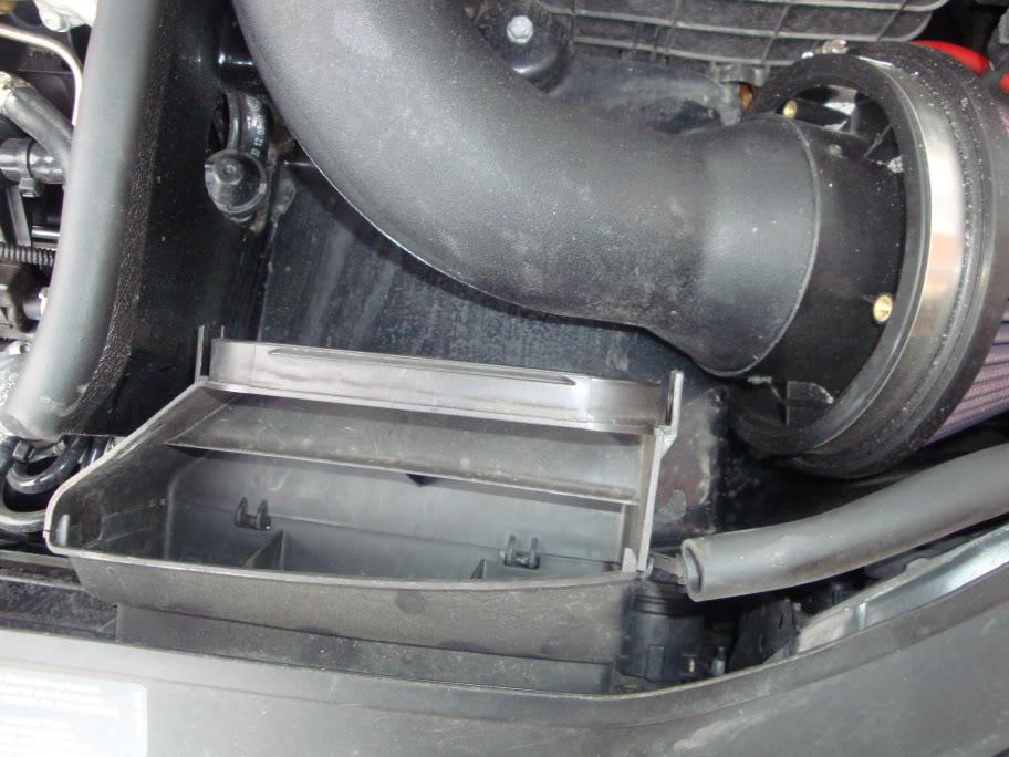

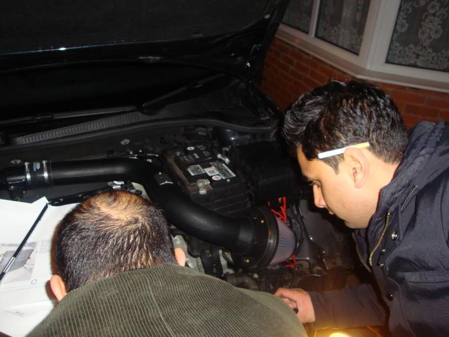

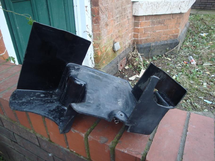

Step 5 -  Remove the air intake.  My car has an EVOMS intake so I was a bit confused at first as this did not need removal – although the cone heatshield was removed for access.
The oem intake removed
EVOMS Heatshield

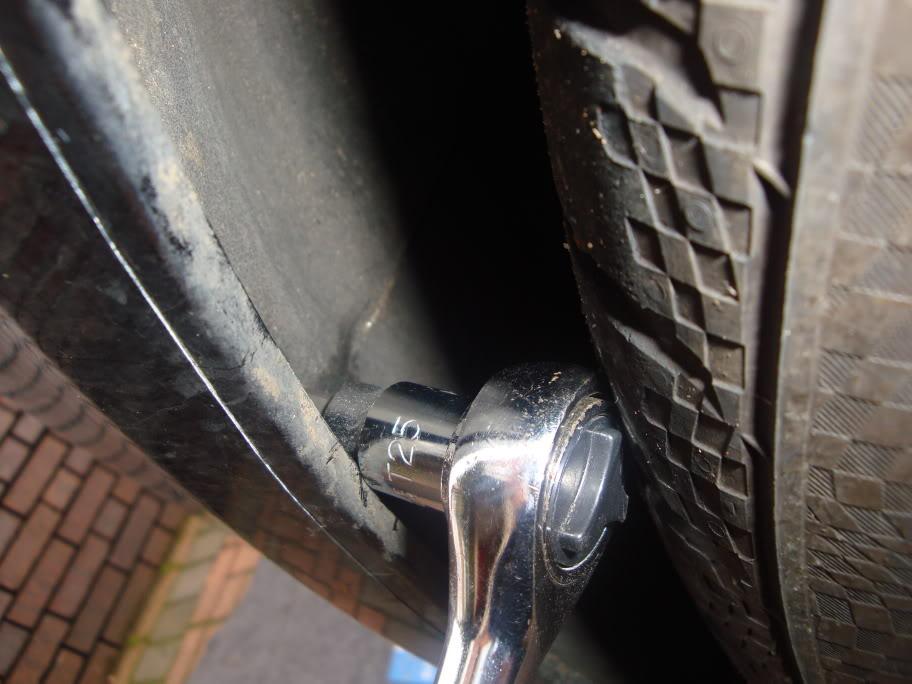

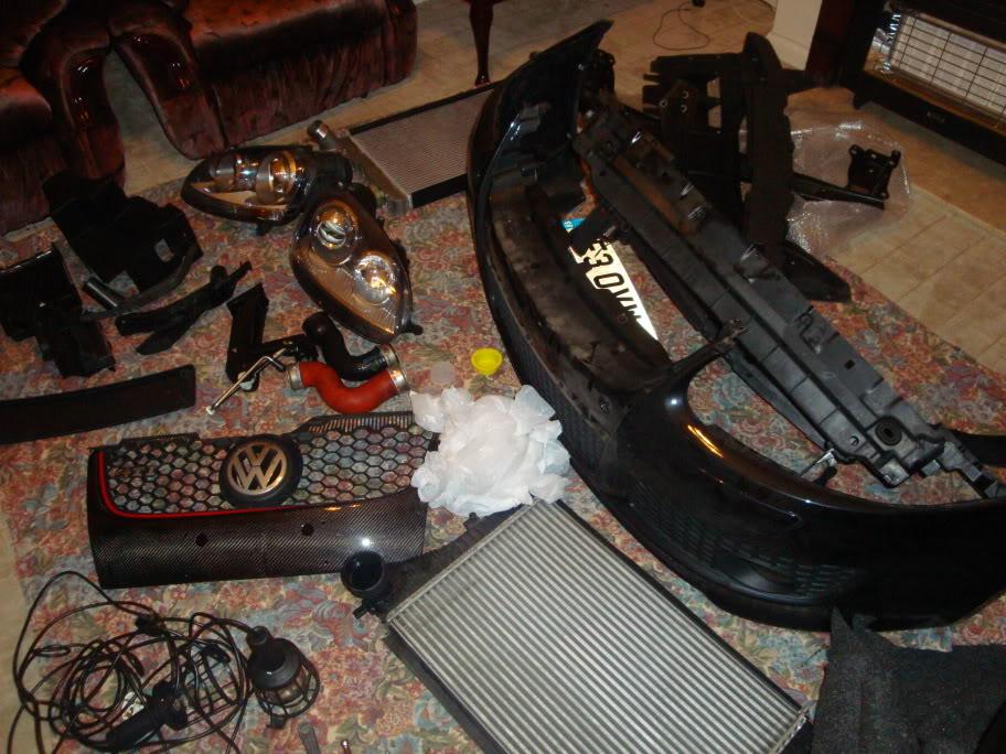

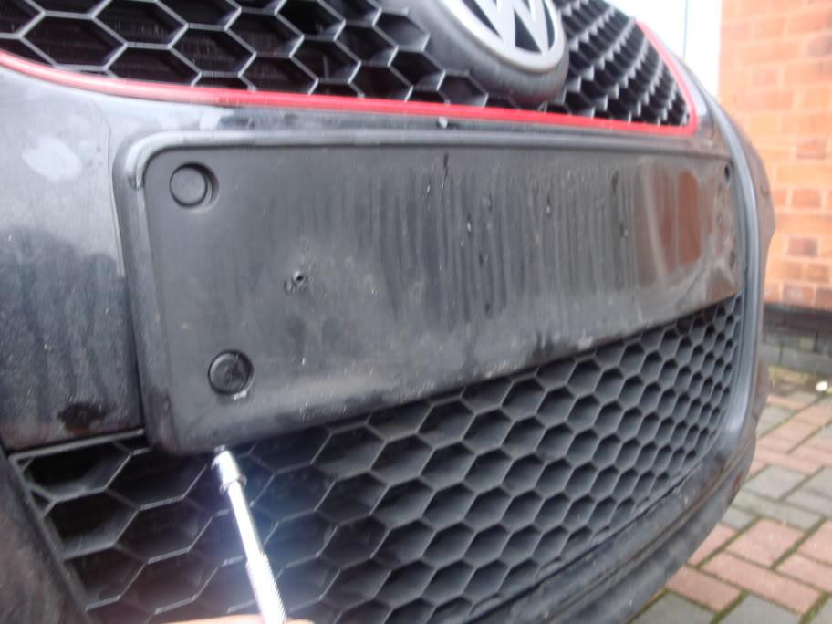

Step 6 – Remove the front grill.  There are 4 T25 screws at the top and 2 screws at the bottom.  My bottom screws took a while for me to locate and then it took me a while to find the right screw to undo them as the APR guide is a bit off here – they were just below the plate holder.
Step 7 – Remove the T25 screws connecting the front wheel arch to the bumper – 3 on each side.
Access is awkward if you can be arsed to take the wheels off.

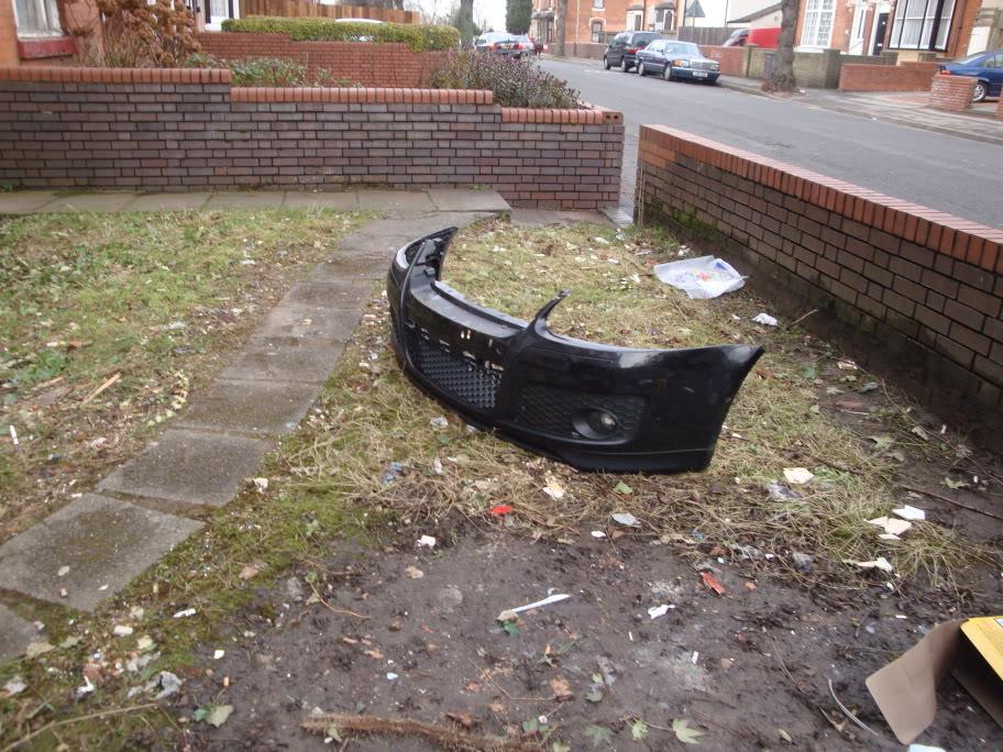

Step 8 – Remove the front bumper by:
1.   Removing the 6 T25 screws under the front spoiler.
2.   Removing assorted T25 and T30 screws holding the lower grill.
3.   Disconnecting the washer pipes to the washer jets.
4.   Disconnecting the foglight connections.

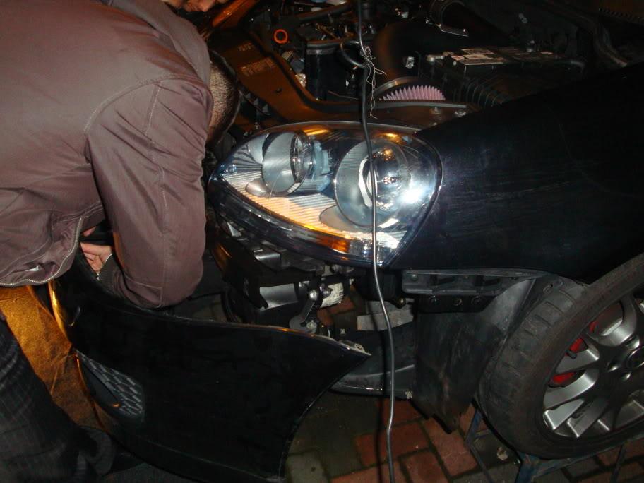

One front bumper removed…

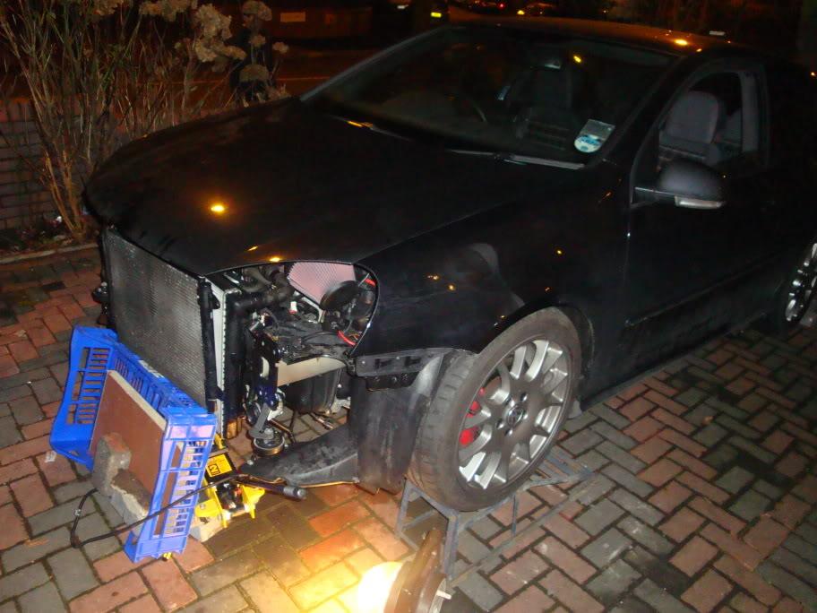

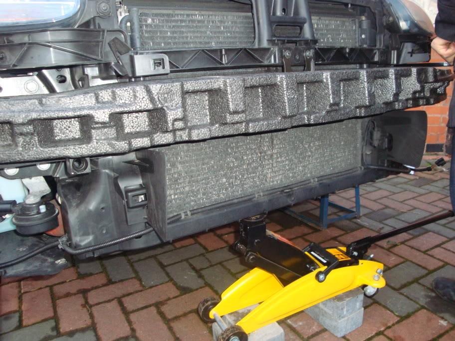

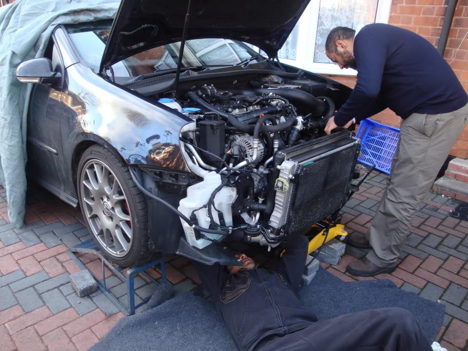

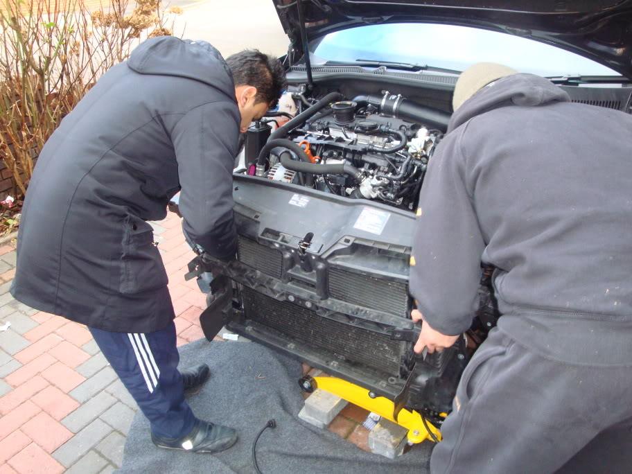

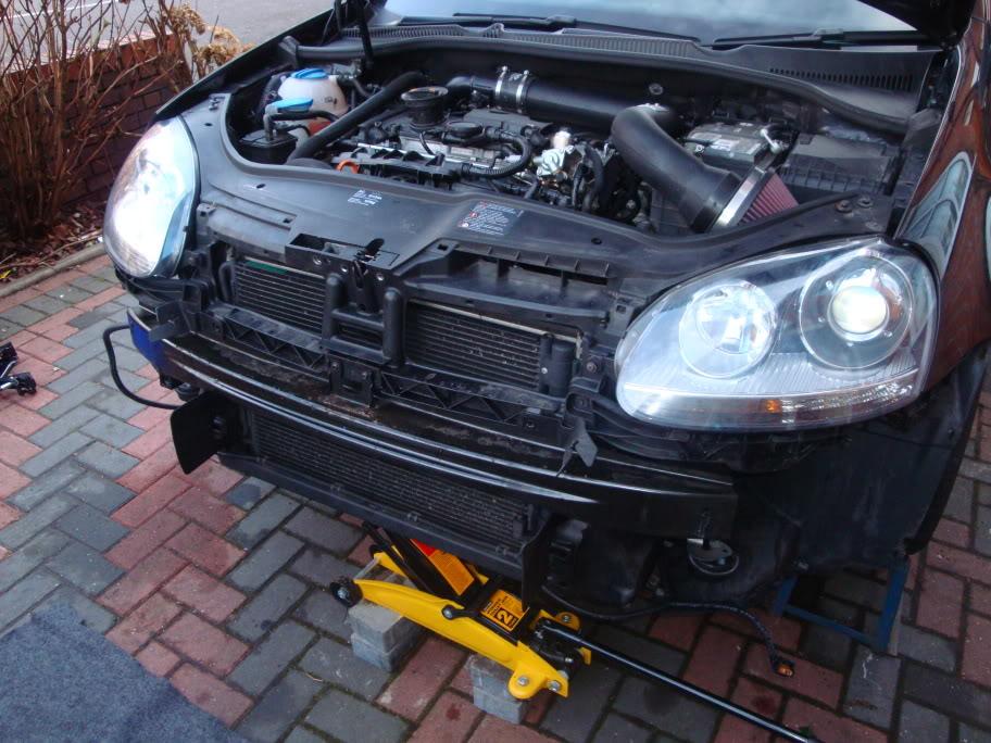

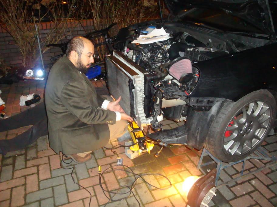

Step 10 – Support the radiator assembly with a jack or bricks and remove the 8 16mm hex bolts as described in step 15 of the APR guide.
The APR guide then tells you to disconnect the A/C pressure, bonnet-latch, radiator fan-wiring harness and airbag sensors.  I couldn’t find them (apart from the rad sensor) on my Ed30 as described in the guide and after an hour of searching, decided to only disconnect what was needed to get the slam panel off.
The APR guide also tells you to pull the radiator, i/c and a/c condenser assembly forward by 4 inches – I didn’t bother and it made things easier later when putting everything back together.

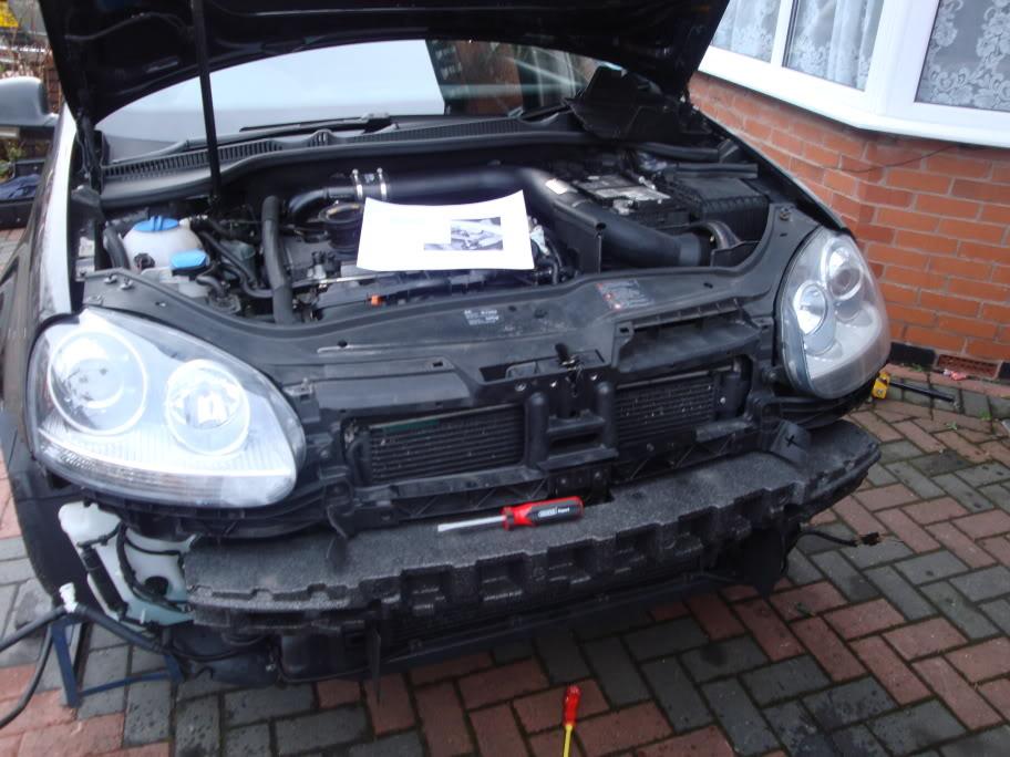

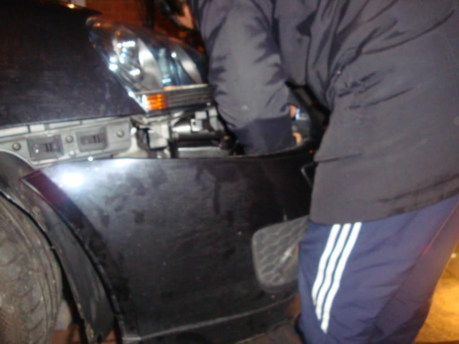

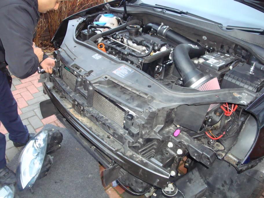

Step 11 – Remove the headlights by unscrewing them and disconnecting any leads to them.
Step 12 – Remove the core support/slam panel.

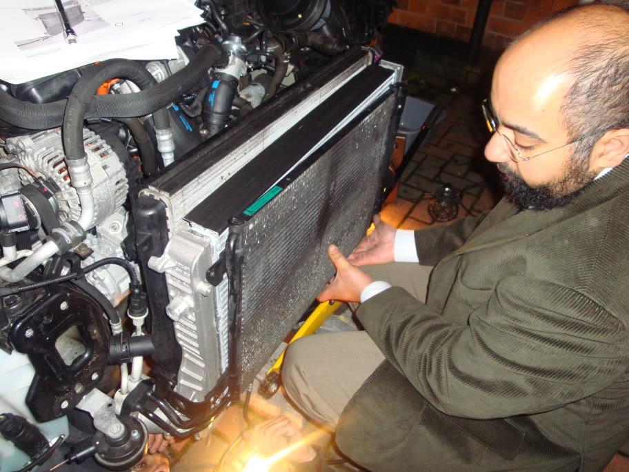

Me supporting the radiator assembly thinking wtf have I done to my car  :scared:

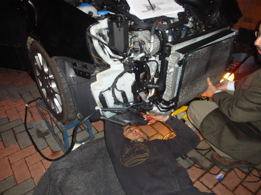

Step 13 – Remove the intercooler pipes on either side.
Step 14 – Remove all the screws connecting the A/C condenser to the intercooler and the intercooler to the radiator and carefully remove the intercooler.  Be very careful not to damage the fragile A/C pipes.
Step 15 – Place the S3 intercooler between the A/C condenser and radiator.  I then attached the S3 pipes to the intercooler before attempting to screw it in place.

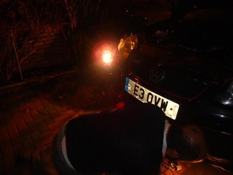

Step 16 – C0CK-UP!  I took the bag of screws for the S3 intercooler I had and realised that they looked exactly the same as the ones for the OEM intercooler.  The problem here is that the S3 intercooler sides are metallic, whereas the OEM ones are plastic.  Still, these were the screws given so I thought they must be the right ones.
As we screwed in the side screw – as recommended by the APR guide – we noticed that the screw really did not seem to want to go in.  A couple more twists and we ended up with 8mm of screw inside the S3 intercooler and a 2mm stump on the outside – the screw had broken off   :sad: :sad: :sad: This is when I thought – damn, I wish it was safe and sound in the bay at JKM and why oh why did I even think about doing something as stupid as an S3 install myself.   :sad: :scared: :scared:
Damage Limitation
We had to remove the S3 intercooler and attempt removal of the broken screw. Try as we might, the stump in the S3 wouldn’t come out.  In the end I we had to chisel the little stump into a rectangular shape and use pliers with great force to try and get it loose.  It worked… eventually after an hour of trying.   :jumpmove:
It was getting darker and colder and I looked up TT’s post on the part numbers for the screws that were meant to go in and I noticed that they should be Hex Bolts FFS!  The job had to wait until the morning when the Audi dealer opened.
Everything had to be put into the front room – not sure if the mother-in-law was impressed!   :fighting: :fighting: :fighting:

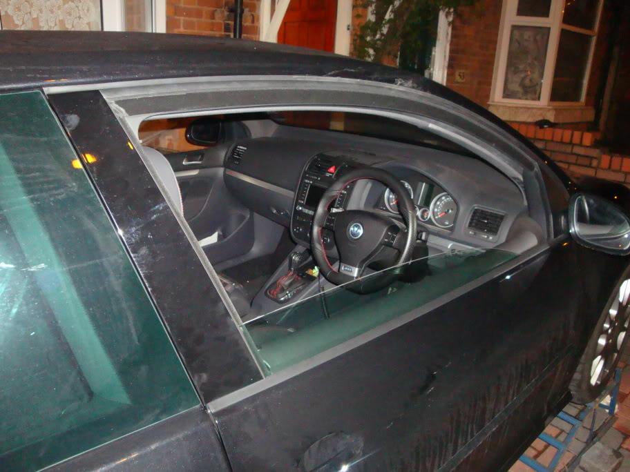

Whats this?  Damn, I forgot to close the windows as I had left them open when listening to instructions getting the car on the ramp.   :ashamed: :ashamed: :ashamed: :ashamed:

Putting the slam panel back on.

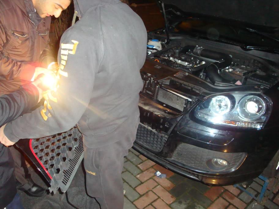

Step 19 – Putting the Xenons back is a bit of a hassle when trying to align them – I had to go to the VW dealer to check out his Mk5s as I had forgotten how they should line up!    :grin: :grin: :grin:
Step 20 – Fitting the lower bumper back on.  Check that the fogs and headlight washers are working at this point.
