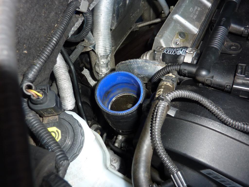

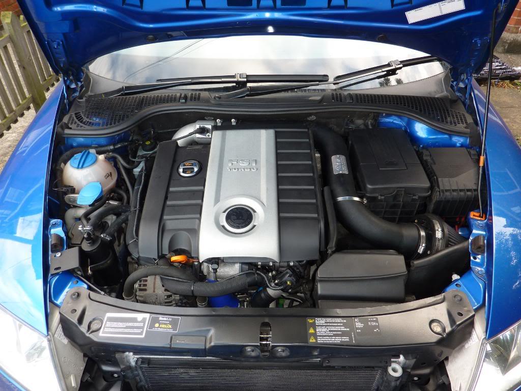

This is where the Relocated DV will sit:

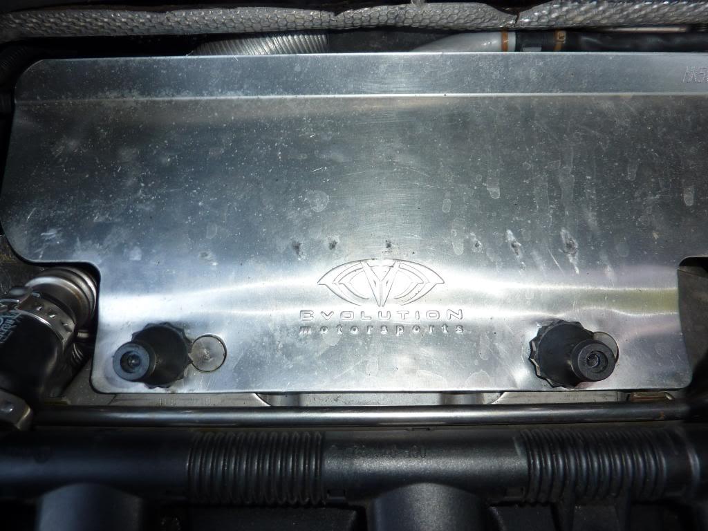

Heat Shield

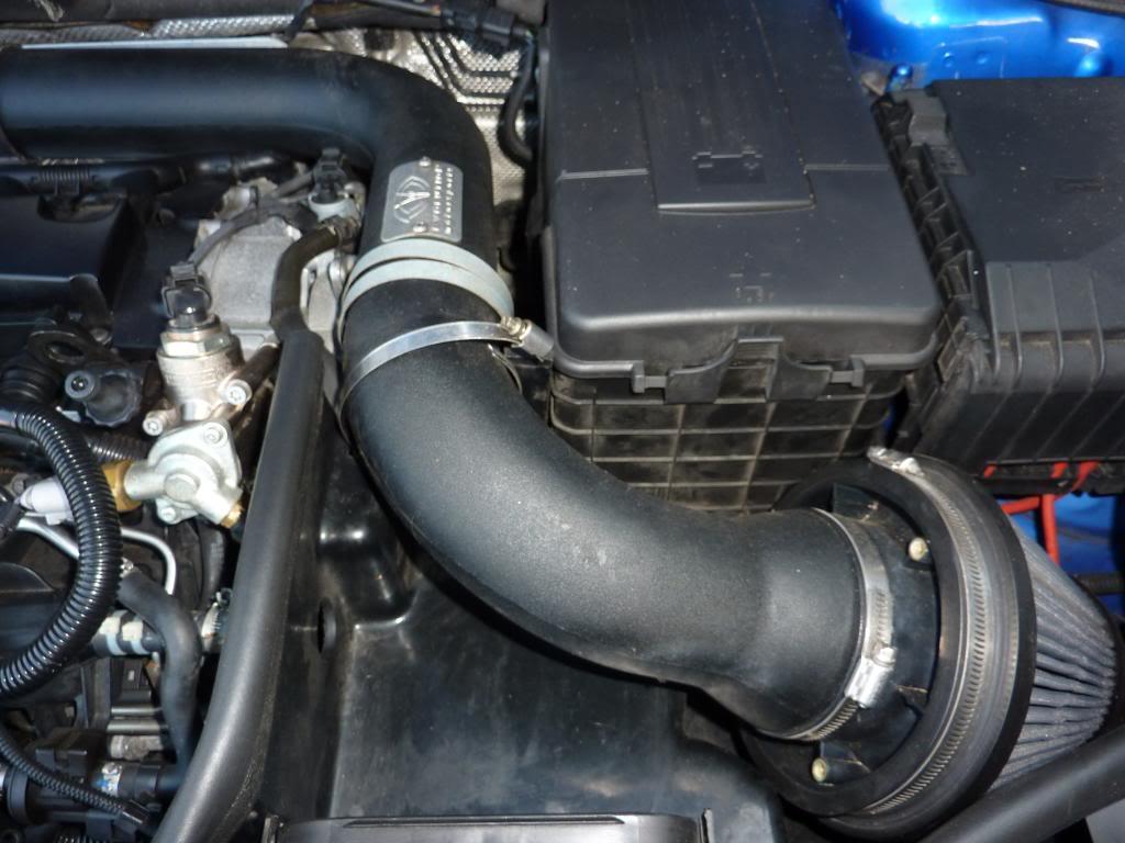

I have not described how to remove the Intake as we all have different ones

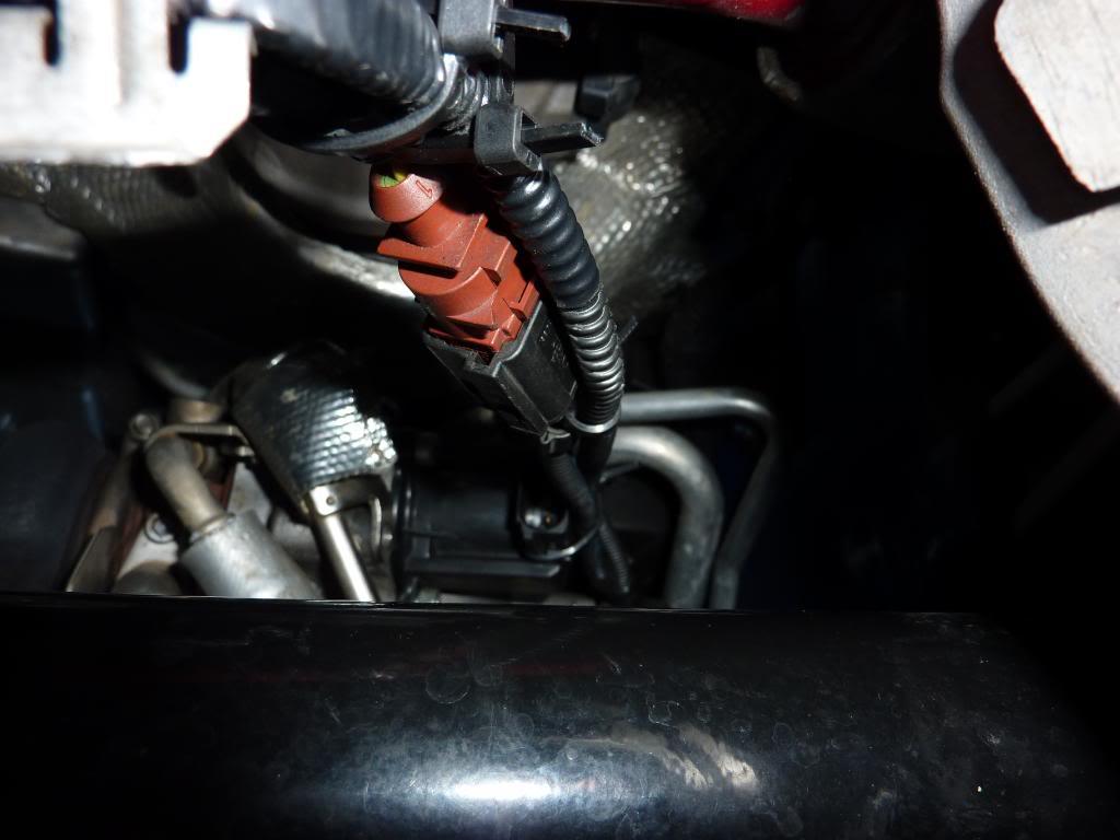

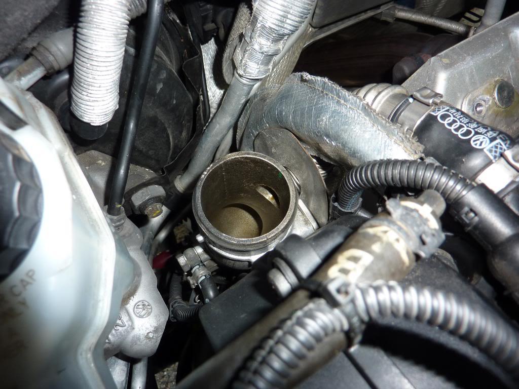

You will now be left with the Top of the Turbo showing like this
Next Unplug the connector from the DV and remove the DV (held in by either 5mm Hex Bolts or T30 Bolts 3 in total)

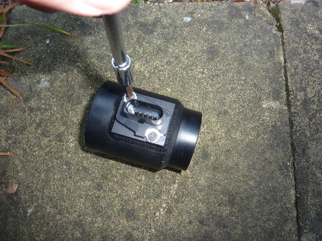

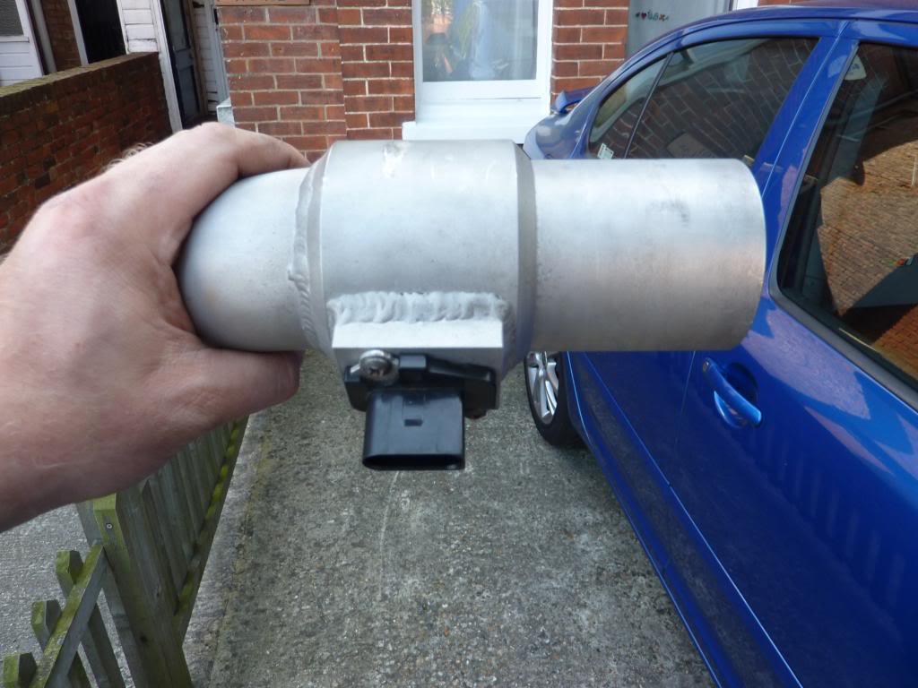

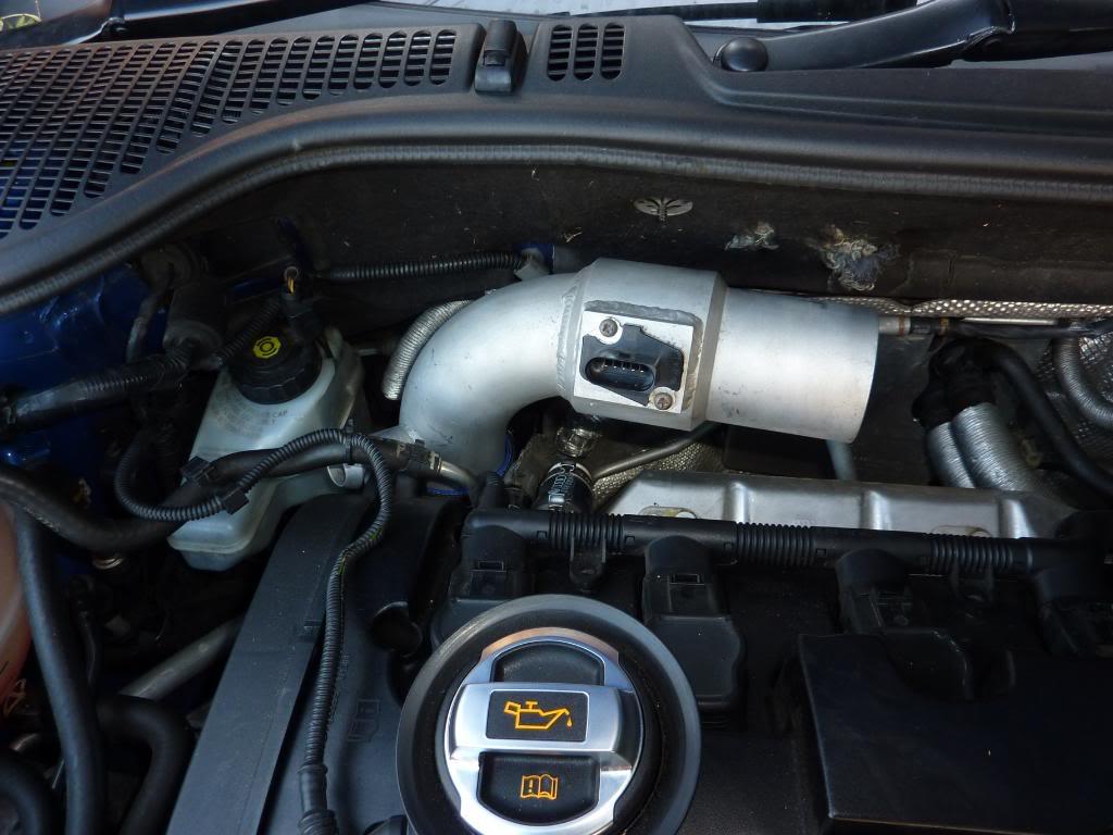

Once you have removed the DV remove the MAF from the Housing

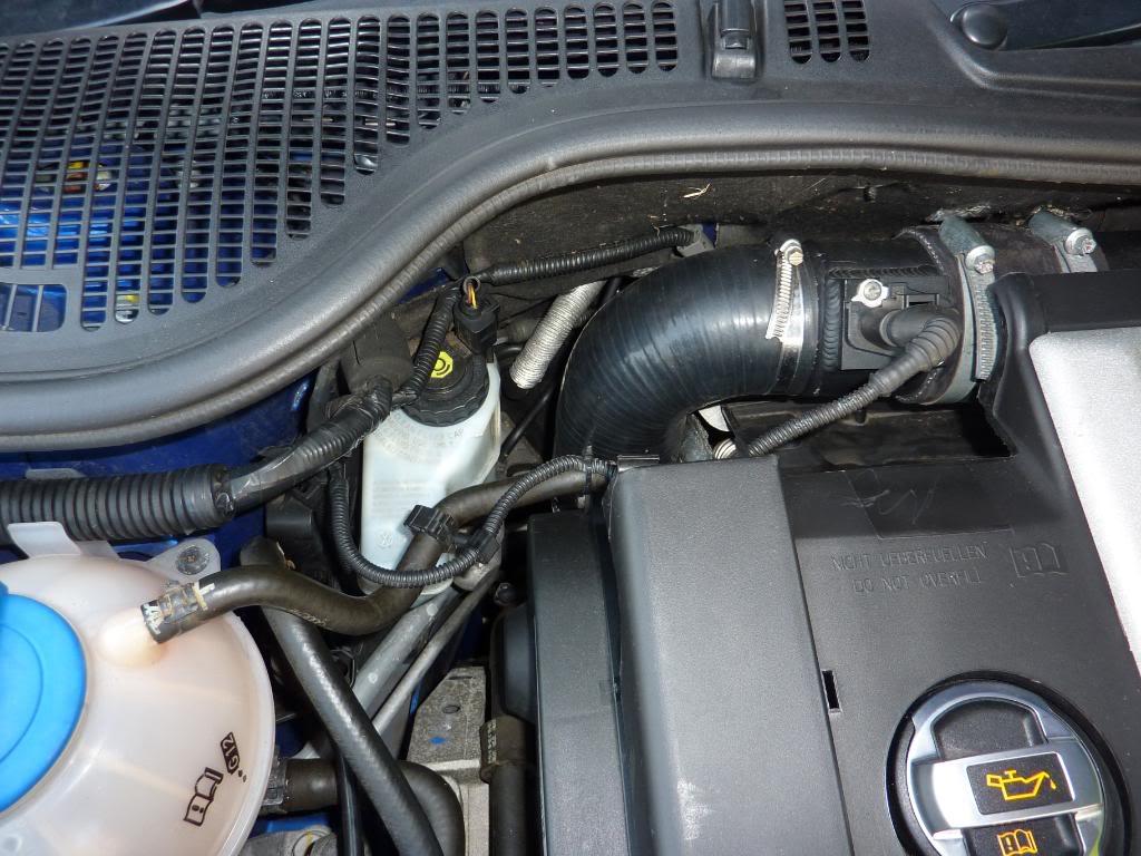

Place MAF into your new Intake Branch Pipe

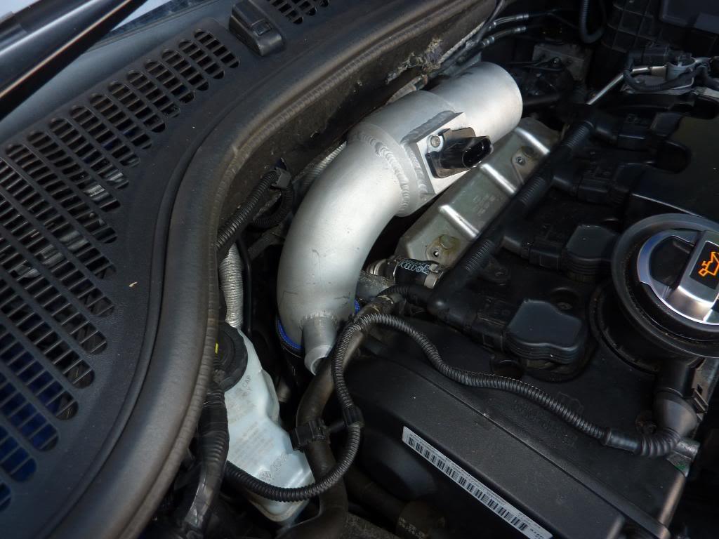

Now connect the Branch pipe to the top of the turbo (again not described in fine detail due to various kits available)

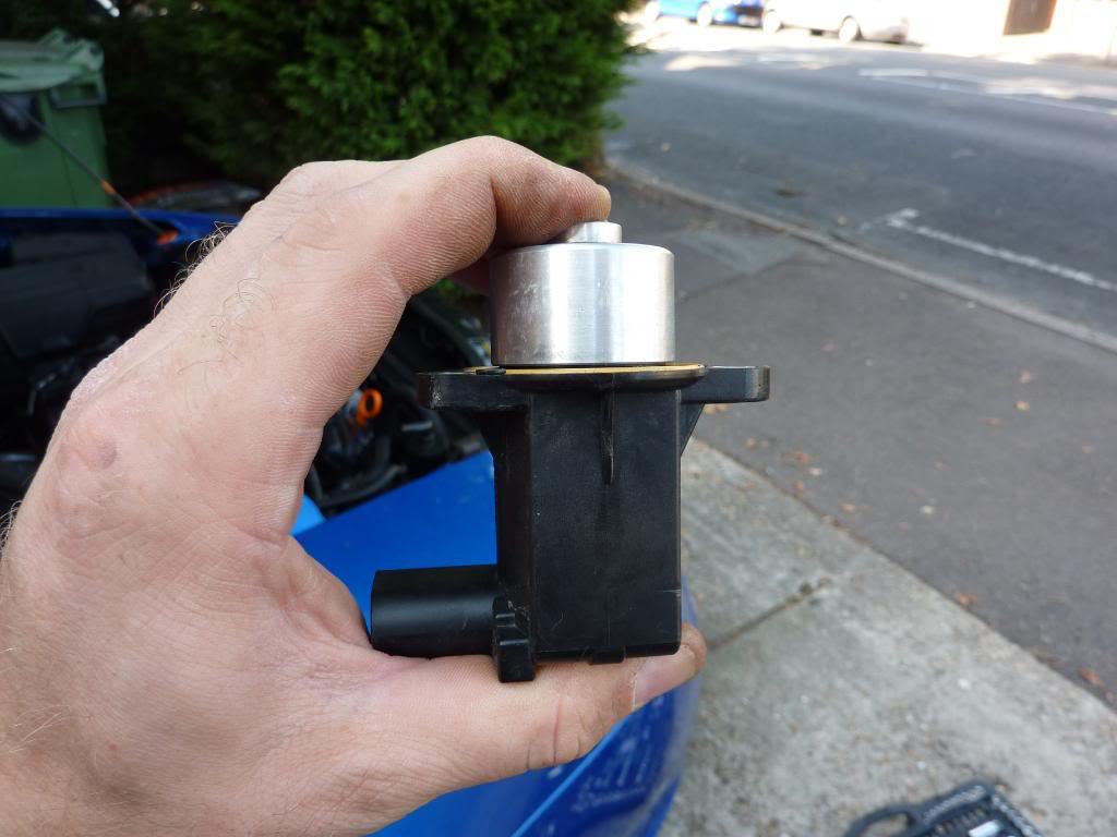

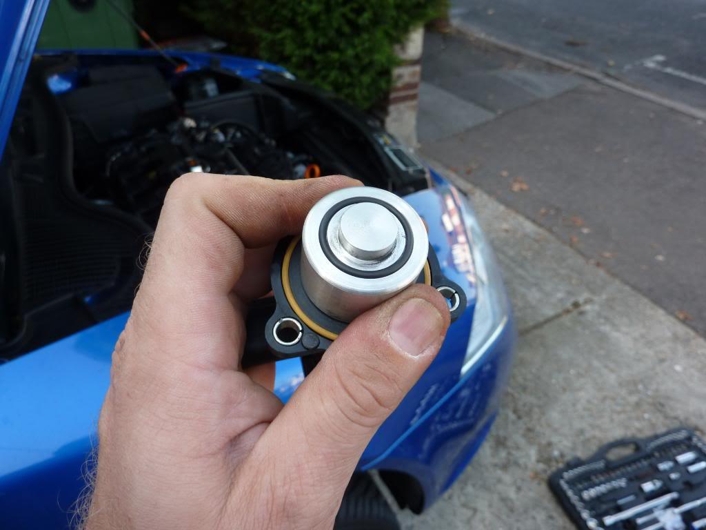

Next take an OEM DV and place the Bung over the end

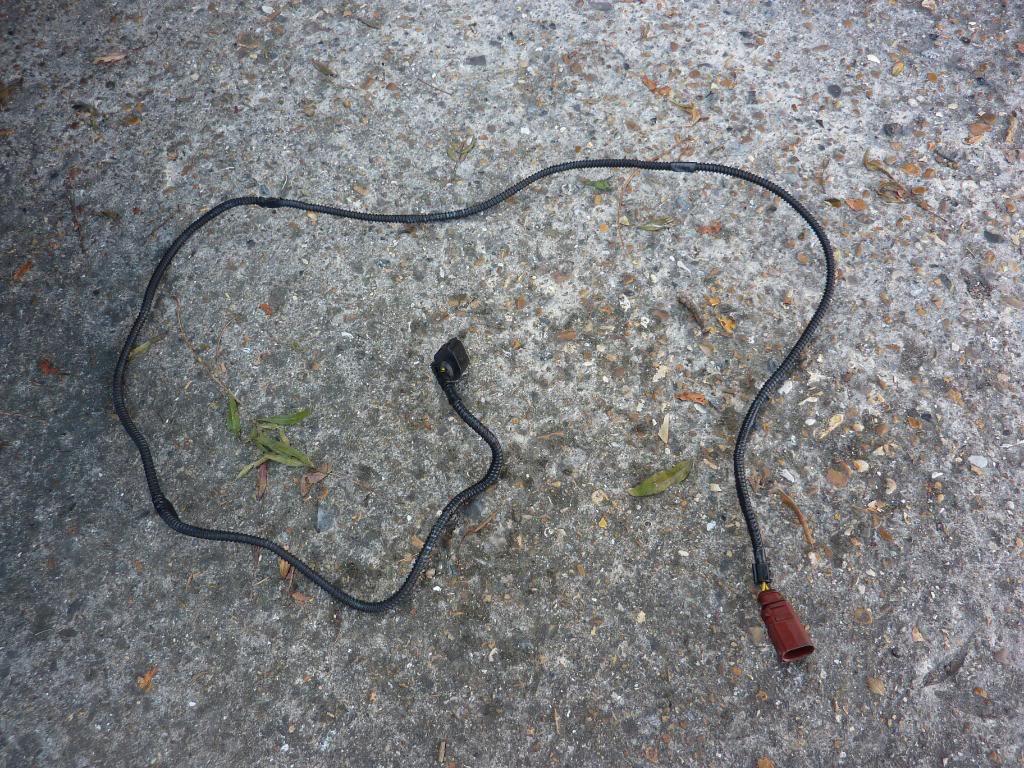

Once done fit this onto the Turbo and tighten up the bolts. You will now need a wiring loom like this to extend the connection.
Feed the wire down from the top of the Engine and plug into the connector that used to plug into the DV

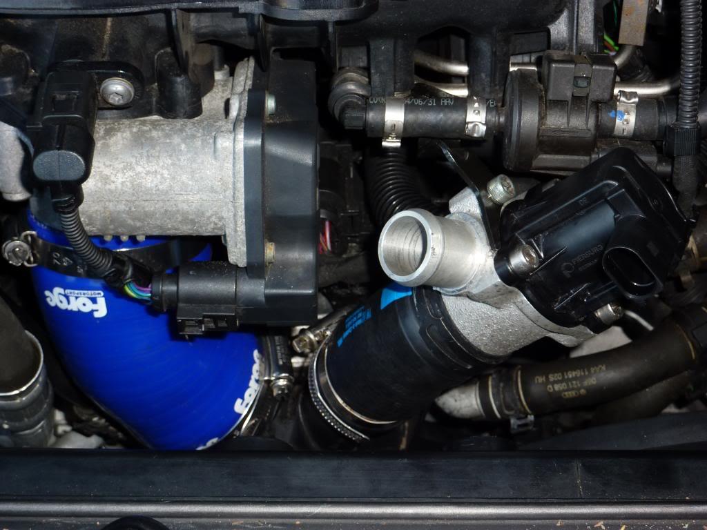

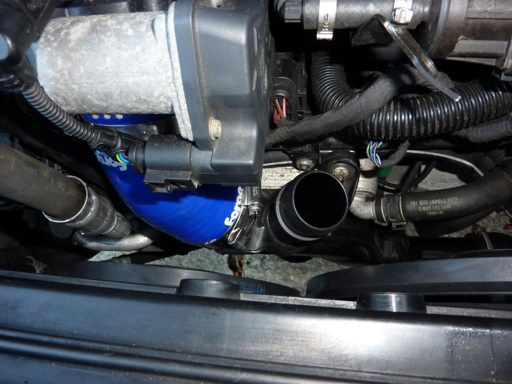

Next take the new DV and attach to the Branch pipe that fits onto the OEM intercooler pipe (do not connect to the OEM pipe just yet the second pic is for illustration)
Then remove the old intercooler pipe and replace with this one
Now connect the DV pipe
You now need to run the Connecting take off pipe from the DV to the Intake branch pipe

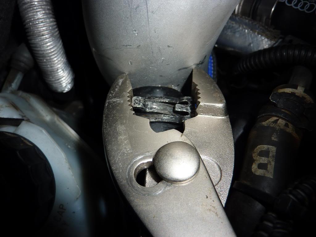

Now using mole grips or VAG Pipe Clamp tool connect the Take off pipe
Once this is done run the Wiring loom to the DV and connect. Then cable tie to keep it neat
Once this is done ensure you have everything connected and have tidied up all the cables etc.

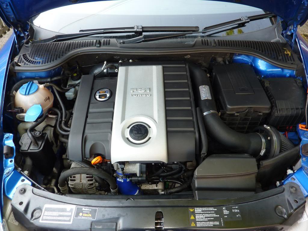

Replace the heat shield and then the rest of the intake and finally the engine cover

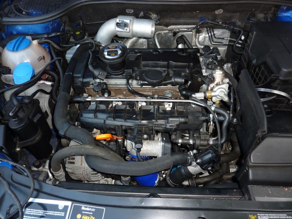

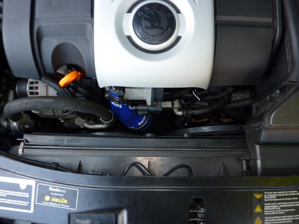

Engine will finally look like this

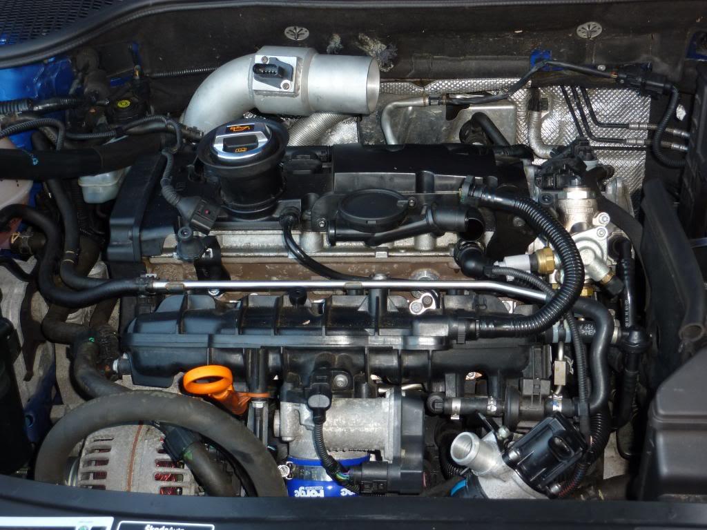

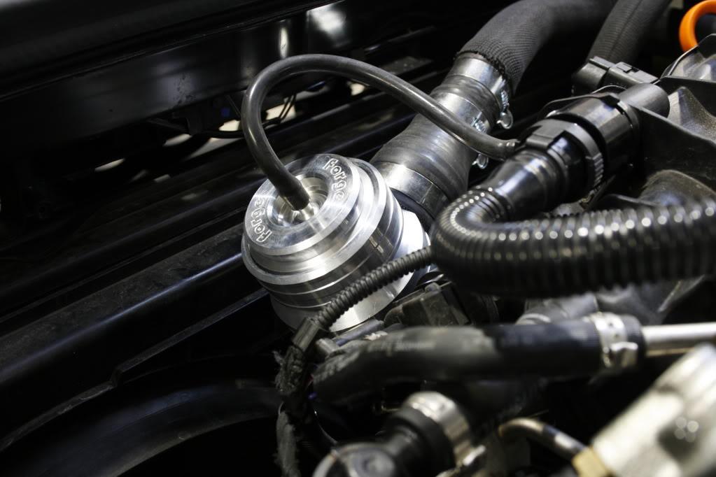

You beat me to it Carl with another good how to:)!  Did this 2 nights ago on my vRS and was about to put a tutorial up.  I used the Forge blank for the turbo.  Saves having another DV.  I didnt do the wiring extension (I was too impatient to order the plugs) so I just pulled the wiring back and moved it to the front.  The reason I did this is I will be going K04 soon and the dump noise through the filter is much better!!!
Parts I used:
Forge Blank:
Bung insert for the 25mm take off:
Finished:
