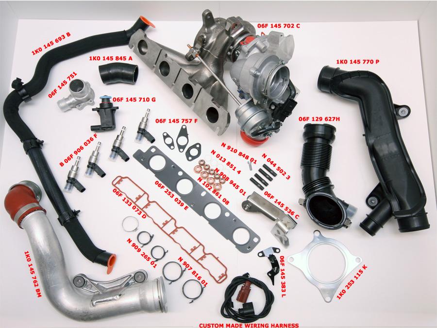

Another fairly big update.
Was losing boost quite substantially in the higher rev range, and peak power was 230bhp  :grin: Big thanks to PDT for spending time on my car narrowing down where the issue could be and er...turning my exhaust round the correct way.
I had a smoke test done, which showed boost pipes were fine.
Took the car to PSI tuning in stoke to have the DP taken off and the turbo inspected for a crack. They have taken the intake off and blanked off the DV in search of a loud screech that comes from the car when on boost. Its pointing to the turbo, it could be something as cheap as a gasket or as expensive as the turbo internals, but didnt want to say 100% unless the turbo is off the car.
I have decided to go K04 rather than spending cash taking a turbo off and replacing it with the same thing. PSI has made me an offer i cant refuse regarding going to APR software + Fitting turbo. Two benefits i can see are that it doesn't disappear when disconnecting the battery and i can once again return to Awesome GTI for any map changes.
I never really planned to go K04 when i got the car and has been a hard decision to make as to if its going to be worth it, but with 310-330bhp its means i have a much bigger willy to wave now.
PSI tuning offer APR and CC remaps, APR don't do a DSG map and from what i have read i wouldn't touch a CC map. So i will be hopefully taking the car to Nick @ R tech for his DSG map.
These are the bits im going to purchase:
079 130 757 - RS4 Pressure release valve.
06F 145 751 - S3 Intermediate flange
1K0 145 845 A - pressure hose
1K0 145 693 B - S3 Air Circulation Pipe
06F 145 757 F - gasket for oil pan?
1K0 145 762 BM - pressure pipe
06F 133 073 D - Intake Manifold Gasket
06F 253 039 E - Exhaust Manifold Gasket
N 908 945 01 - 5 x  hex. nut, self-locking - exhaust stud nuts
N 102 861 08 - 4 x shouldered hex. nut, self-locking
N 013 851 4 - 4 x sealing washer These are the copper sealing washers for the oil and coolant lines.
N 910 848 01 - 4 x mounting bolts for the DV into the stock S3 flange
06F 145 383 L - DV Mounting Bracket
1K0 253 115 K - Downpipe gasket
N 044 502 3 - 4 x Downpipe studs
1K0 145 770 P - S3 Air Pipe
